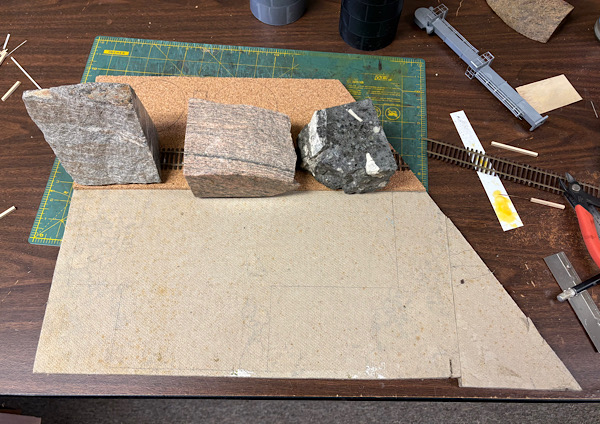

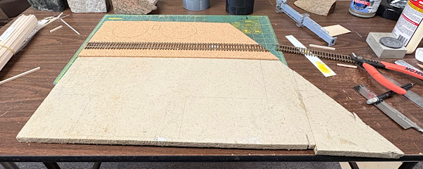

Meanwhile, I took a rectangular base from an old project, turned it over, made sure it was withing the size allowed, and did some cutting to create a trapezoid.  The odd shape is because of of where it will be joined to my layout.
The lower right corner is still wet.
Over the next few days I will be alternating between adding the roofing and doing scenery.

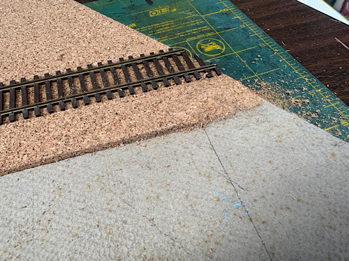

In the photo you can see where I glued down a sheet of 1/8"cork to provide a little relief. The metamorphic rock bookends guarantee the cork edge is flat.  The result with a section of code 70 track:

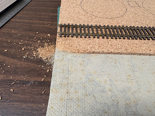

I shaved the cork down to  make a smooth transition:
I ballasted the track after covering much of the area with actual dirt.  I then added electrostatic grass in a fall color, some Woodland Scenics "Burnt Grass" and a little shrubbery:

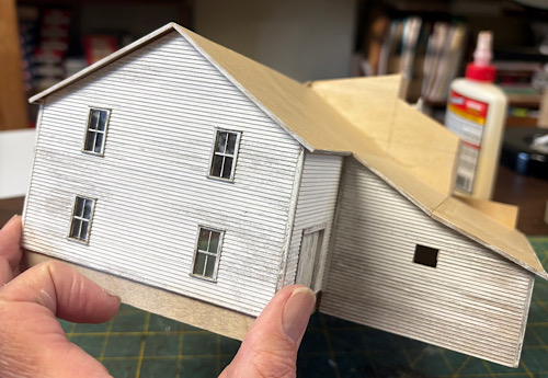

Meanwhile, I've been adding styrene roofing after painting with a slightly off-white spray paint.
First, some flashing:
Many roof panels have been installed.
