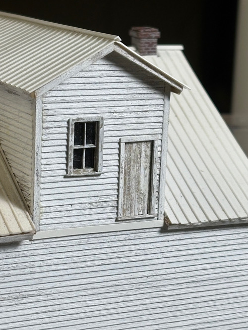

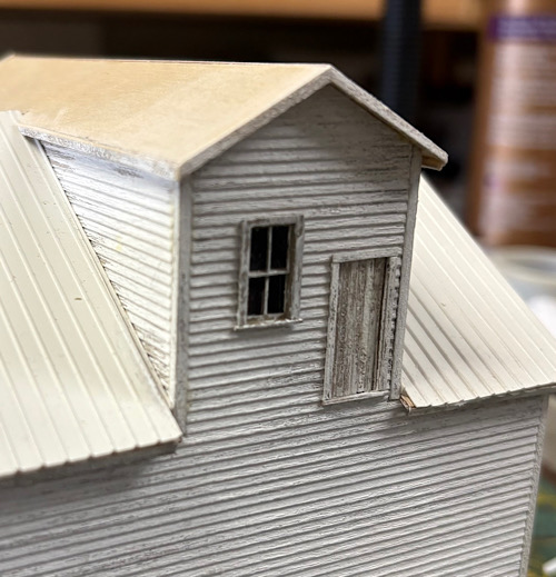

Let me talk about roofs.  In previous posts, I believe I've shown the extent of braching I use on the walls.  The same goes for the roofs.  I usually have heavy bracing between the end gables near the peak and near the walls. I don't rely on the thin sheetwood walls to provide good glue surfaces.  To the bracing and walls I glue the thin plywood subroof. Trim is added to the edges after it is stained and painted:
I measure the area of each section of roof, paint the faux metal roofing, and glue it down:

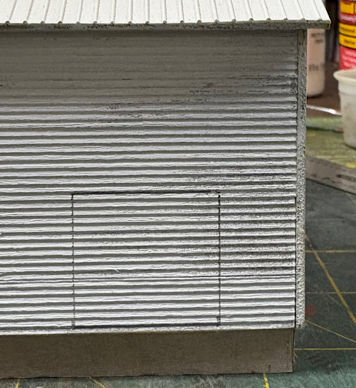

This structure is to provide a switching location for covered grain hoppers on my layout.  It occurred to me that I could also spot boxcars on the same track if there were a door on the track side of the mill.  A little late for that realization, but I decided to forge ahead.  I drew the door outline:

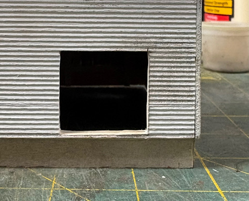

cut the opening:

Cutting the opening required many passes with the Xacto knife while holding the building on my legs, knees apart, opposite-side down.  I was very grateful for my habit of robust construction.

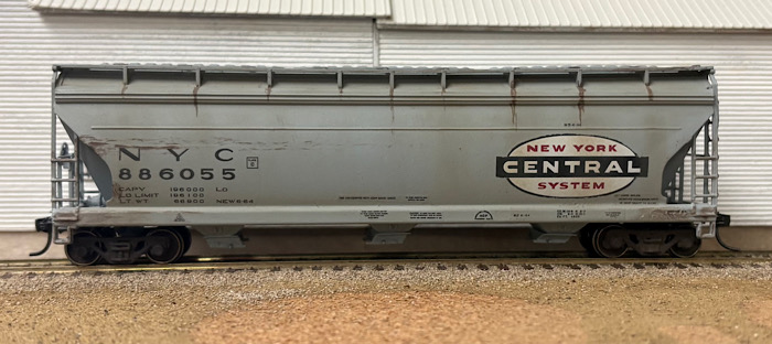

I took a break from the structure by completing work on the covered hopper.  I paint the trucks with a dark brown acrylic paint comprising a mix of burnt umber and black.  I do the frames and the wheels with the same mix.  Once dry, I brush on a dark gray-brown powder to cut the shine and look aged:
The body was weathered with the same acrylic muck to make the the rust steaks on the sides, followed by a general dusting of the same mixture of brown and gray powders used on the trucks:
Notice the horizontal rust streaks where the car side-swiped some object.

Something I now try to do with gable roofs is to use the gable end walls BEFORE they're assembled to draw and cut pieces of wood/styrene for triangular roof braces.  A pair of those glued to the subroof panels makes for a very strong roof that can be removed.  If I forget, I still use the gable wall ends to trace the triangle onto wood/styrene and cut that out.
And a trick for cutting a door in an existing building:  I cut a piece of 1x4 to a bit less than the interior opening, then clamped that to the workbench so it sticks out.  I put the assembled building so the wall to be cut was over that 1x4, and cut the opening through the wall into that 1x4 as the support for the wall.

I didn't plan to make any roofs removable, especially with the interior almost invisible with the few windows and solid doors.  However, I used all those triangular scraps of sheetwood that you get when cutting out gables to provide additional bracing to some of the walls. Other pieces I used as jigs in my chopper to cut bracing at appropriate angles.  I have remarkably few scraps left over.
