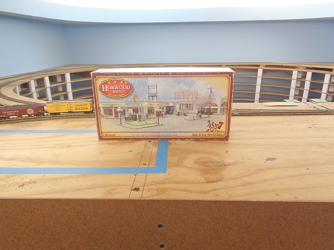

I started to read the instruction manual two months ago. I've read through it a few times and getting familiar with the parts.
This kit, when placed on the diorama measures 15 X 24". I'll use the same dimensions but the kit will sit directly on the layout. I'll construct a concrete pad later in the build.
Here is where I plan to plant Harwood Bros. It is on the Summit Level (3rd.) of the layout.
