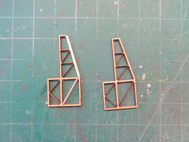

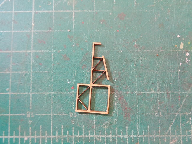

Thanks very much. The repair was a bit tricksie as shown below, but it did get fixed.

Well, I made the one repair and then realized I glued the new brace at the wrong angle.
Repair on the left.
When attempting to remove the repaired brace, the outside brace broke. Dang it.
Repair made on this as well.

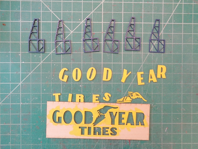

The six billboard braces were painted with the dark blue. The letters were removed from the carrier as shown.
When gluing the letters to the billboard, I'll use the Good Year carrier sheet as a template.

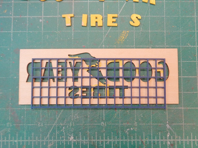

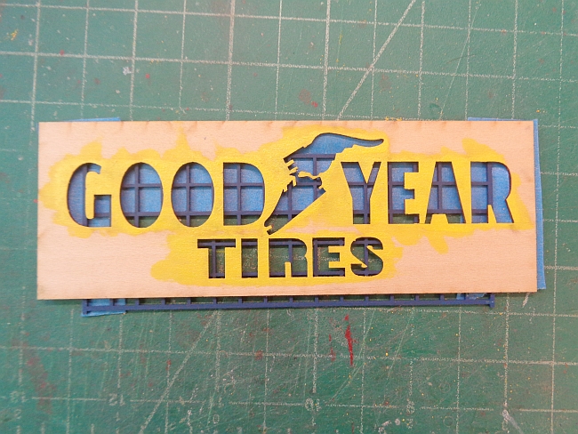

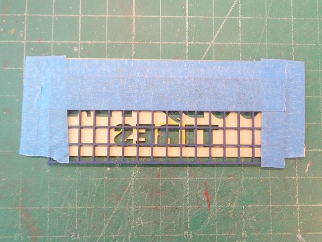

I centered the carrier sheet over the billboard grid.
I used painters tape to hold the two pieces together.
The excess tape were removed using a # 11 blade.

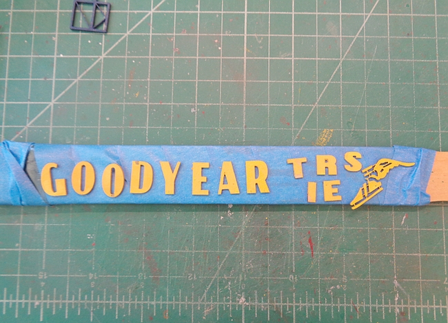

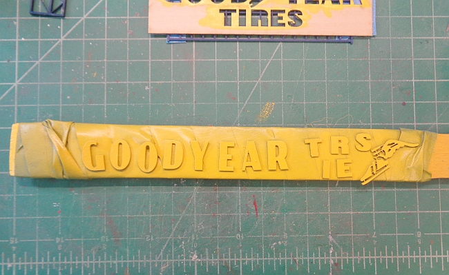

I reversed wrapped painter's tape to a wood stir stick. The yellow letters were stuck to the tape.
I then sprayed the letters with a light coat of yellow.
Not shown, but when dry, I flipped the letters over and sprayed the backs. I made sure to cover the edges of the letters as well. When dry, I sprayed a flat finish on the letters to seal them.
