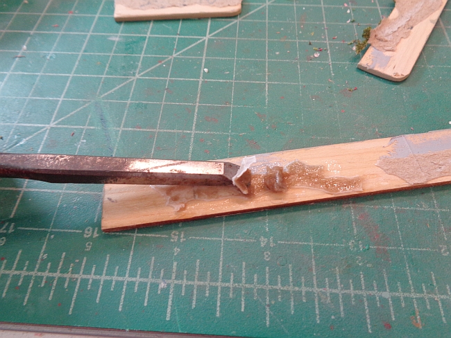

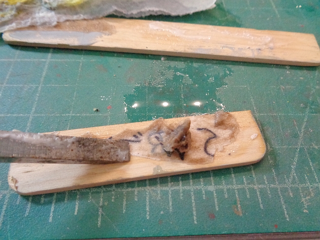

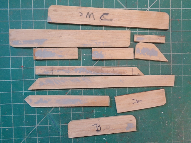

I saved the sidewalks but still needed to clean them from the cardboard and glue on the bottom.

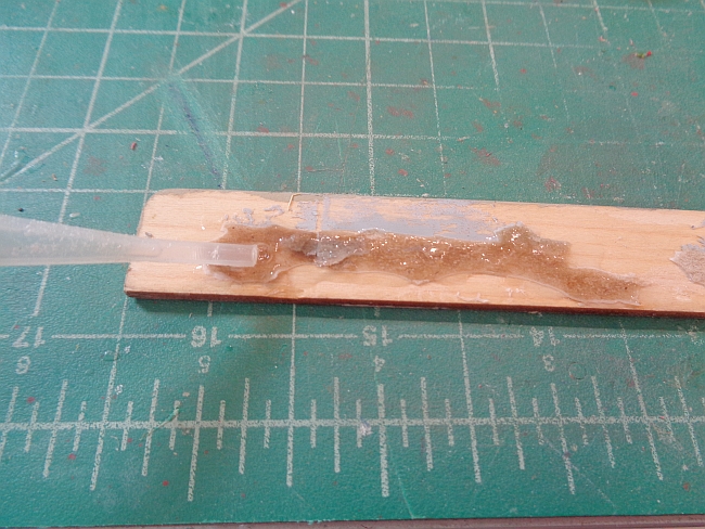

I used warm water and a pipette to apply the water to the glued area.
I let the warm water sit for about 15-20 minutes.

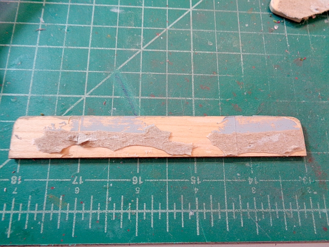

Once the warm water softened the cardboard and glue, I used a wood chisel to remove the glue/cardboard.
On a few pieces I had to repeat the process. On one piece I repeated it three times, but it all came off.
I let the sidewalks dry for a day and then used a large sanding stick to smooth the bottom of any small bumps.
Now it's time to redo the area.
