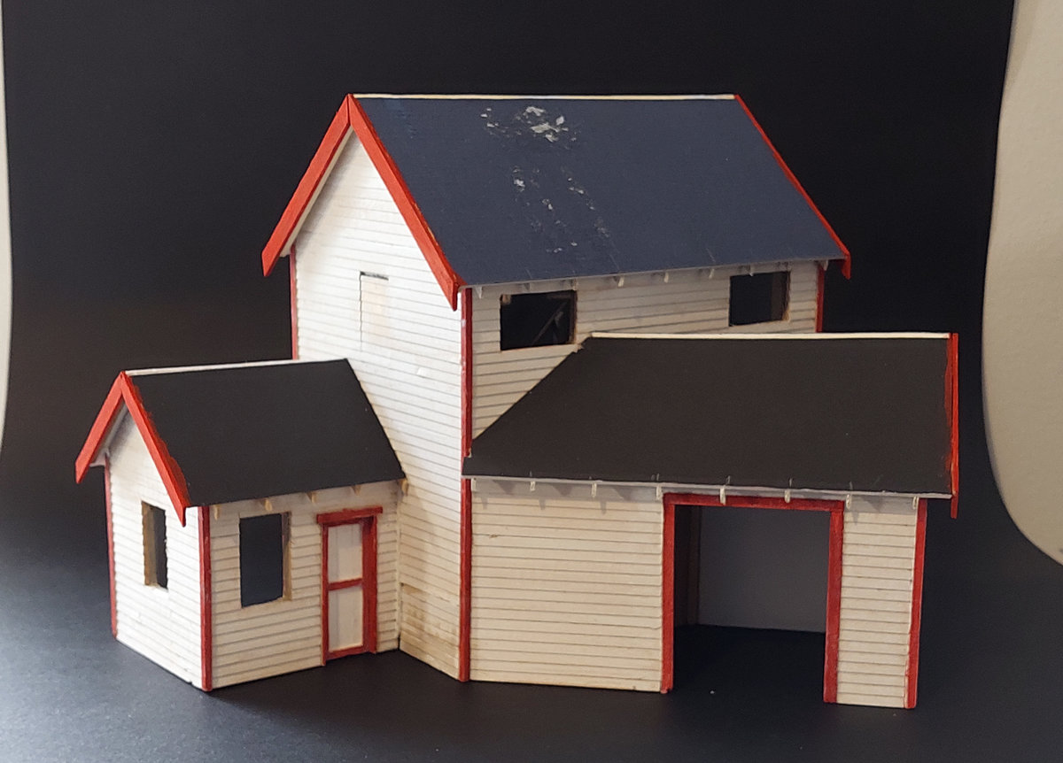

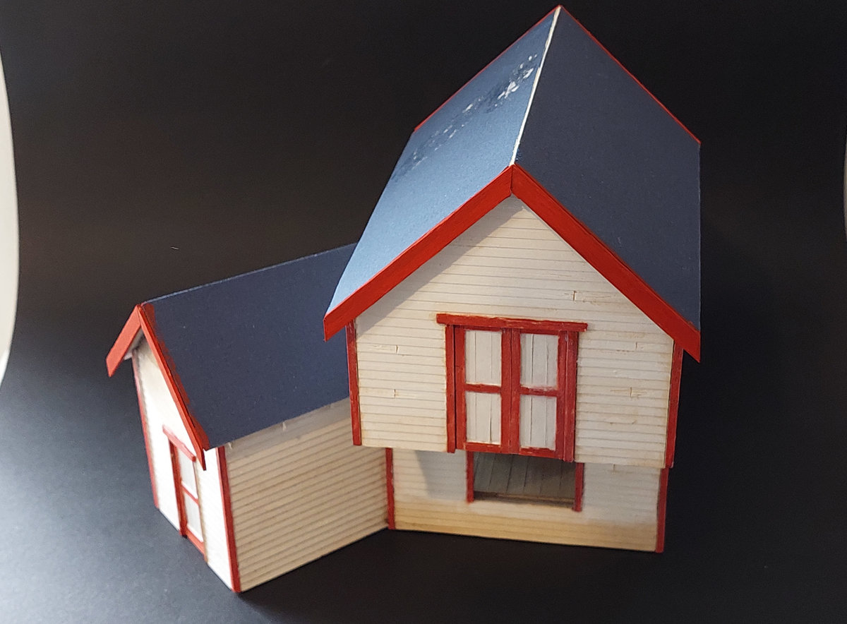

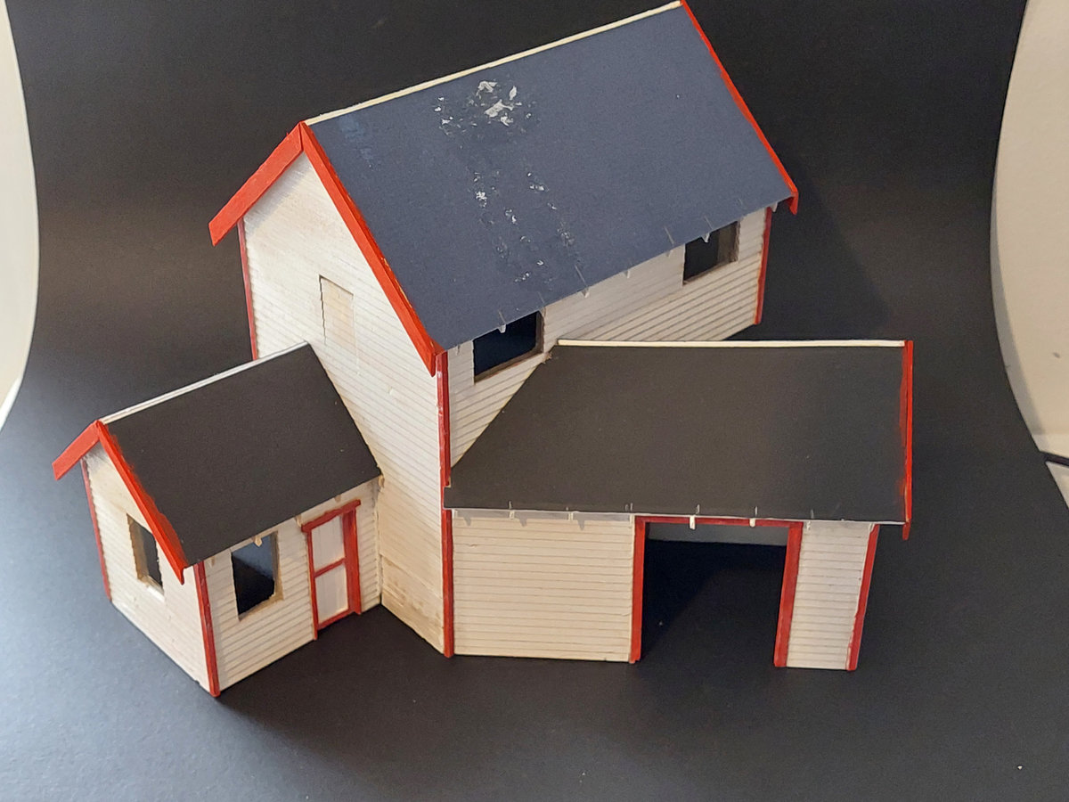

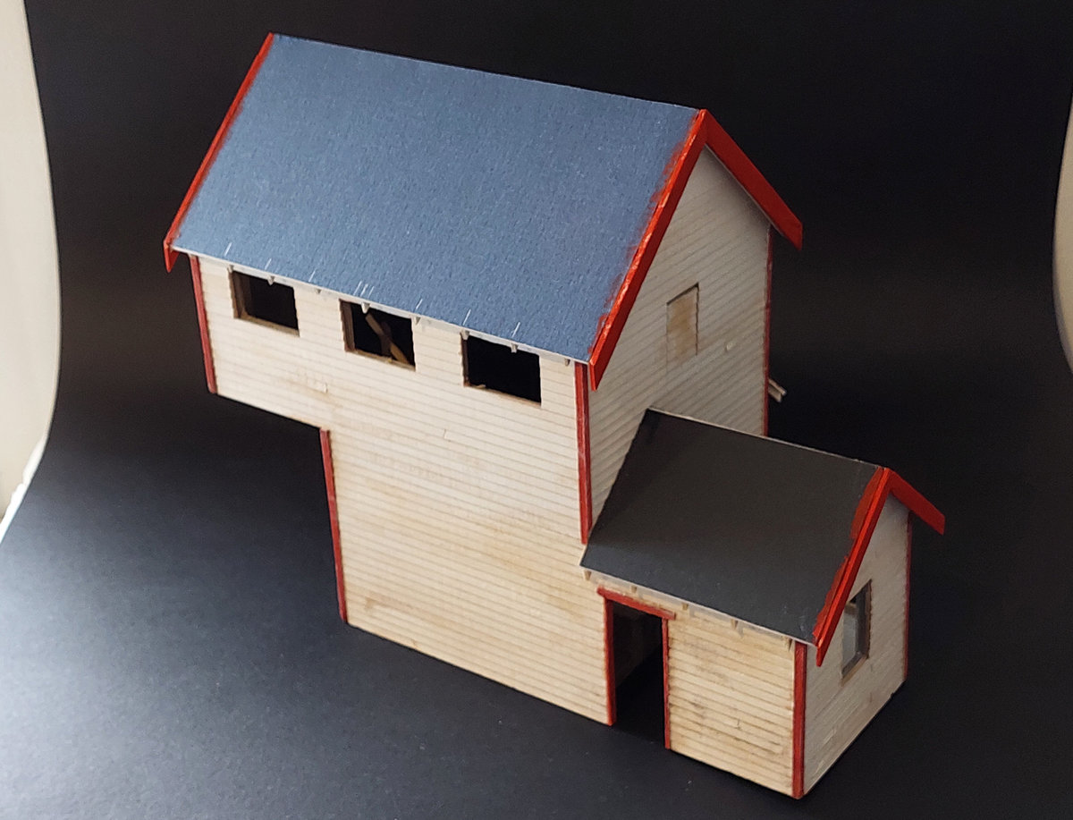

robert goslin
Next up I added in the upper story floor, made from cardboard.  But I didn't take any photos of this.
Also painted the walls of the side extension.
So now I could close up the building by adding a sub roof to each section.  Used picture framing card for this as I was given a lot of it from a mate of mine.
Also added the rafter tails and the gable end trim, made from stir sticks.
better view of the rafter tails.
Regards  Rob
