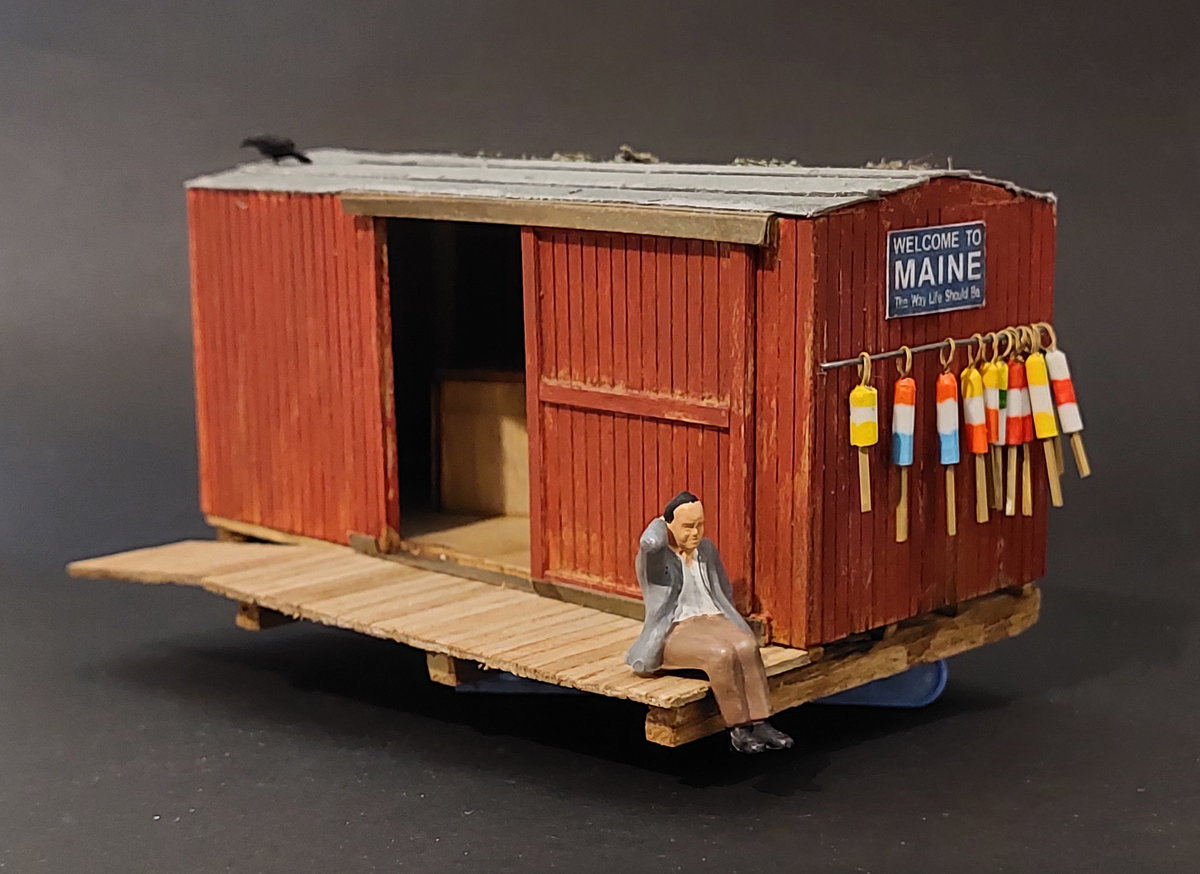

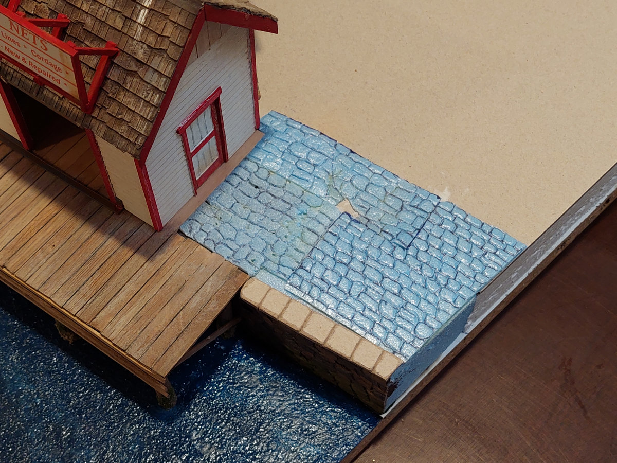

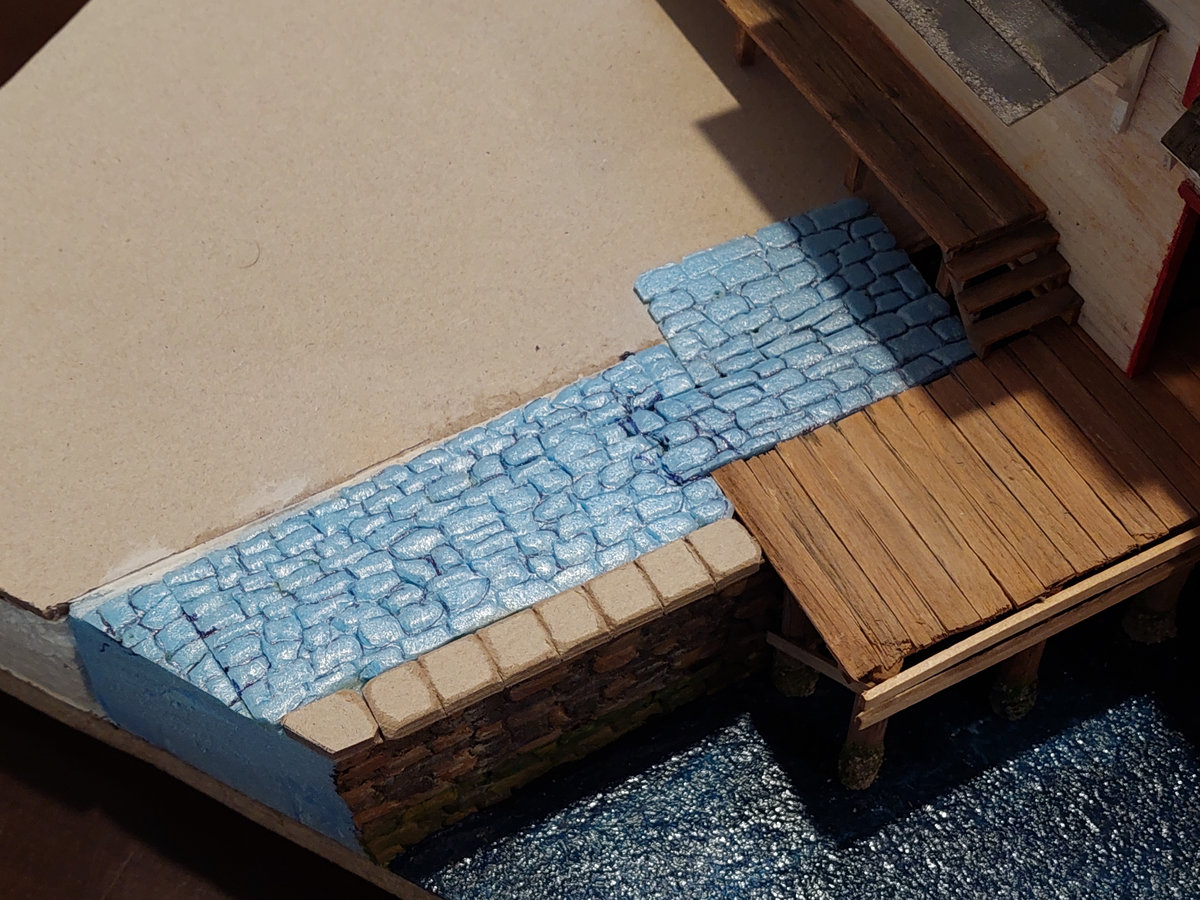

I decided I wanted some cobblestone paving around the wharf area, so I sliced some blue foam about 1.5mm thick, and carved in the cobbles.

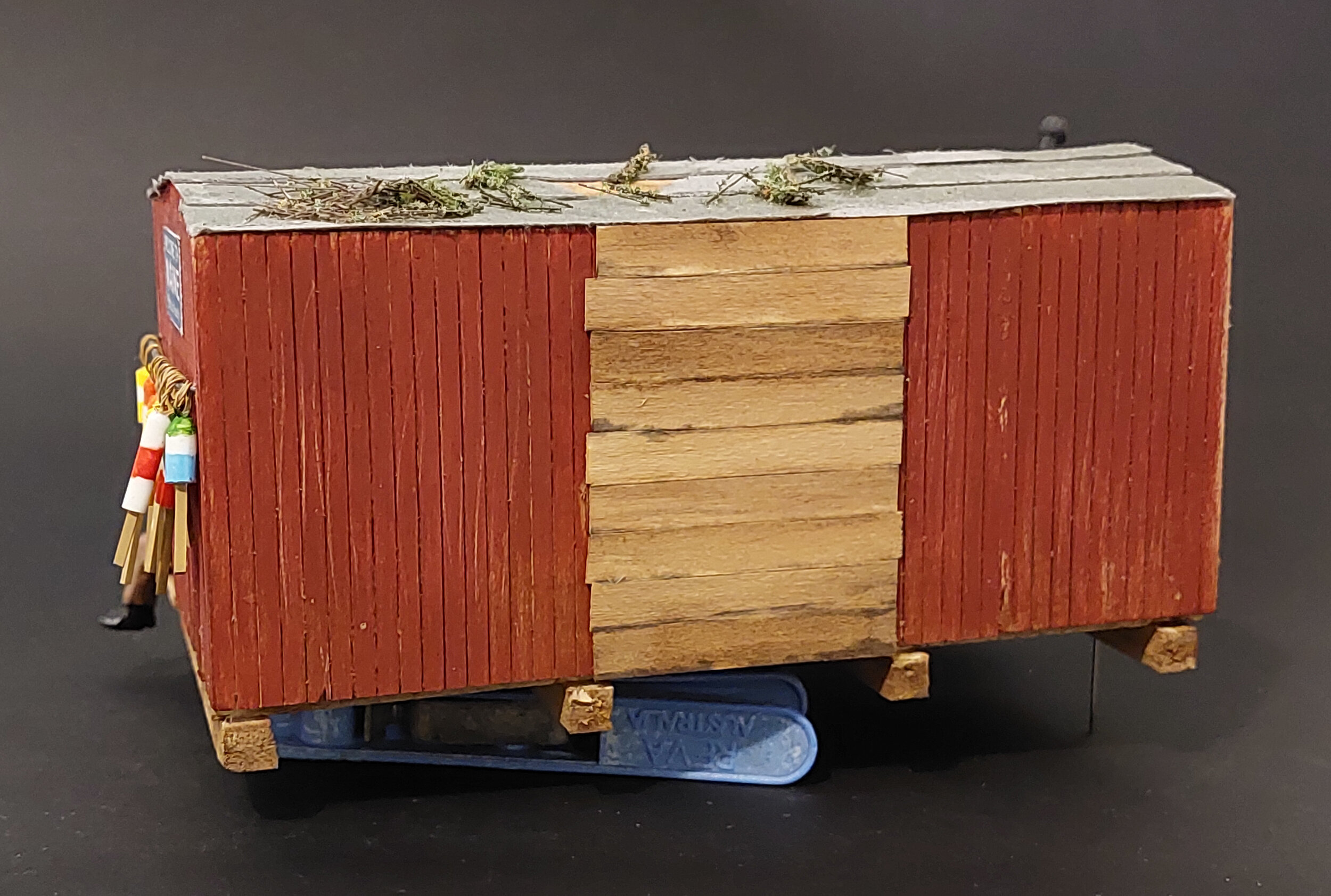

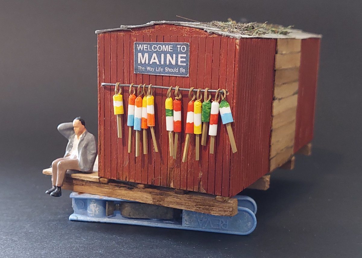

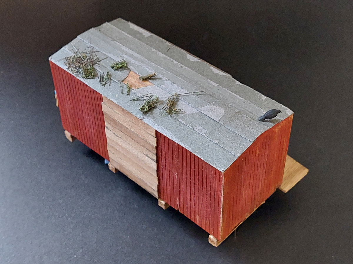

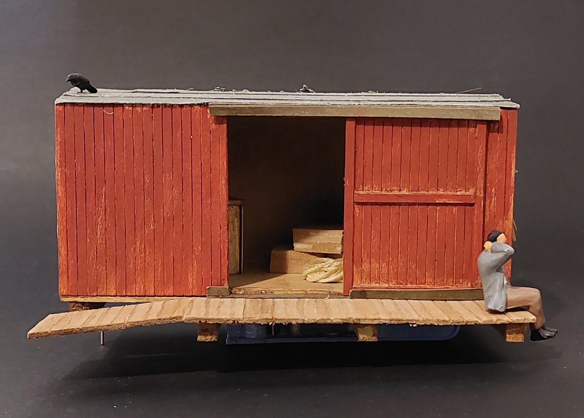

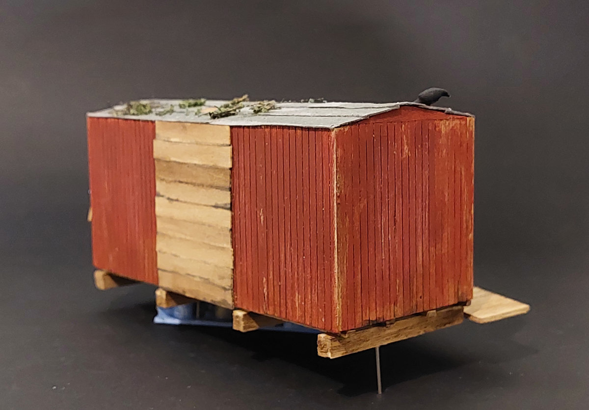

I also decided I wanted something railroad related on the diorama, so scratchbuilt an old 2nd hand narrow gauge boxcar that the owner had got for free from the railroad, to be used as a storage shed.
It still has the sliding door on one side, but the other side the door was missing and the hardware removed so Nemo just boarded up that side.  So gives it a bit of character & a backstory.
Also added a loading platform to the door side.
Regards  Rob
Melbourne,  Australia
elwoodblues
Hey Rob,
Just caught up on your build (had a lot of catching up to do  :o )  Love the narrow gauge boxcar build with the very plausible history.  Boxcar looks great.
