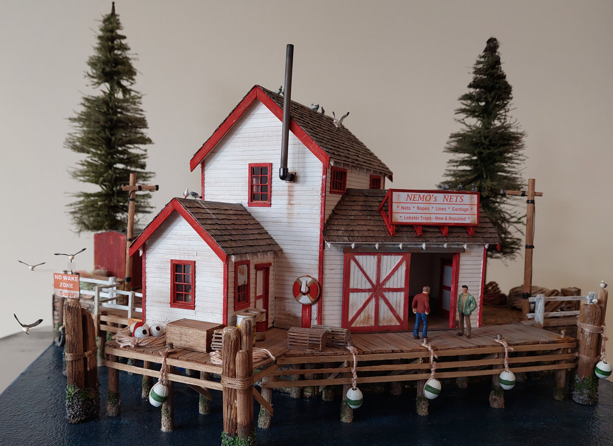

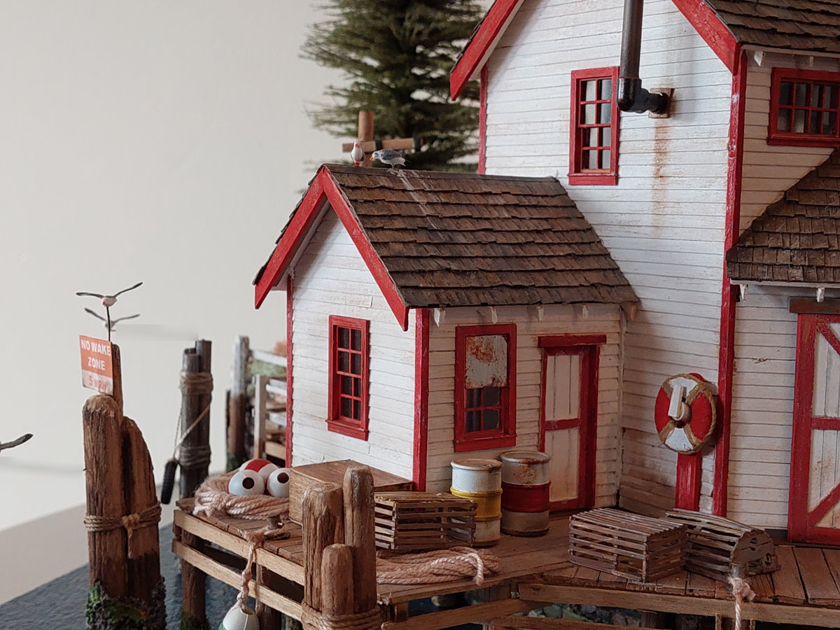

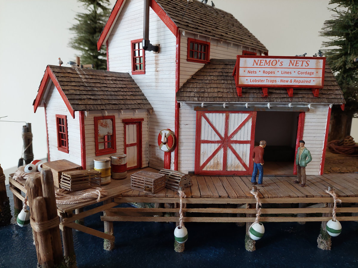

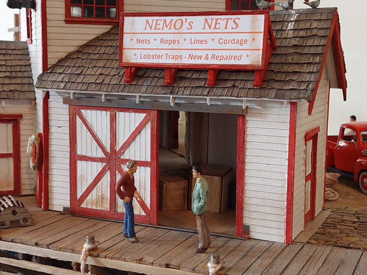

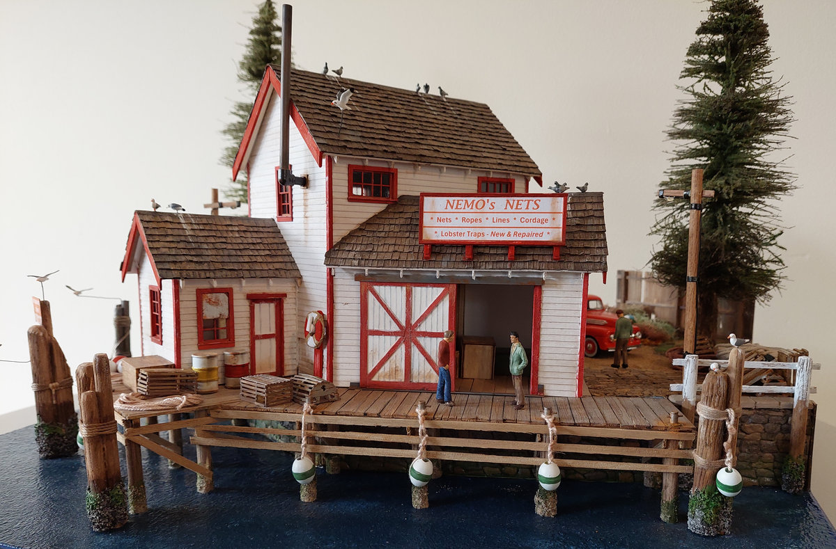

So it was about this time that I stopped taking progress shots of building the diorama, as I needed to get it finished before the Australian Narrow Gauge Convention where I was showing my waterfront dioramas and doing a clinic on boat building.  So here's a start to some final pictures.
These ones without a boat so you can see the wharf detail.
Asorted junk on the wharf.  I scratchbuilt the lobster traps from styrene
Regards  Rob
