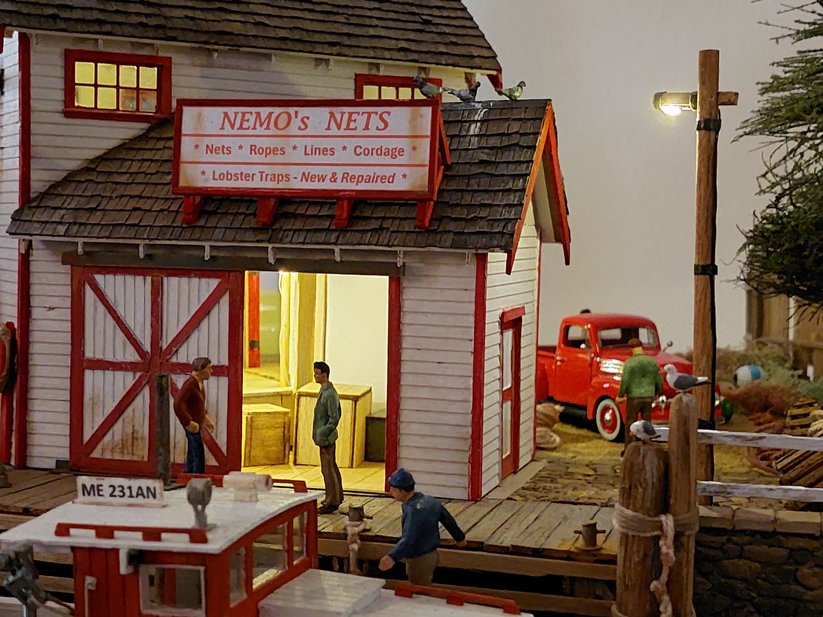

robert goslin
So it was about this time that I stopped taking progress shots of building the diorama, as I needed to get it finished before the Australian Narrow Gauge Convention where I was showing my waterfront dioramas and doing a clinic on boat building.  So here's a start to some final pictures.
These ones without a boat so you can see the wharf detail.
Asorted junk on the wharf.  I scratchbuilt the lobster traps from styrene
Regards  Rob
Melbourne,  Australia

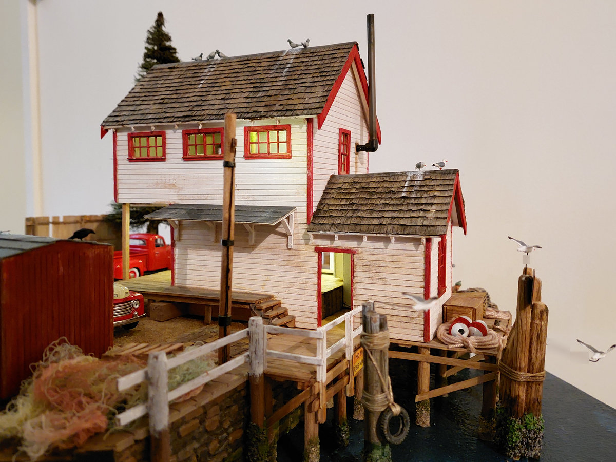

robert goslin
I placed one of my boats in front of the wharf.  This boat is suitable as the colours match the building and is a Maine lobster boat, probably picking up some new or repaired lobster traps.  I scratchbuilt this boat a few years ago and named it Miss Anna, after my daughter.
Here you can see the boxcar shed in place.
On Laurie's model, the back loading dock was just straight across the back.  I extended it around the side of the building and added steps and a lean-to over it.
Boxcar shed in place
Old pallets and a broken lobster trap around the shed.  I scratchbuilt the pallets from balsa.
The pickup truck is 1/48 scale, from Denver Diecast, as is the panel van
The fence I scratchbuilt from very thin basswood, with some damaged palings.
And added the classic Moxie sign.
Other side of the building
For the ground cover I used tile grout.
The overall dimension of the diorama are 17.5" wide  x 15.5" deep.
The two pine trees I made using the wire & rope method, but instead of rope, I used paint brush bristles.
Good view of the roof, including many of my birds. There is a total of 17 birds on the diorama.
Regards  Rob

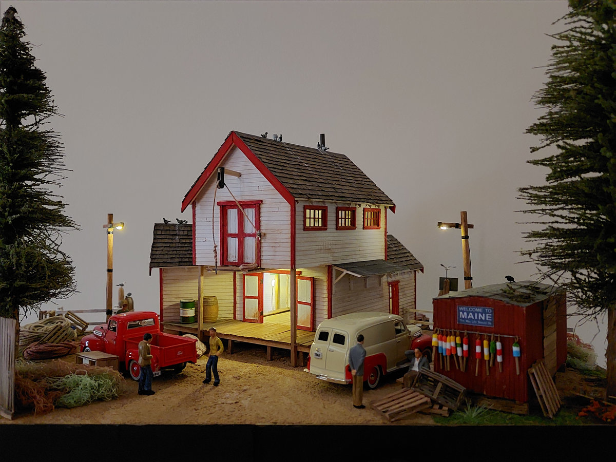

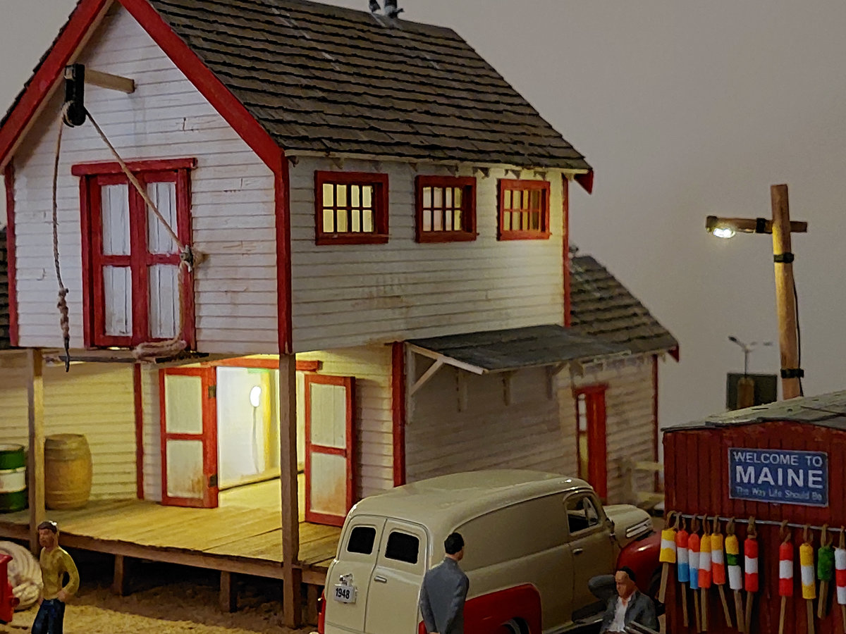

robert goslin
Thanks Jaime & Rick.  Glad you have enjoyed my diorama build.
Here's some final night shots.
I added interior lights to the structure in the ground floor, upper floor, side annex and under the rear porch/overhang and also two street lights that I scratchbuilt.
Regards  Rob
