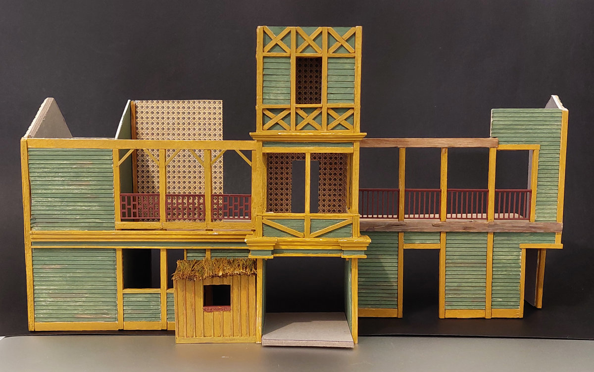

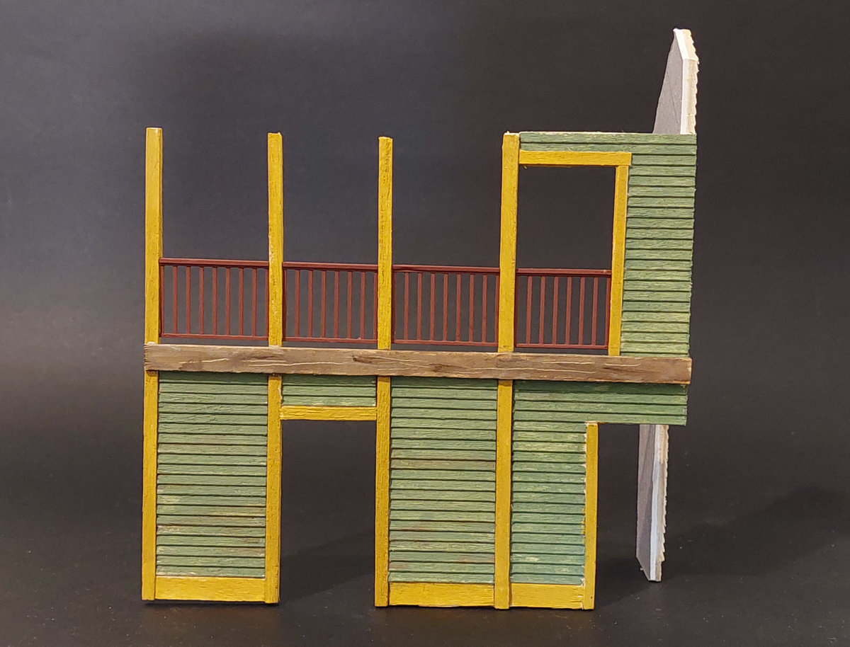

I've now made the left side walls section.  I'm using Grandtline "stick" porch rail #3555 for this side balcony railing.
Whilst not a match for the Disney prototype, it's still a bit fancy so will suffice.

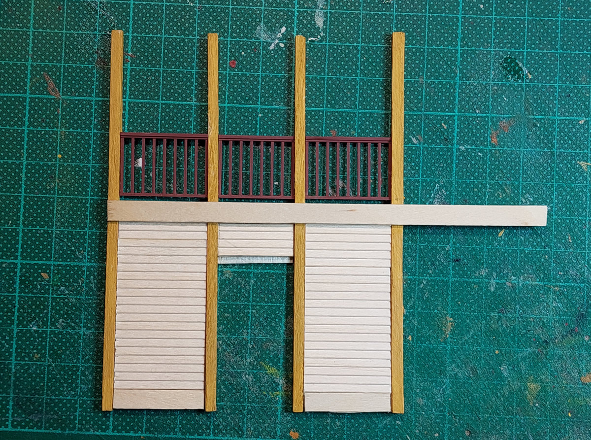

So I cut down the 3 sections of railing to appropriate lengths and this then gave me the distance I needed between the posts. The prototype has 4 sections, but I'm selectively compressing mine to three. And again used styrene for the stepped trim.
Then added the clapboard siding in between as needed.  No, that bit with the grey card showing is not a doorway.  It will be covered by the ticket booth.
All painted up, and attached to the tower.  Was quite fiddly to do.
At least now it's starting to look like a building
Close up of the balcony
Left end section to which I've added a window.

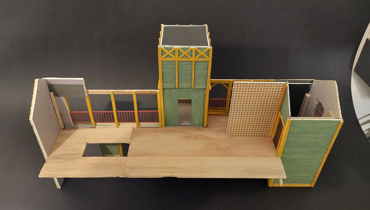

And have added in the 1st level floor using 1.5mm balsa sheet
And the upright interior rattan wall section, just temporarily sitting in place, to see if I like it.
Just printed pattern glued to card

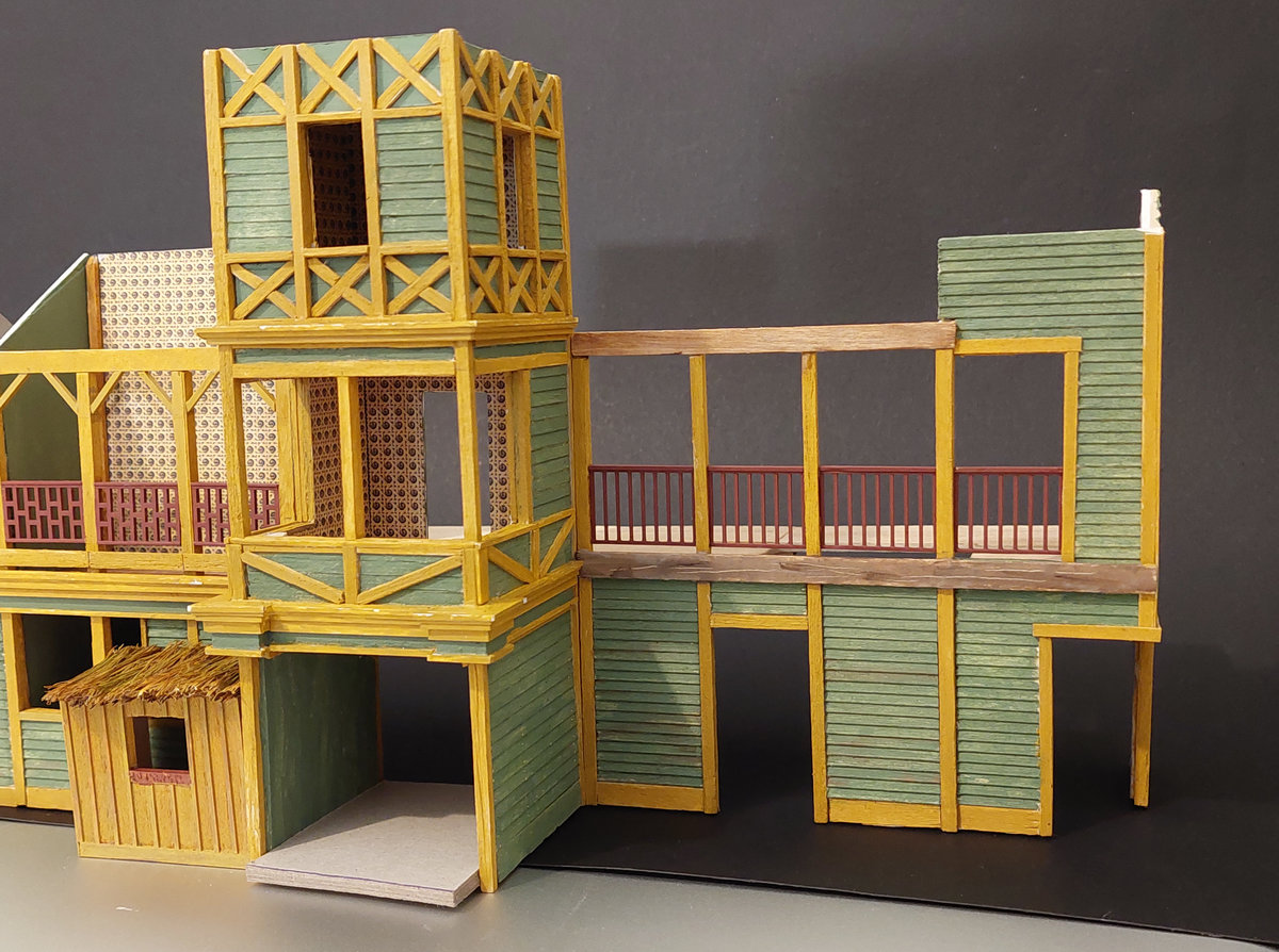

I've now made up the right side front facade. Same method used as the left side.
However, the balcony railing trim is different.  On the prototype the left side railing trim is fancy whereas the right side is plain so I've replicated this look using Grandtline Porch & Lanai Rail #3549
Then completed the rest of the wall section & painted it.
I'm having an entrance on the corner, which is my own idea, not on the Disney version.
Then attached it to the right side of the tower.  The right side facade is set back further than the left, as per the prototype.
Now it's really starting to look like the Disney building. Here you can see the two different types of balcony trim I used. (Refer back to the prototype pics)

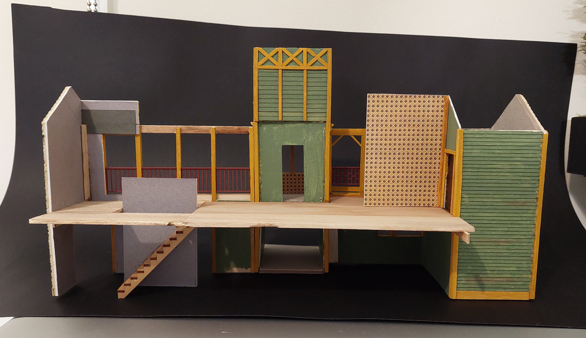

Inside I have now added more balsa sheet to complete the upper floor.
There is also a cut-out in it so I can add a staircase.
Trial fit of the staircase I made using a Rusty Stumps staircase kit
Still need to finish painting the remaining interior walls
