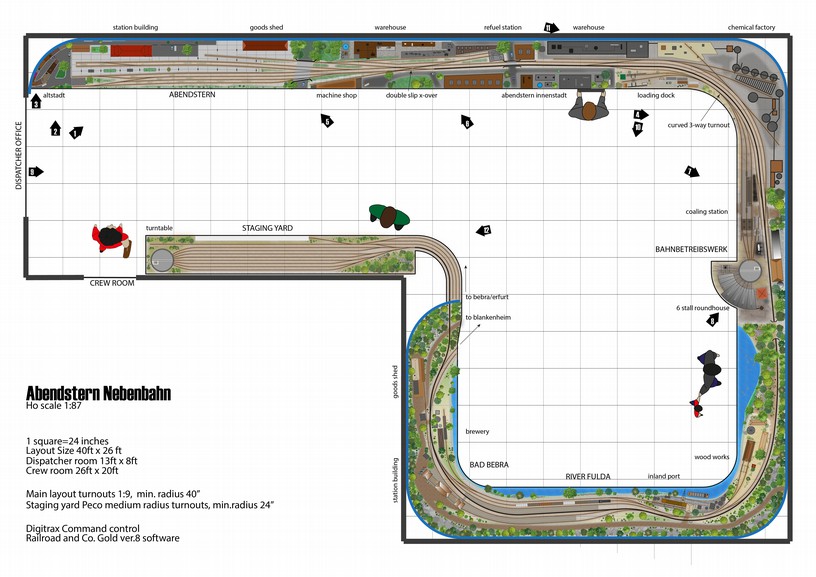

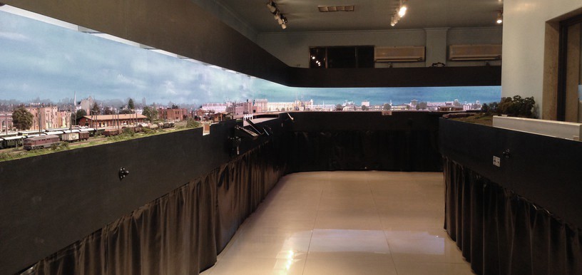

Well , here's another layout build thread on a model railway i am building - Abendstern Nebenbahn. The layout is a Ho scale German model railway set in the 70s. One could read more extensively about it on my blog  .... http://vikaschander.com/category/abendstern-nebenbahn/ . Many of you may have read about it on the "other forum"....
The layout is housed in a purpose built 1000sq ft room and is basically a point to point around the walls design....
At one end is the terminus station featuring 4 platfrom faces, 2 siding and a shunt lead alongwith a few warehouses and a goods shed...

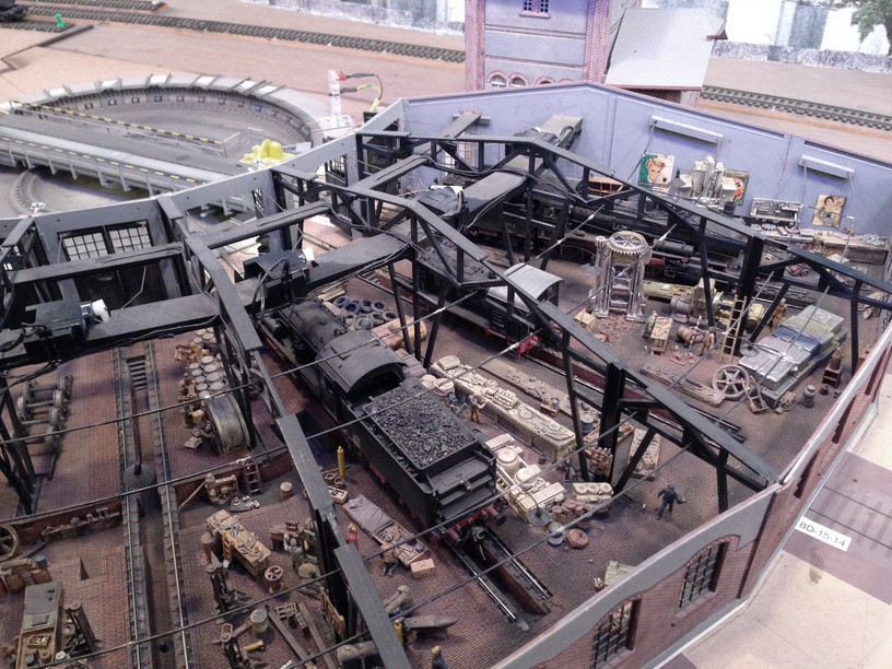

as well as a loco shed with a 6 stall roundhouse and a detailed interior .....

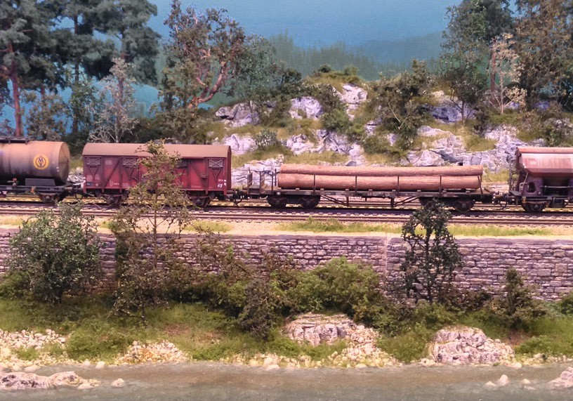

a rural riverside scene section which still needs to be scenicked ....

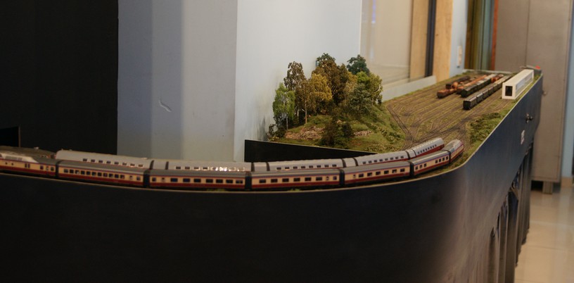

and a staging yard at the other end....

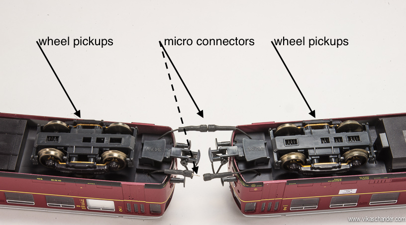

In the blog update I talk about the importance of ensuring stall free operations as key - one way of achieving that is by all wheel pickups as on this rail bus ....

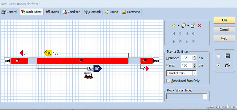

setting up the blocks with their exact lengths help trains come to a stop smoothly....

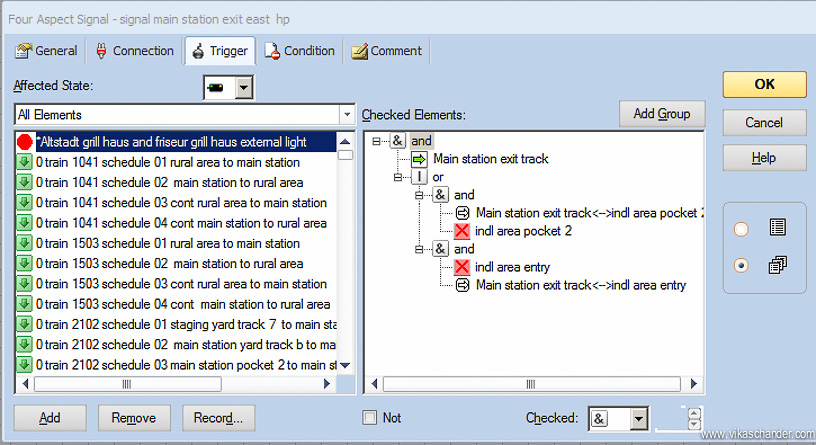

Programming signal logic can be a pain in the....
