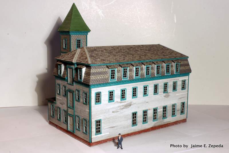

NEMMRRC
Howdy.
Summarizing the main building.
Even though there are still a few odds and ends that hang on to the main building, it is basically done.
The main building called for aging and weathering clapboard, shingling a mansard roof and the main roof, building the tower and aging and weathering a lot of windows. All the windows so far have fit PERFECTLY. I have not had to sand or trim or fiddle with any of the windows. THAT is a joy and it is well worth the price of the kit. South River kits are top shelf and don't let anyone tell you otherwise.
I began building the kit the weekend following Thanksgiving. I've been plugging steady at it whenever possible. It took me about 30 hours to do all the roofs. I used more CA glue on this building alone than I've ever used before. I didn't like CA glue before this build and I still don't like it. I manage to get it where it ought not go no matter how careful I am.
I wasn't sure how all that turquoise would work out. I like it though.
Anyway, here is the main building so far.
Coming up - the link.
Jaime
www.myyehudaexperience.com
