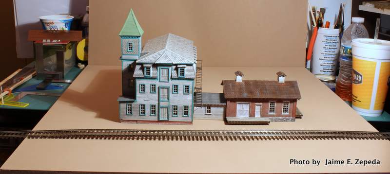

My Gatorfoam (www.gatorfoam.net) came in today. I thought I'd give it a shot and check out how the diorama might end up.

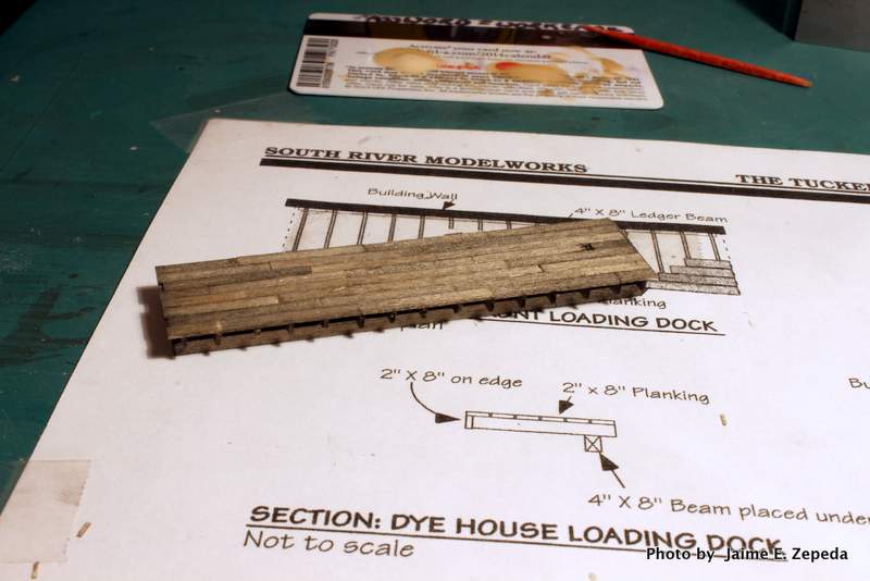

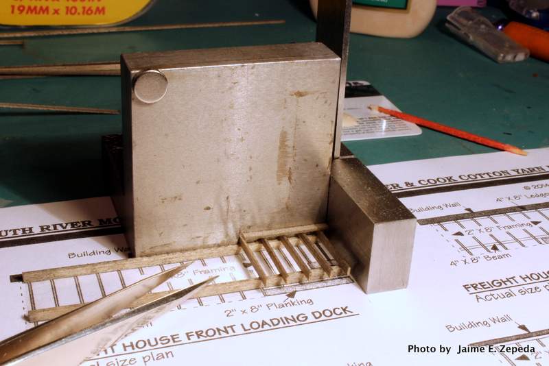

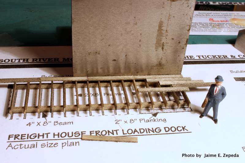

There are 2 loading docks for the picking house. These are built board-by-board. I like it.
Here is all that's needed for the loading docks.
I use double-sided tape to "glue" my work to the full size template(s) provided in the kit. Try to find the removable double-sided tape. The permanent kind does OK but you have to be more careful when removing your finished work off the template.
I cheat as much as possible to get everything lined up straight, What I like about the board-by-board builds is that you can pick and choose which pieces of lumber you use.
The instructions suggest offsetting the planks over the stringers. It really adds to the build to do that.

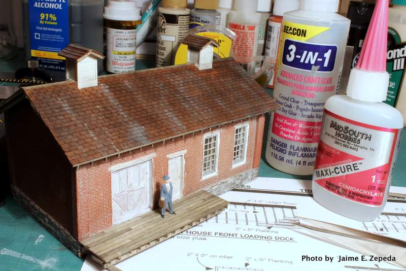

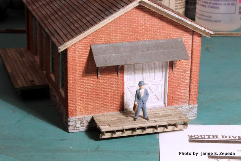

Here is how the larger of the 2 docks ended up.
I used Beacon 3-in-1 glue and CA glue to glue the dock to the picking house.

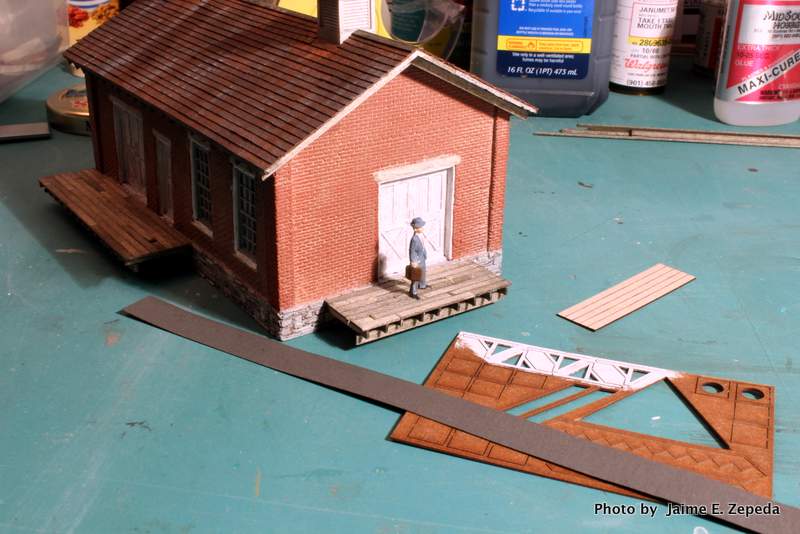

Over the smaller of the 2 docks one builds a small roof. To do this one uses the laserboard roof supports, scale plywood planks and tar paper roofing.
Ta-da!

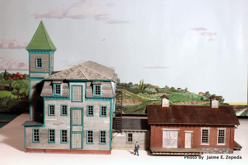

The whole shebang so far.
