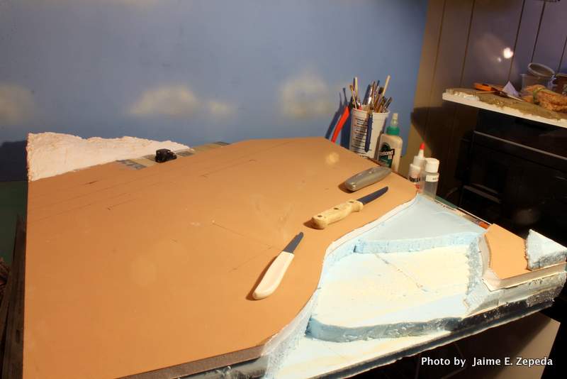

Here is how I got started on the river.
The pilot model has a dramatic drop off behind the main building into the river. In typical South River fashion there are some cool waterfalls/cascades. I want to try that.
To rough in some cascades in my river I cut into the foam base and roughed in some terraces in the river's landform. Once I come back with some sort of plaster to form the river bed I'll blend it all in with the river banks.
Here is a perspective as though standing across the river from the complex.
And here is a view of the front of the diorama.

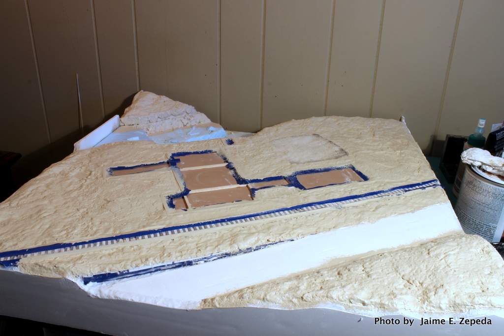

The instructions do a great job of guiding the modeler in building the diorama. Even though I am following the instructions I am not following them in the same order presented in the manual. Scenery is not a linear process for me. I tend to wander and waver with it. I am making an effort to stick to the instructions as much as possible though.
Before roughing in the landforms the instructions suggest making a set of risers for the buildings. To do this one takes 1/8" stripwood to mark the perimeter of all the structures. This is done to give the landscape a chance to slope away from the buildings to allow for drainage as it is done in real life. The instructions give the modeler the option to omit this step but stress that the effect this provides is desirable.
So I took some 1/8" square stripwood and glued it to the perimeter of the structures. Before that though I marked the perimeter directly to the diorama base with a pen.
I am now committed to the diorama's layout.
Next one takes Sculptamold and lays out the finished grade. In the instructions the entire base is covered with Sculptamold. I did not do that. I am still working out some areas' elevations so I am not quite ready to finish the entire grade for my diorama.
Bob VanGelder does a great job of stressing that the grade must meet the structures so as to depict the structures in the ground and not on the ground. I am not sure I can describe the process in a manner that does it justice. I will summarize it for you though:
- apply the Sculptamold with a 1" putty knife
- with a wet brush work the Sculptamold up to each building's edge (or riser's edge in this case)
I own one of the Scotty Mason DVDs that features Bob VanGelder explaining this process. If you do not already own this DVD you should consider buying it. The one you want is volume III. Here is a current link to the Scotty Mason site for that DVD:
http://www.scottymason.com/#!shop/ctw8
I wish to point out one new scenery technique to me found in this section of the build. VanGelder directs the modeler to place the track directly into the wet Sculptamold. One paints the Sculptamold where the track goes a dark earth color and then sets the track into the Sculptamold. I deviated a bit and instead tinted my Sculptamold with acrylic paint while I was mixing it. I did not use enough paint and that area turned out way too light. I will have to fix that later.
Here is a view of how my structures look on top of their risers while the Sculptamold dries.
I have not glued down the structures as I am still debating adding some features to the diorama that will require the structures not be glued yet.

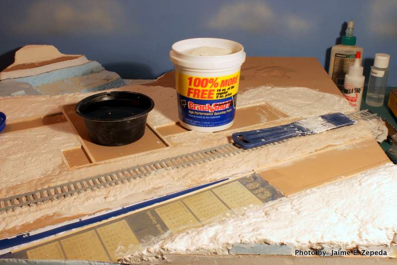

I chose not to use the Durham's water putty. Instead, I chose to use CrackSHOT from DAP.
CrackSHOT goes on pretty easy and it can be smoothed without difficulty with a wet putty knife.
I learned a trick when building a Fine Scale Miniatures kit a while back. If you take a wet sponge brush and "paint" the road surface it leaves a pretty smooth finish.
The CrackSHOT container says it can be painted or sanded after 1 to 5 hours of applying it. That was not my experience. It took a day for my CrackSHOT to set enough to be sanded or painted.
Even though my CrackSHOT road did not crack (YEAH!!!), it did set with pits and dibets. I decided to apply a second thin coat to cover these imperfections.
After the second coat dried I used a plastic card to scrape the road surface even instead of sanding.
I have not decided yet if I will wait until later to paint my road.
