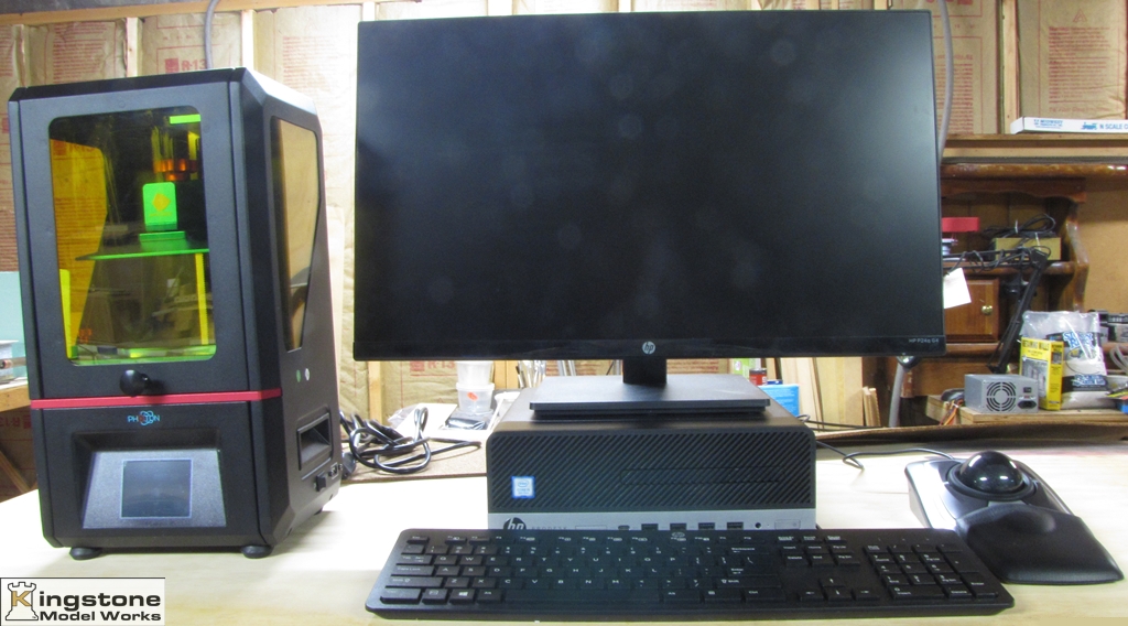

3D Anycubic Photon
- Bernd

So after I got all the software loaded and working I followed the first two lesson by Paul. Got to the point where it was sent to the printer. My road took a bit of a turn. I discovere Fusion did want to export my file an STL. Some kin of cloud issue. I did want to send it to Autocad Meshmixer program. So I downloaded that sent the file from Fusion to it and then save it from Meshmixer in STL form into a folder. I was able to get it into Chitubox and slice it. So I have a bit of a longer path but I can get there from here. A few more lessons and then perhaps I may try printing something. First I need to decide on a resin product.
So that's it for now.
Bernd
Bernd
