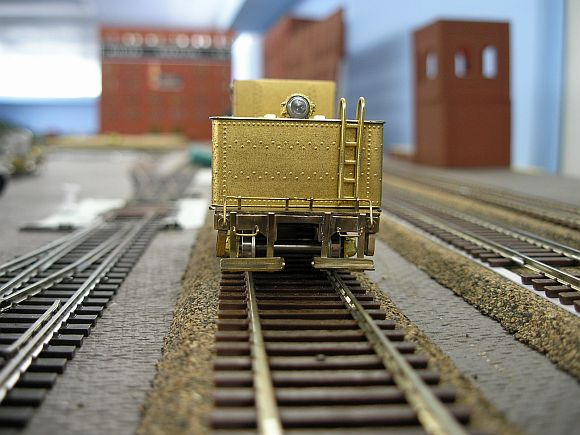

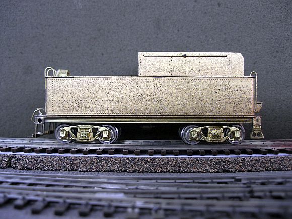

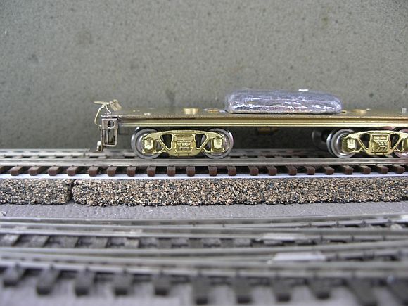

The tender was repaired and is now level and looks good.

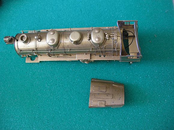

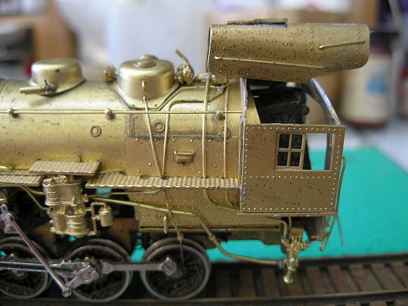

Next came the cab roof repair. This was a real big pain in the A--. Thankfully, the cab sides were still solidly soldered to the cab base. I did straighten the front and rear cab walls a little.
It seems I remember now I lost the photos of the cab roof repairs. Here are the after roof repair photos.
BEFORE:

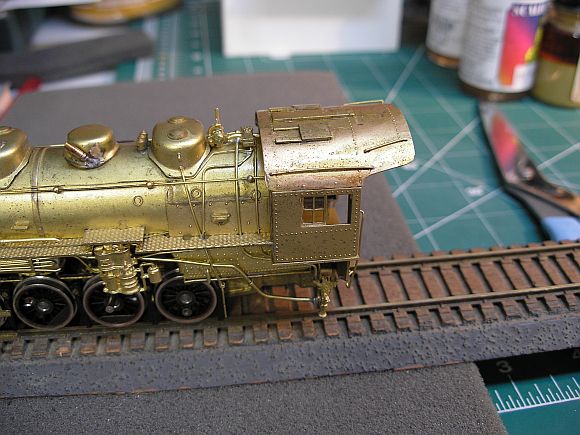

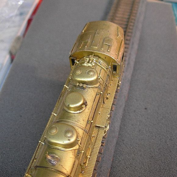

AFTER:
[/size]
[/size]
jbvb
That's a good recovery on the roof.  Do you ever anneal brass parts before straightening them?
James
Quote from: jbvb on April 21, 2016, 07:02:01 AM
James,
Thanks for checking in on the thread. No, I never have. On the reshaping of this cab roof the brass was very soft. However, I did use two pair of needle nose pliers to shape the roof.
Not shown or discussed so much in the thread but I tried to match one side to the shape of the top of one side of the cab. I then slowly used the pliers and by trial and error, shaped the rest to fit. It worked out better than I expected.

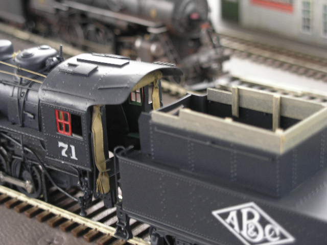

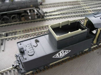

I made some all weather cab curtains out of Chili's Restaurant paper napkins.
I used regular sewing thread to tie the top and bottoms.
Once made, the curtains were painted with Floquil Earth and installed on the loco.
I added two 2X6's to the top of the coal bunker so the loco could hold more coal.
