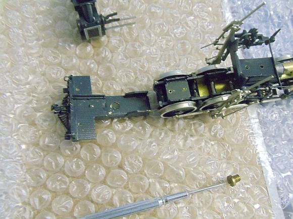

John said it looked like the two frame parts were glued together. Well, I know I didn't glue them together so I told him he must be mistaken. In any event he sent me the loco via the Judge. I had a chance to inspect it yesterday and found the two parts were in fact once glued together.
Apparently the original solder joint was weak and came loose. I'm only assuming that the original owner super glued it back together in order to dump it on Ebay. And along came I! I didn't notice the glue when I stripped it in Acetone and the Acetone didn't dissolve the glue. I painted it, reassembled it and gave it to John for the sound installation.

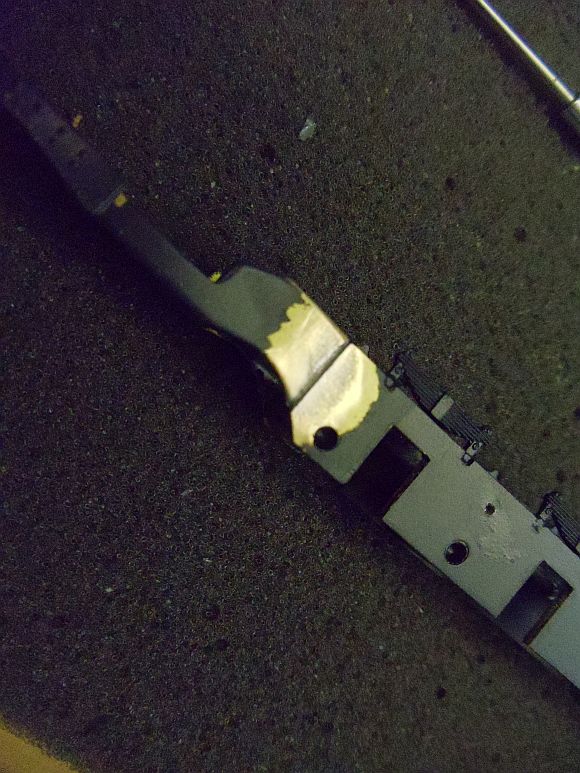

Nothing makes me happier than to have to disassemble one of my custom painted brass locos. Especially in order to make a major repair involving heat and solder.
The photo below shows you a better view of where the two sections were once soldered/glued.

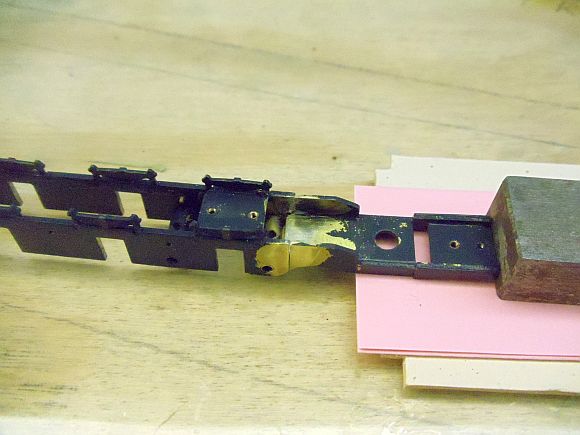

Getting the two frame section properly aligned for soldering was a bit tricksie. I placed the main loco frame on a piece of window glass. I then used cardboard and single sheets of paper to marry the two parts.

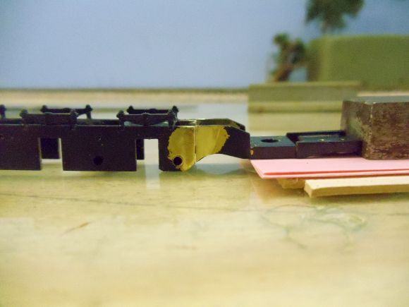

You can also see the two parts are slightly separated at the bottom. I removed two single sheets of paper to get the correct match of the two parts.
I'm going to fast forward here and show you the repair. I used my small torch and Tix solder to make the repair.

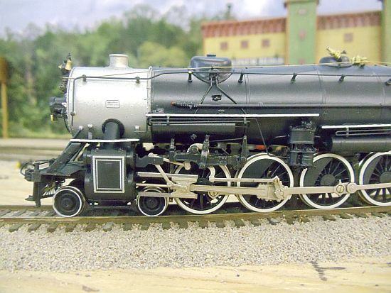

I'm going to supersonic fast forward here and show you the loco as it is now, back in revenue service on the Atlantic and Southern Railroad.
