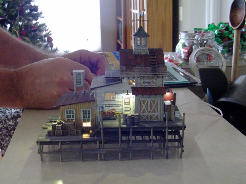

Having acquired a few FSM structures over the years, I finally started to find the time to build as my kids got older and life calmed down some. Starting with George Bailey's produce, photo of progress so far attached.
Here's my question: The time has come to put down track for the siding. Ultimately, I'll want to include the structure on my layout (still early stages, only have benchwork topped with foam, hopefully will start laying track this winter).
How best to have the track at the end that I'll want to connect with the main layout? Of course I'll have a bumper at one end, so that's easy, but should I lay track to the very edge? Should I remove a few ties now? Better to leave the track a bit short of the edge and bring a bit of rail from the eventual siding onto the diorama?
Kind of a weird first question, I realize, but I honestly have no idea what's the best approach so would appreciate any suggestions or words of wisdom.

Hi Mac,
I run the track right up to the edge of the diorama but I remove a few ties so I can add the joiners later. I build all my major structures as dioramas and install them on the later after. It's so much easier to detail at the bench for me.

Steve (actually my real name too!):
Thanks, that's kind of what I was thinking, but nice to hear confirmation from someone who's been here.

Make it look good and correct for now and modify as necessary later.

I agree with Steve. The missing ties can be added when the diorama is added to the layout.

Great looking build - and welcome to the forum. We look forward to seeing your future work. As for the track work - when I don't know how a build is going to fit into the layout I add the section right beside the loading dock and leave space for the rest until I install it on the layout. I think it all depends on how you will use the diorama before installing it.  If you want to show it at a convention then you need to take your best guess and finish it.
Welcome to the forum, Steve.  I placed my track between the building loading dock and the external dock.  Long enough for one boxcar.  Your building looks great!

It's usually smoother to have rails continuous over a joint in the roadbed than to have a rail joint right above the roadbed joint. And rail joints are smoother when staggered 1/2 inch or more.
