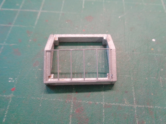

As I mentioned in yesterday's post, the skylight frame is to wide for the glass frame to fit properly.

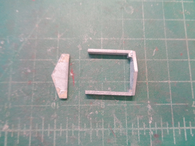

I measured the width of the skylight and found that it was exactly 6 HO scale feet to wide. That is the width of the gabled ends of the skylight. That equates to 1/16" in a ruler measurement.

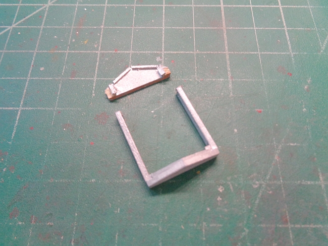

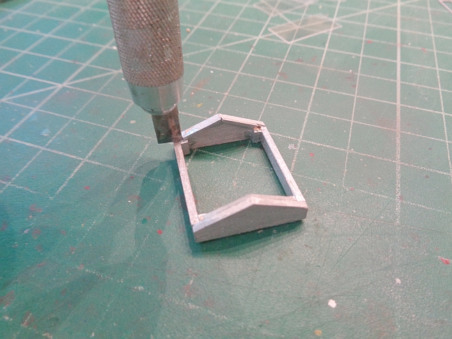

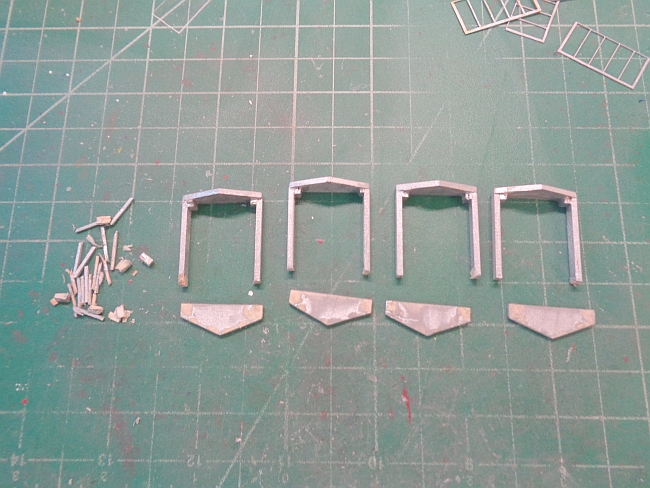

I used a #17 Xacto blade and cut down between the end as shown below.

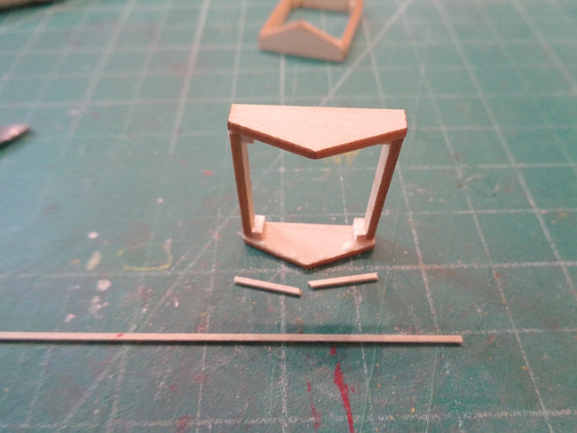

Since I'm shortened the width, it wasn't necessary to keep the 2X2 glued to the gable angles.

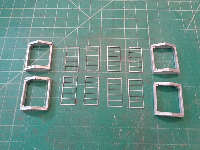

I then cut off the remaining 2X2s from all the skylights.

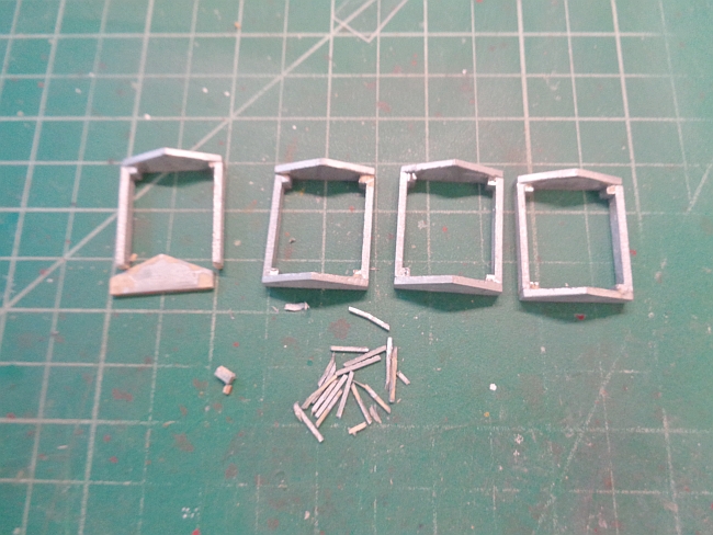

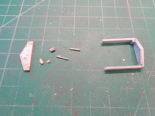

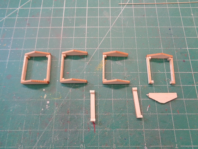

I then removed one end of the gables from the other three. The old glue was sanded from all the gables.

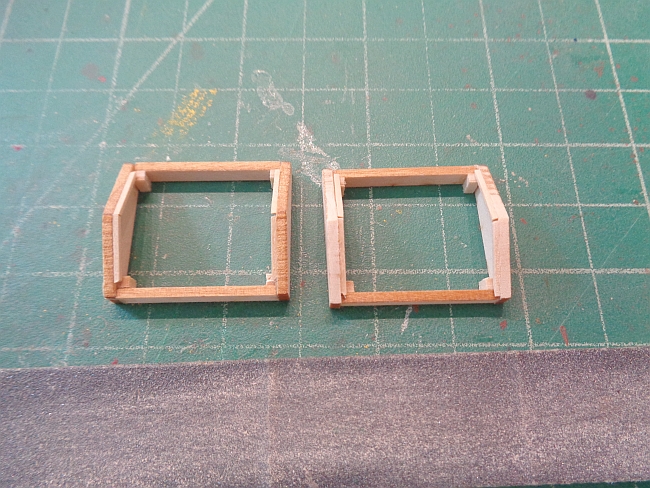

I measured, thrice, and cut 1/16' off each of the eight side rails.
The four end gables were glued in place and set aside to dry. When dry, I touched up the sanded area with the silver paint.

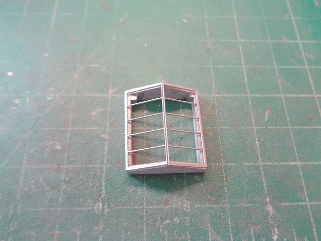

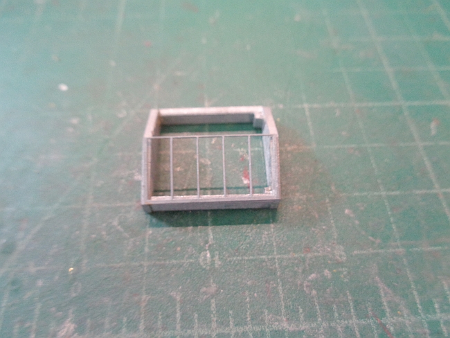

The glass frame is on the skylight but not centered. I kept sliding around. I'll glue it in place once the glass is added.

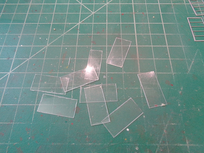

I forgot to mention that I also shortened the acetate glass panels as well.
This is much better and now looks correct. I did tack them in place to keep them from sliding off.
