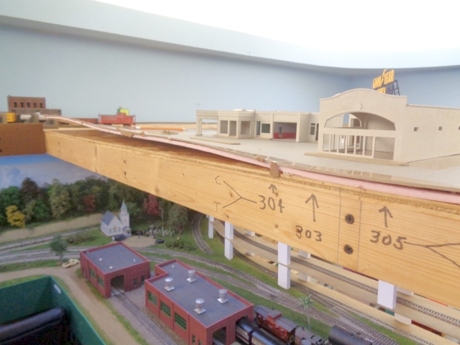

I didn't come out to the train shed for almost a full month after the July 27 eye surgery. One day I came out and wanted to check on the Horwood Bros. build. I wasn't to happy with what I found.
The building were fine but the pink foam and 2 ply cardboard were curled up.
I've never had this happen in the past.

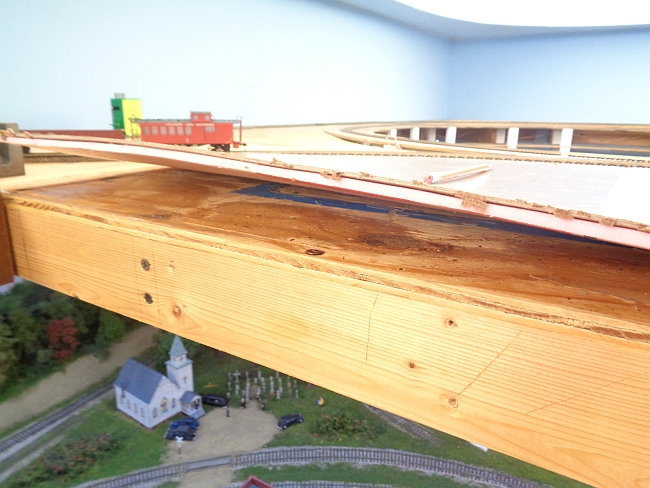

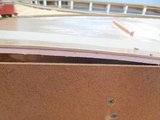

I was able to push it back down but that caused a bulge in the middle. I decided to remove a portion of the Masonite fascia and glue the foam down on the plywood.
Apparently, some of the glue was holding the foam and cardboard on the edges. When I removed the fascia, the pink foam curled up even more.
Referring to the above photo, you can see a little piece of Masonite (over the 304) glued to the plywood and pink foam.
Prior to going any further, I carefully removed the three structures. Thankfully they weren't glued in place.

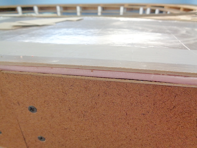

When I pried the Masonite off the edge of the plywood and pink foam, it all curled even more.
I used a 6 foot length of 1X4 and used Tight Grips to hold the outer edge of the foam and cardboard flat flush at the layout edge.
When I did this the other portion of the foam and cardboard wouldn't lay flat. I knew then that I wasn't going to be able to fix this. The entire area needed to be removed. I've used 2 ply cardboard over the pink foam on other areas of the layout with no curling or lifting off the plywood base.

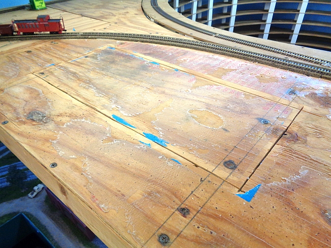

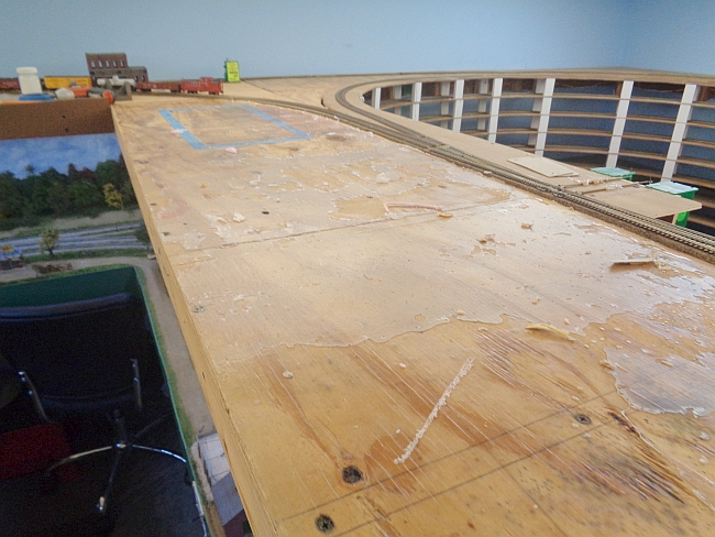

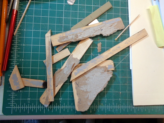

I made the decision to remove all the pink foam and cardboard on top of the foam. I first used a #17 Xacto blade and putty knife to carefully remove all the sidewalks. I got them off with no damaged.

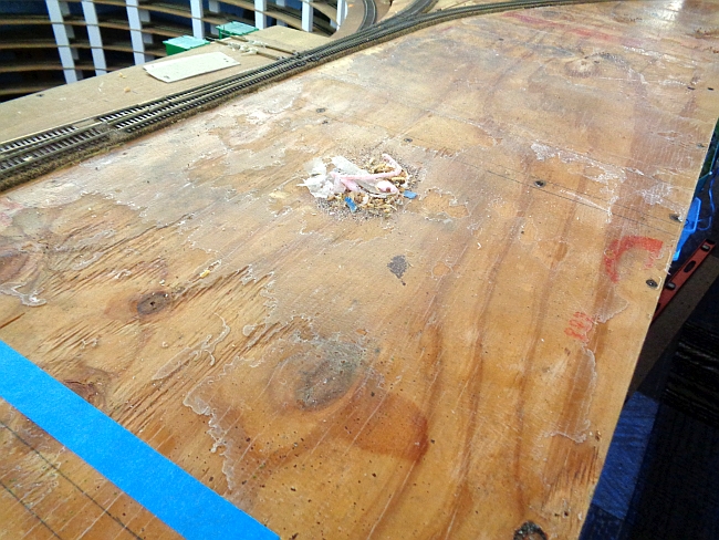

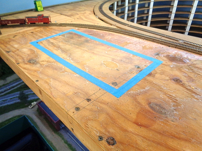

When all was removed, I wrapped course aluminum oxide sandpaper around a sanding block. I sanded the entire area when I had the pink foam.
I re-applied the blue tape and vacuumed the trash.
I'll redo the area with the cardboard and not use the pink foam.
I'll show how I removed the dried cardboard from the bottom side of the sidewalks in the next update.
