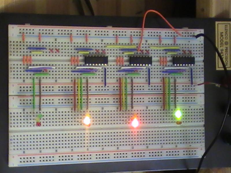

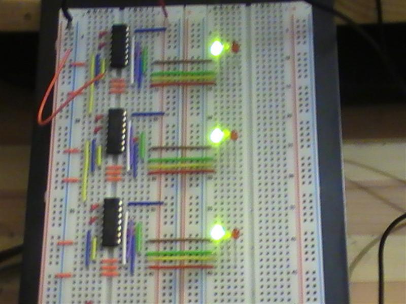

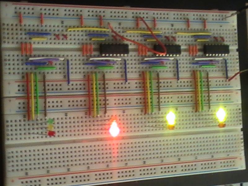

Ok everybody...here are three blocks on a breadboard to show you what I built for a signal system many moons ago.  Back when the twin-t was king.  The only difference, instead of my input being from a relay, I used opto-isolators to activate the signals.  TTL was still a youngster.
Now, I have the DCCBOD type detectors.  Which I built also.   None shown here though.  Just using a piece of wire to drive the Re input.
What you see here are as I stated, no driving transistors, no dropping resistors.  Very inexpensive!  Each signal head, uses a 74LS00 quad two input NAND chip.
All the circuitry is inside the chip, with the exception of course, to interconnect the inputs and outputs between the pins and in and out from the board.
The Re is low, or ground when the signal is red.  This drives the signal behind it to yellow.  East bound and westbound heads all have their own board.
Here in these photos, you can see the progression.  Granted, it is only three blocks, but you should get the idea.
Each board costs around $1.50.  Even a little less if you set up an assembly line and not try to only cut one board at a time.
It is a building block system with four components.  Detector, signal head board, turnout control board and crossing board.  The latter is not really used that much, but just in case you ever need one!
I will be putting together a couple of the turnout control boards and integrating them for you and show them working here in the forum.
This system is not more difficult that putting together snap track...one section at a time.
I do apologize for the brighness of the LED's and the little blur.  I do not have a very professional camera.  My tripod broke so it's handheld.  Anyhow...
I used this system for 9 years and it operated flawlessly.  Not a single LED burned out in all that time.  The boards were never in need of repair or replacement!
This is a pic the chips used and the led's.  The wiring of course could be put on those little pro boards and hardwired just like you see here, but I make my own printed circuit boards with a laser printer.
The bent orange wire represents the detector being activated.  It is just being used directly to drive the signals.  As this thread progresses, I will show the detectors and all the interconnections that make this system work.
Here are three of the blocks showing none occupied...Green Board!!
Here the second block is occupied.  These signals represent Eastbound.  Westbound would be wired up the same.  One chip missing, but just pretend.  It would be green.
Here the top signal is showing occupied.

DACS
Oops, this pic should have been the second above.  It shows the first block occupied and the two blocks in front clear.

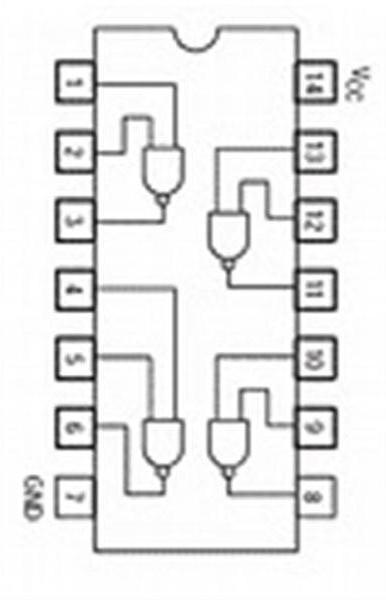

The chips that are used in this system, are the 7400 series TTL.  When I first built this system back in the late 70's,  TTl was still not that old.  For those of you who do not know what TTL stands for...Transistor, Transistor, Logic.
Today, we have at our disposal, 74LS00 chips.  Same circuitry, just greatly improved as a product.  I pay .40 cents apiece for these little wonders of electronics wizardry.
Each signal head has one chip mounted on a small PCB.  The signal driver board has on it, the 74LS00 Quad two input NAND
The internal circuitry is not important to build this system, it is too complicated.  So we use shorthand, or symbols.
This shows the 4 individual NAND gate symbols, inside the chip.
Pin 1 is the orientation pin.  Pin 7 is the gnd and pin 14 is +5VDC.
You need to have a 5 volt regulated power supply.  I have a 5 volt, 4 amp dual regulated power supply.  Though you do not use the negative voltage.
This system uses reverse logic for it to work.  Normal usage uses positive logic.  High input means true or 1.  Low input means false or 0.  I use Low input means true or 1.  High input means false or 0.
This is how I use the NAND circuitry, to make a signal.
The pin layouts, are very important to adhere to.  Do not deviate from this pin diagram schematic.  You might notice I do not have pin 7 or 14 on the drawing.  This will show up in a later posting.
Also note, that the LED's are common anode.  These are connected to the mast of the signal itself.  This is driven by pin 8 of the chip.
Coming off the board, there are only two inputs (Re and Ye) and four (kg, ky, kr)outputs.  Then it has the voltage and gnd.
This is one complete signal driver board.  There is one for every signal.  Eastbound and Westbound.
The Re is Red enable input is actually, driven from gnd through the detector, when the block is occupied.    Yo is Yellow out to the previous board.  Ye is coming from the board in front and drives the yellow LED when the signal in front is Red, or occupied.
You may also notice, that pins 9 and 10 are tied together and grounded.  This is for NORMAL lighting.  Or the signals are on all the time.
Notice the dashed line going to Ge.  This is for making the signals APPROACH lighted.  Or, the signals come on only when the train enters the block behind it.  Then it will either light up Green, Yellow, or Red.
I will show how to connect this up later, if you prefer APPROACH over NORMAL.

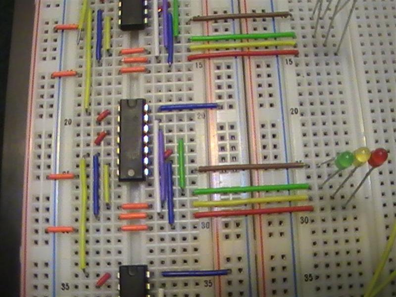

Here is one signal head circuitry hardwired on my breadboard.

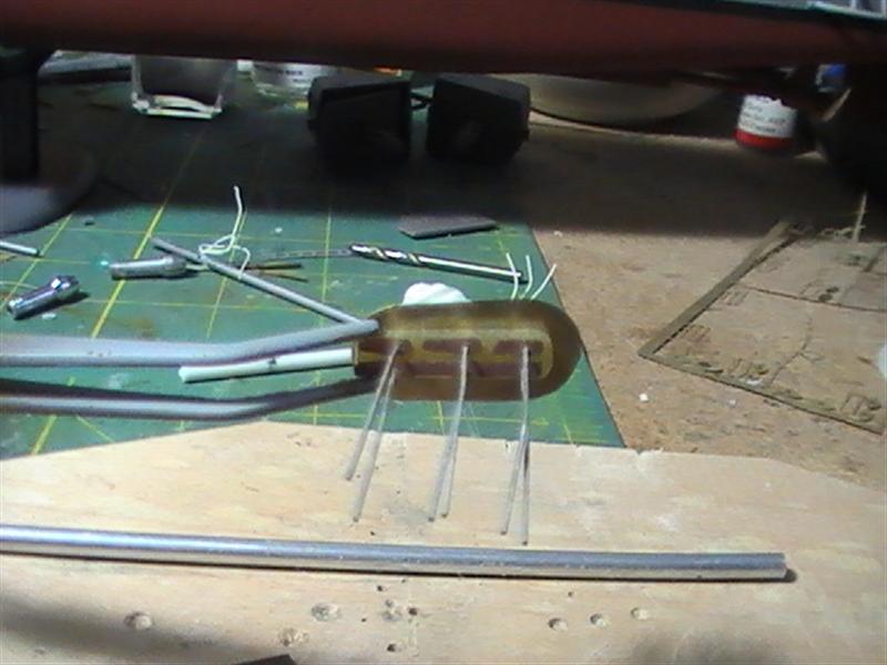

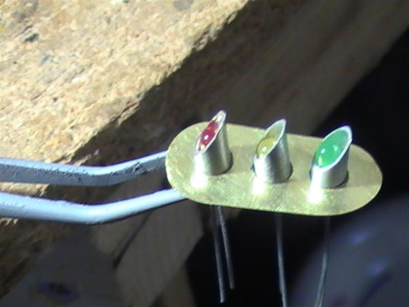

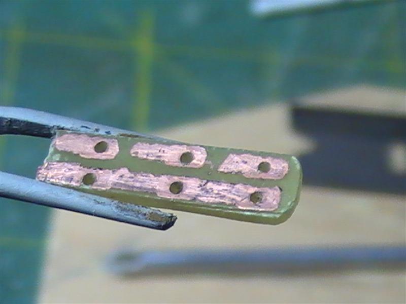

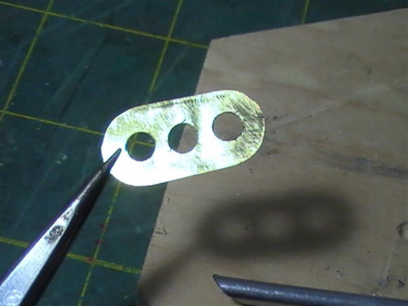

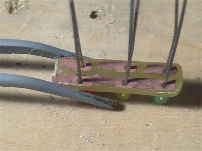

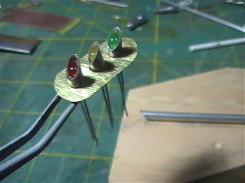

While I am waiting for the chips, led's, pcb material, etc., I thought I would go ahead and start up building some signals.
Today, I worked on a head.  Now these signals I am constructing are in 'O' scale.  I know most of you work in 'HO', but there could be some ideas here that you can glean.
The base for the head is a PCB that the led's are soldered into.  I made the traces by hand with rub on's for the leads.  The PCB is 13/16" x 13/64.  This signal system is common anode.  So the small strip of copper running from the top to the bottom, is where the anodes are soldered.  The opposite side, is done with small, individual pads with a small tab just below the led lead.  This small tab is where the wire will be soldered.  It should make for a very clean and neat little package when finished.  Shouldn't have big globs of solder.  At least that's the plan.
This makes the actual support for all the LED's, the wiring and the signal target.
The target is cut from .20mm brass shim stock.  The holes are drilled using a 5/32" bit, then cleaned up with a jewelers file.  The target is 61/64" x 15/32"
The prototype target is 57" x 34".
The LED's are 3mm.
The hoods can be made from brass or aluminum 5/32" tubing and are 5/16" in depth or length.
The LED's are soldered into the board, then the hoods are placed with ACC.  I have not done this yet as you can see in the pics.
Once that is done, the target is placed over the LED's and attached with ACC.
I don't have the wire yet.  Like the check, it's in the mail!
When I get the wire, I will attach everything permanently, then I will make an enclosure from plastic channel stock.  The wire will come out the bottom, of course.
The mast will have a hole for the wires to go into and down.
I will show all this once I get the materials I have ordered.
Well, it's a start!!
