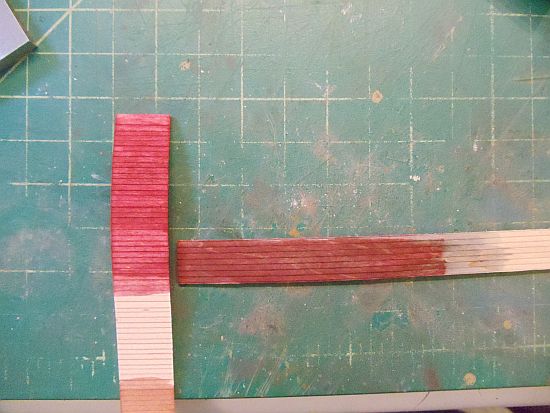

I always test the color on some scrap strip wood prior to applying the color to the model wall. Adding white will make the red more of a pink. I don't want pink. The best way to tone down the red is to thin the paint as it is applied followed when dry with a healthy dose of A&I.
I'll post the results of the test piece when done.

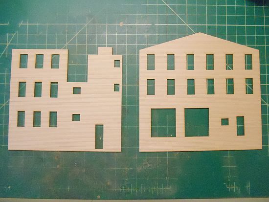

I separated the main wall into two pieces. I used option C as I mentioned earlier.

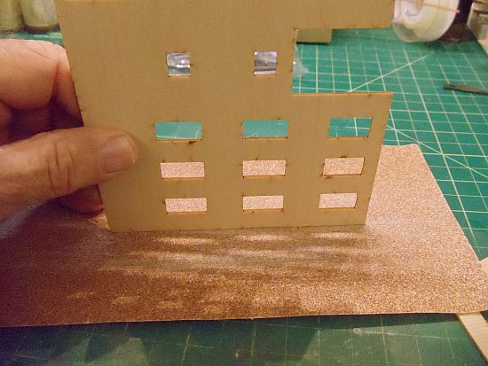

After I separated the walls, I carefully sanded the edges of the cut and also the laser cut sides. The laser cuts at a slight angle and I've found that I get a better/tight fit for the corner trim if the sides are flat.

I mentioned also I would report back on the LV Cornell Red. Not a color I'll be using. The test pieces below are proof. The sample on the left is out of the bottle and thinned with water. The sample on the right is the Cornell Red applied over a coat of light A&I.
I don't like either shade of the red. Back to the color chart!

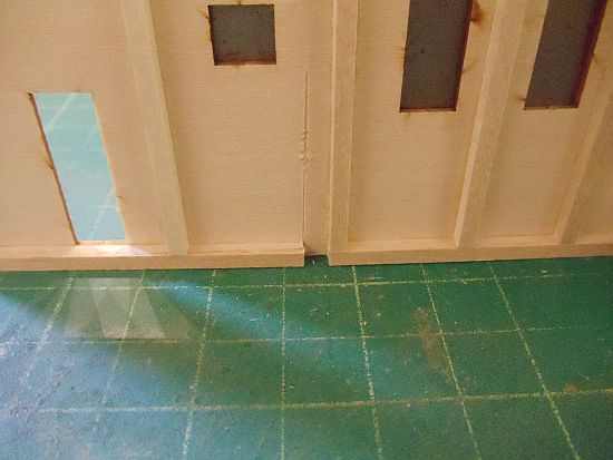

The bracing is still on going. I braced the bottom of the walls and where the interior wall goes, a small section of the brace needed to be removed so the wall would fit.
You can see I cut into the back of the wall just a little. No biggie!

Thinning red paint will lesson the opacity but not really alter the tone. Adding white produces pink.
One way I've found to avoid ending up with pink is to add tan or earth tone paint instead of white.

I consulted with my wife (formally trained artist.)  She says "add a very tiny amount of green to the red to tone it down."  I think that's the 'complementary color on the Color Wheel' solution.
