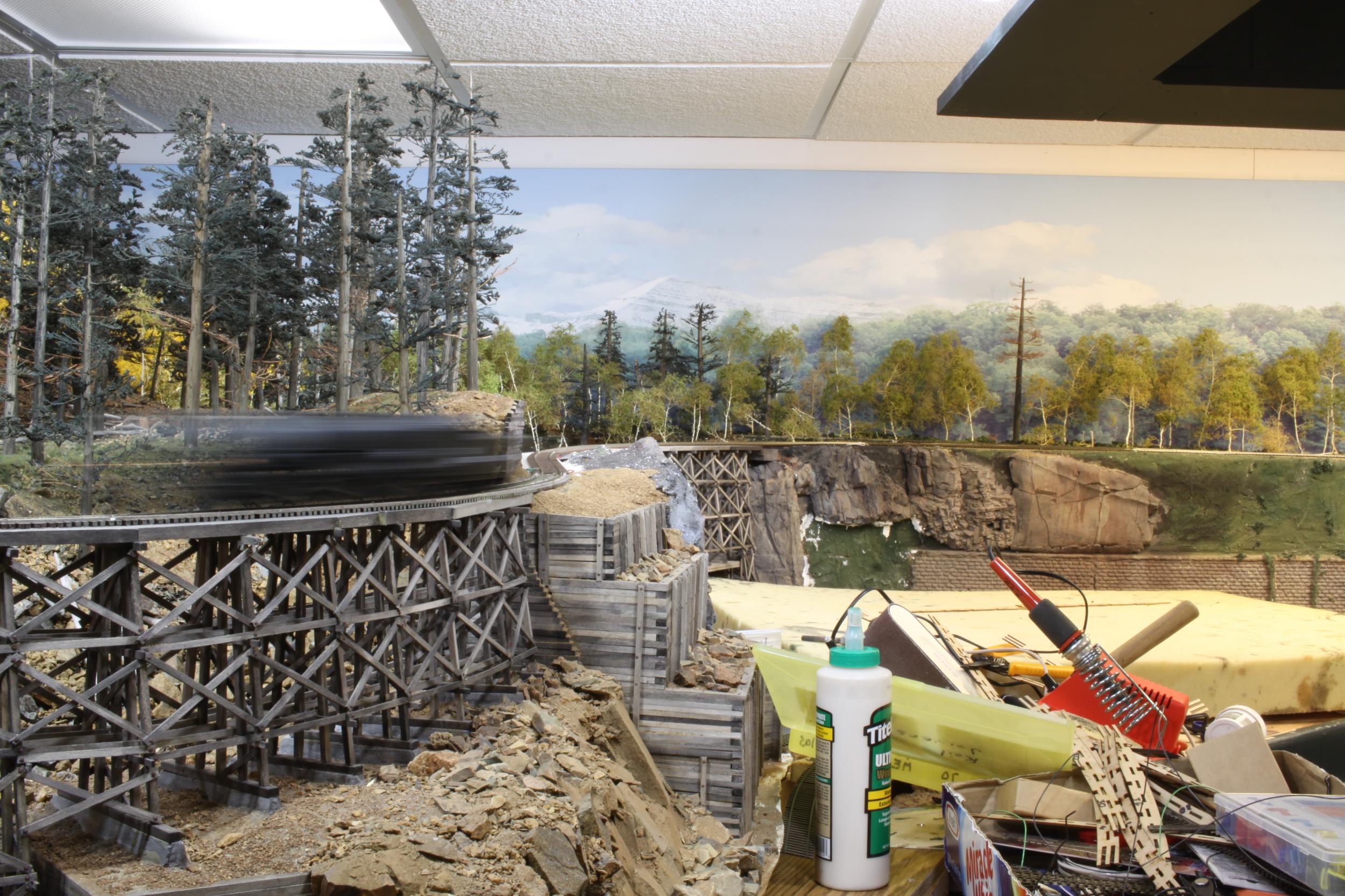

The new track work was tested first with a 3 locomotive diesel consist with a number of box cars a passenger car and a caboose.
This train was test run across the trestle at increasing speeds through the scale speed ranges without incident. At this point the train was run at "Judge Speed" also with out incident.  I learned about Judge speed from Tom Langford's build thread. It seems the Judge is a little heavy on the throttle.
Here is the test train.
Here is the test train traveling the length of the trestles at "Judge Speed".  ;)
The next step was to get the largest steam locomotive owned by the S&S RR - a locomotive acquired from the Union Pacific Number 3671 a 2-8-8-2.
This locomotive was tested back and forth through the two trestles with increasing speeds without incident.
The Engineer on the 2-8-8-2 was not going to be outdone by a diesel so the locomotive was tested at full speed ( speed step 126) both forward and backward. After 12 test runs the problem was declared solved.  This part of the railroad is ready for the Judge and/or my Grandkids to visit.
It should be noted that the 2-8-8-2 locomotive couldn't get across the small trestle at any speed before the changes. This was also true for any of the 2-8-2 locomotives in the S&S RR fleet.

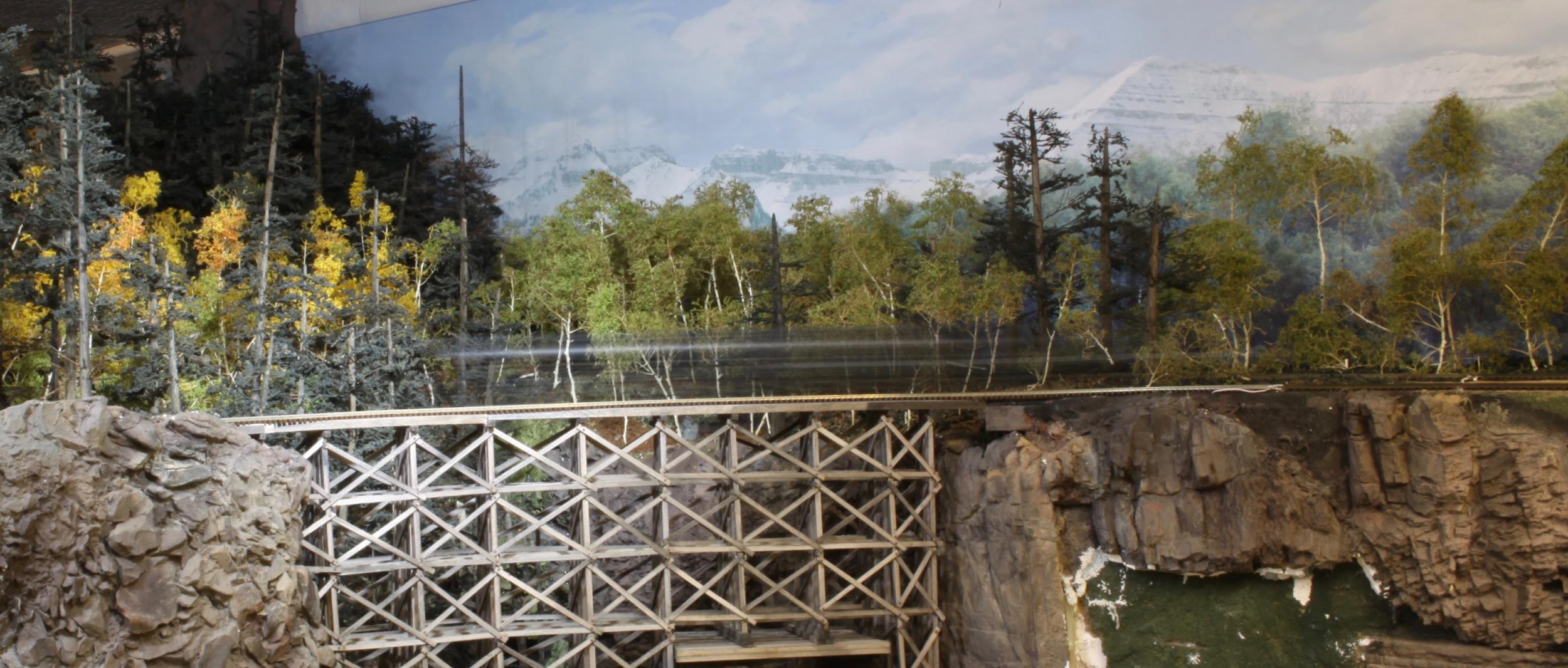

Great job, it definitely sounds like it's fixed.. Can you post a picture like the one showing the problem so we see how you fixed it?
Curt
Take a look at the picture on the bottom of page 31.  The big difference is that there is a 10 inch straight between the two curves. I also went from a 28 inch radius minimum radius on the smaller trestle curve to a 32 inch minimum.  I added about a 1/2 inch of planking on the close end of the trestle.  It is all hid by the landform.
One more point on the track work changes.  I didn't take the S completely out of the track so I still have the winding train look that I was looking for in the first place.  I just added a straight section in-between the transition of the two radii.  And I also added 4 inches to the radius across the smaller trestle.

Here is a picture of the changes to the trestles with just the track gauges in place.  First gauge is a 10 inch straight, followed by 2 - 32 inch radius curves then a 34, 36 and 40 inch radius transition on to the straight track on the far right.
