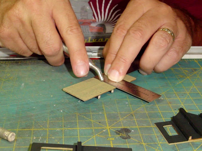

Time to start working on the walls.  I removed them from the carrier sheets using a single edge razor blade.
Then I sanded the edges square using an emery board.  A trick I learned from Tom (ACL1504).

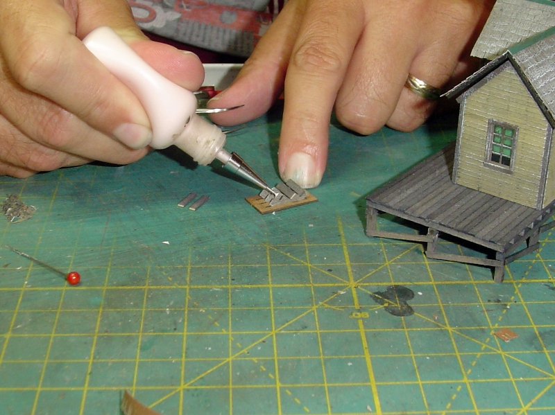

Next I applied some 'spacers' supplied in the kit and bracing to the walls.  Note that this particular spacer gets applied to the clapboard surface side of the wall.  That seems counterintuitive but it's correct.  It'll make more sense when you see how the walls go together.  There's a photo of this in the instructions but I can imagine it would still be easy to make the mistake of gluing it to the back of the wall.  Luckily I didn't.

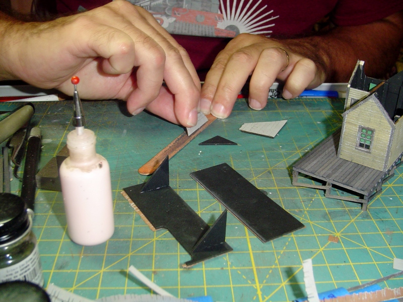

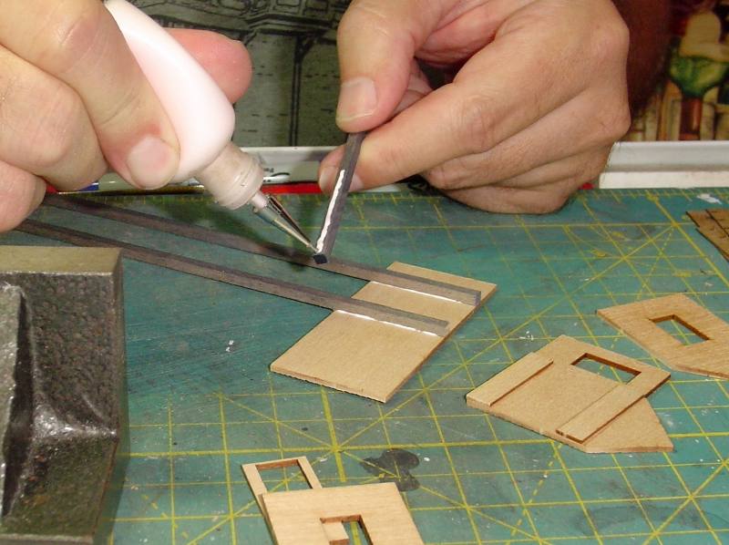

I glued bracing to the back of the walls more or less per the instructions.  I added a little more to the peaked walls.  I find the 'peaks' on walls like that subject to warping if not braced right up to the peak.  :P  I align one end of the bracing with one edge of the wall and trim the other edge to fit later on.
After the bracing has been applied I put some weight on them for a few minutes.  I'm using Pink Flamingo Glue so it doesn't take too long for this to set up enough that I can trim them.  The glue may not be completely dried but the grip is fairly strong at that point.
Then I trim the bracing using a single edge razor blade.  Cutting across grain like this it can be tough on the fingers at times and if that happens I revert to a chisel blade in an X-Acto handle to make these cuts.
