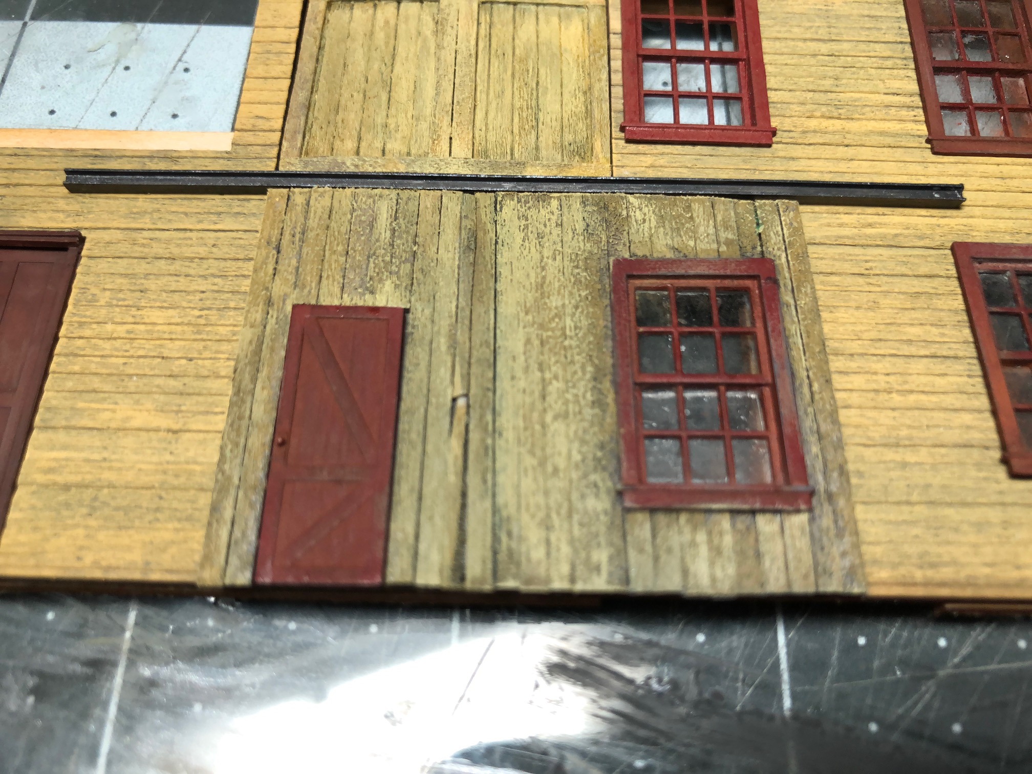

I'd heard (and agree) that the walls looked fine but the windows didn't look weathered enough and appeared too new compared with the walls.
So I used a fiberglass eraser to scratch the windows a little more, added a wash of several colors of Hunterline stains, and after that dried I scrubbed some rust tone and gray Bragdon powders into the windows.

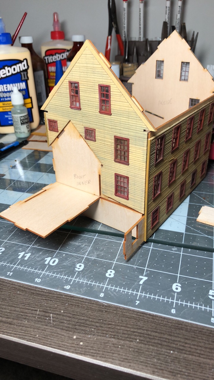

And I decided to get back into building some models - which lead me straight to the storage tub of half-finished (started?) models I'd had in the apartment. At the very top of that tub was the smaller box containing the parts of Ben's mill.
First thing I did was spent an evening dry fitting the parts to remind myself how this thing is supposed to go together!

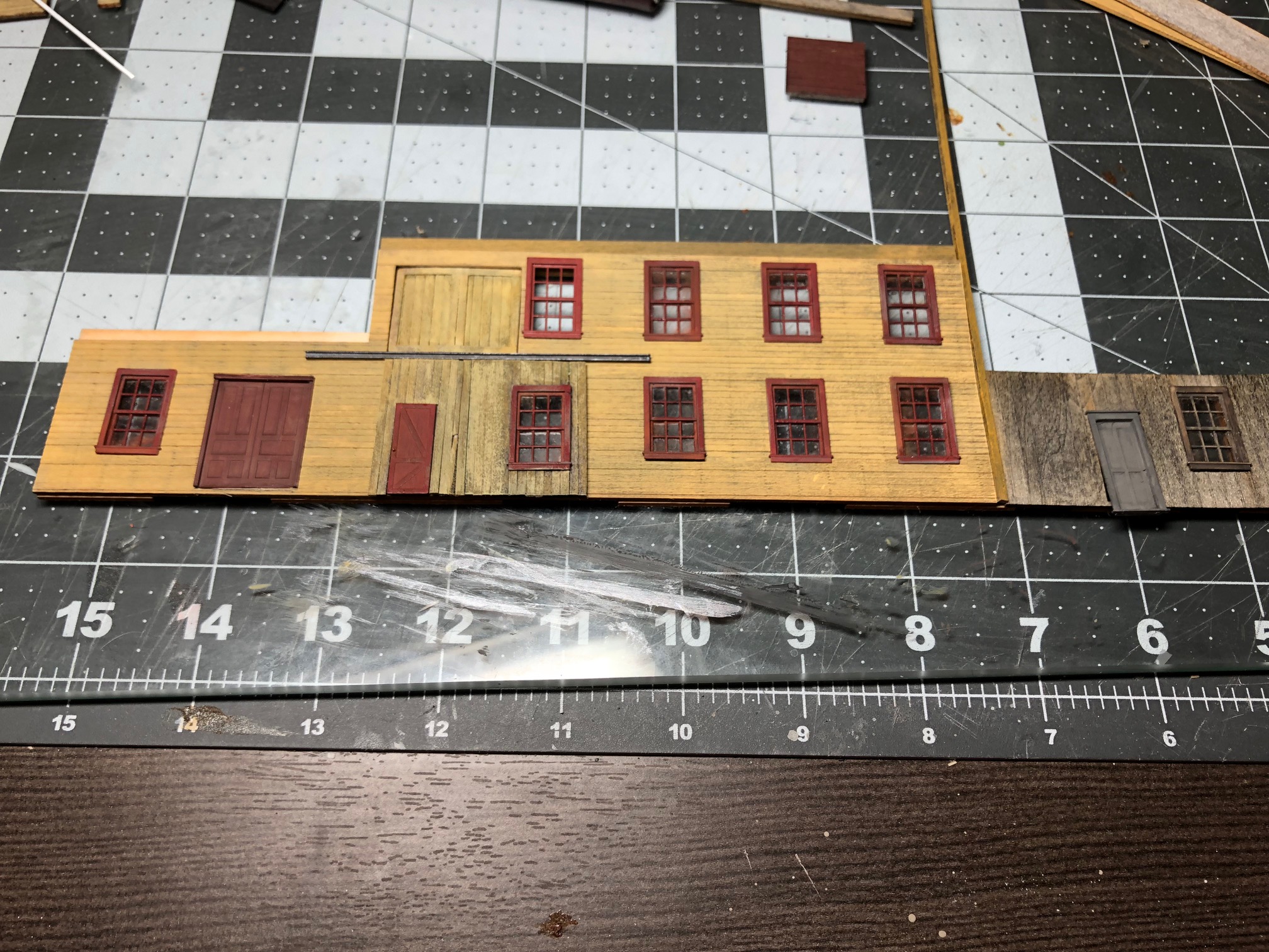

This weekend I finally got started on the doors for the front ("street") side of the mill building:
Here's a closeup of the large doors - still need to add the rollers and hardware and attach the rails to the front wall of the building. I think the red door may be a little too much - I need to tone it down or paint it more like weathered wood.
