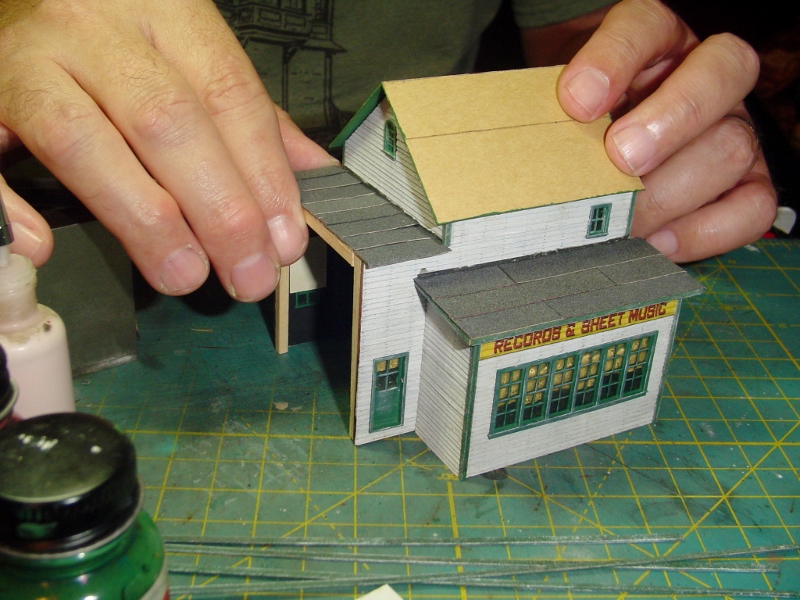

Just a quick little update.  I try to make the roofs removable so I can install the lighting and access it for future repairs if necessary.  I have a sheet of black mounting board I picked up an art supply store I use for such things.  I cut two triangles out that match the pitch of the end walls and glue them to the cardstock roof so they'll fit just inside the bracing on the end walls and keep the roof centered.
Here's the roof temporarily in place.  Because of the large WKLO sign that spans both structures I'll probably end up gluing both roofs in place when the lighting is complete but I'll use very little glue.  That way they can still be removed, if need be.

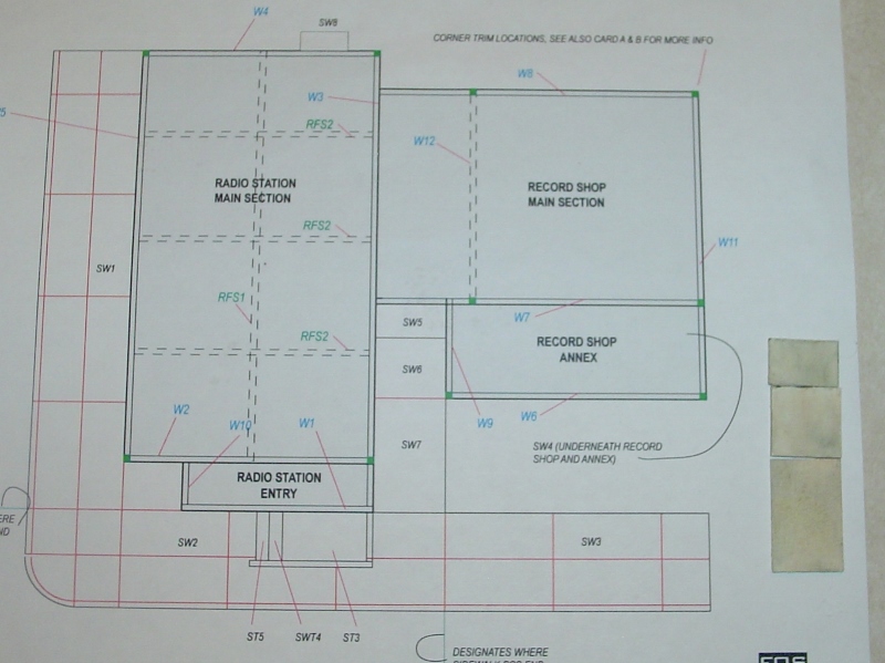

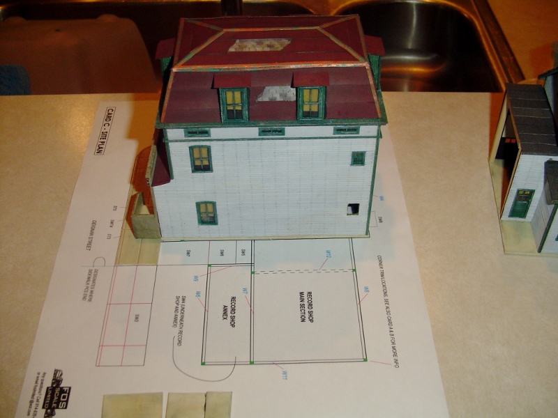

Sometimes you run into some little challenges with a build.  There were a couple I ran into with this one.  Nothing insurmountable however.  There's a template, printed to correct size, that shows the placement of the structures and the sidewalks.  Notice the three pieces of sidewalk to the right.  They're the pieces (SW5, SW6 & SW7) that lead into the entryway of the music store.  Two of them aren't the same size as shown on the template.
Furthermore if the music store is positioned where the template shows it will half cover the two window openings at the rear of the radio station structure.  Now, the lower window opening is a story in itself.  Either a) the kit was missing a window or b) the kit came with a bonus window opening.   ;D  The best I can tell it's b.  I don't see a window there in the pictures of the structure in the instructions.  Not a bog deal though.  I have a pack of assorted windows from Tichy and I'm sure I can find a match for the upper window.  If not, a boarded up window at the rear of the structure would go unnoticed.

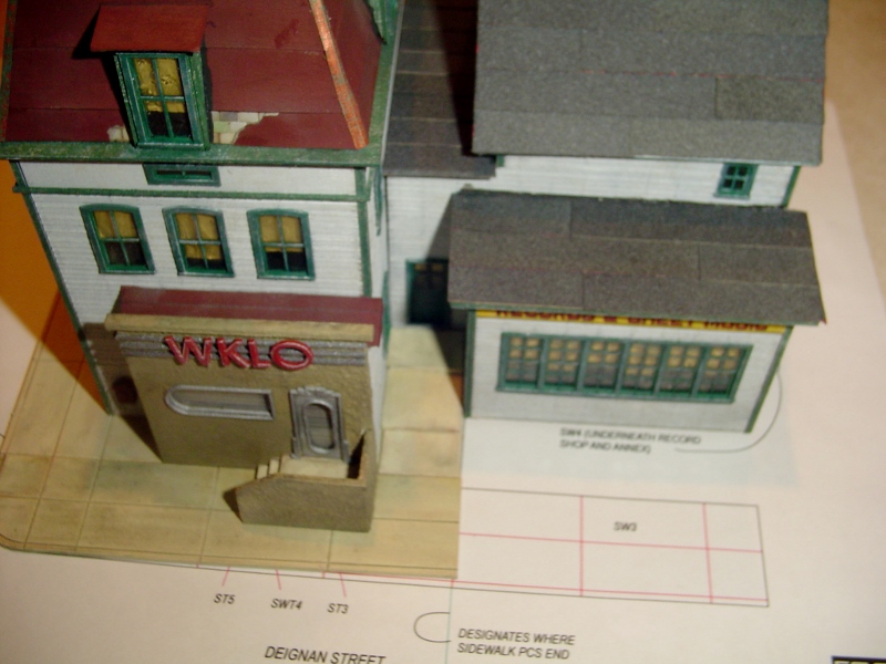

First I have to solve the mystery of the windows being half covered by the music store.  This is the placement per the template.  That's not going to cut it.

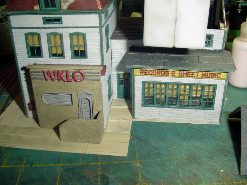

I found that if I put SW6 where the template shows SW5, then glued put the music store in place butted up against SW6, that SW5 and SW7 could be stacked one on top of the other to make a set of steps that elevated the sidewalk up to the level of the entrance to the music store.
More in a moment... ;)
Nothing has been glued down yet but by rearranging the sidewalk pieces as I had previously described the windows in the rear won't be half covered by the music store.
This matches the position of the music store in the photo's in the instructions.
