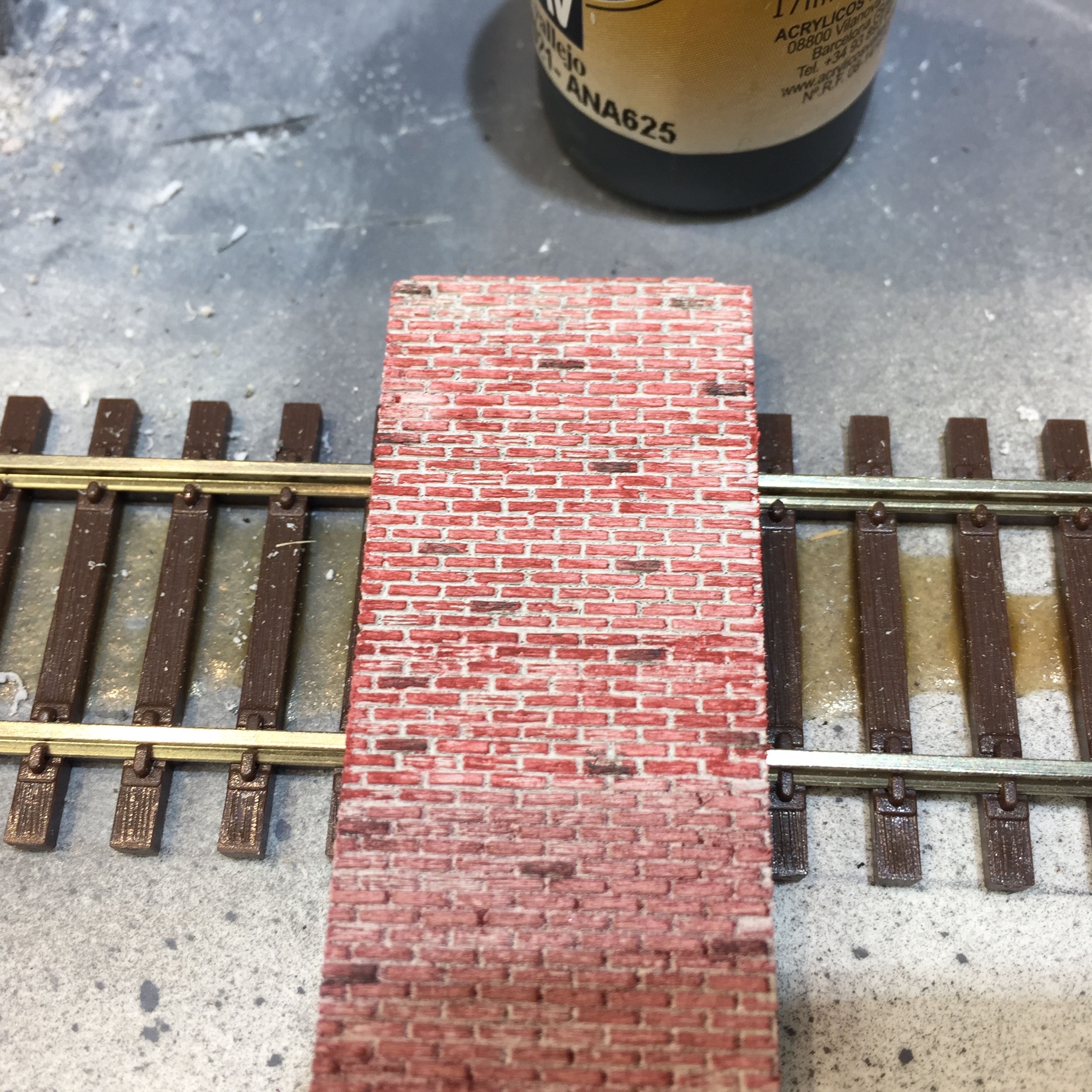

For round 2, after many attempts at trying to add mortar using the traditional final application with both chalk and paint, I decided to add the mortar first by paint the sample with grey primer acrylic primer first.
I then added the tradition brick red - with acrylic paint and a sponge on the top and pan pastels on the bottom.
Here is a closer look after I added the dark gray accent bricks.
A little closer look.  My conclusions - acrylic paints work well.  Pan pastels - I'm still looking for a technique on wood.
I think adding additional colors with the brush could be achieved very easily.
I like the grey spray undercoat to show mortar better than using a wash of bragdon weathering powder and 91% alcohol that's recommended in the instructions.

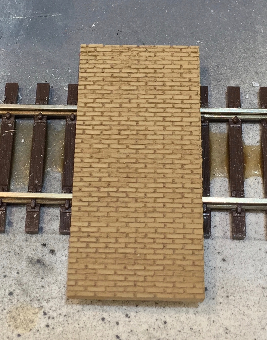

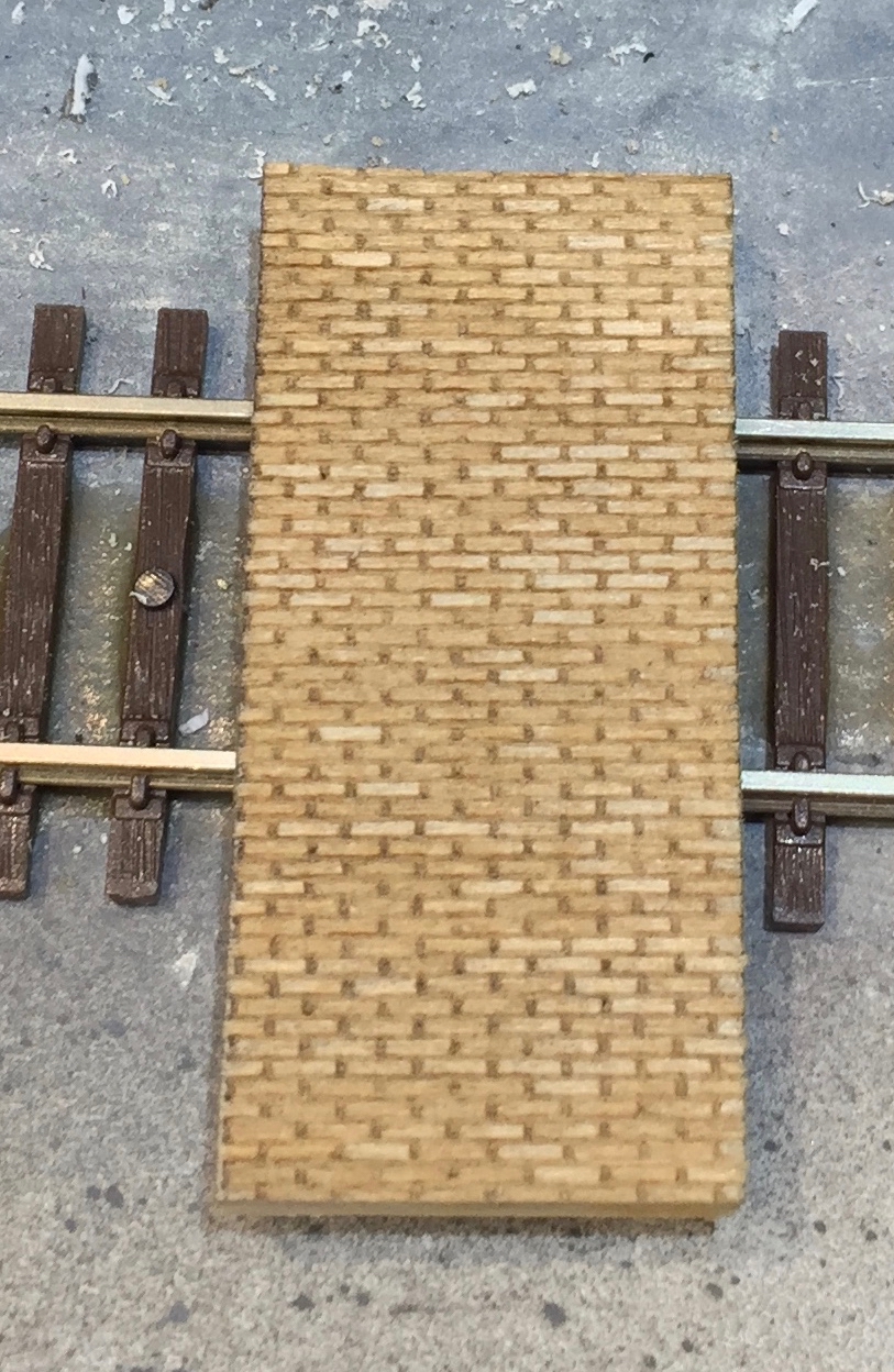

I made three test samples to test the technique for the multi colored brick.  Sample number 6 was primed with Sand color Camo paint.
Sample Number 8 received a coat of 2 tsp. A&I to start the process. In round 1 I used 3 tsp A&I which made it a little to dark to start.
Sample 9 started the process with a coat of the Acrylic grey primer. This is the same base that I started with on Sample 7 which is the brick red sample.
The following Series of pictures takes us through the process of adding each color starting with the Flat Earth (brown) applied on individual bricks using a 3/0 brush. Sample 10 will be used for another test with a dark brown single color brick using the same technique that was used for the red brick.
