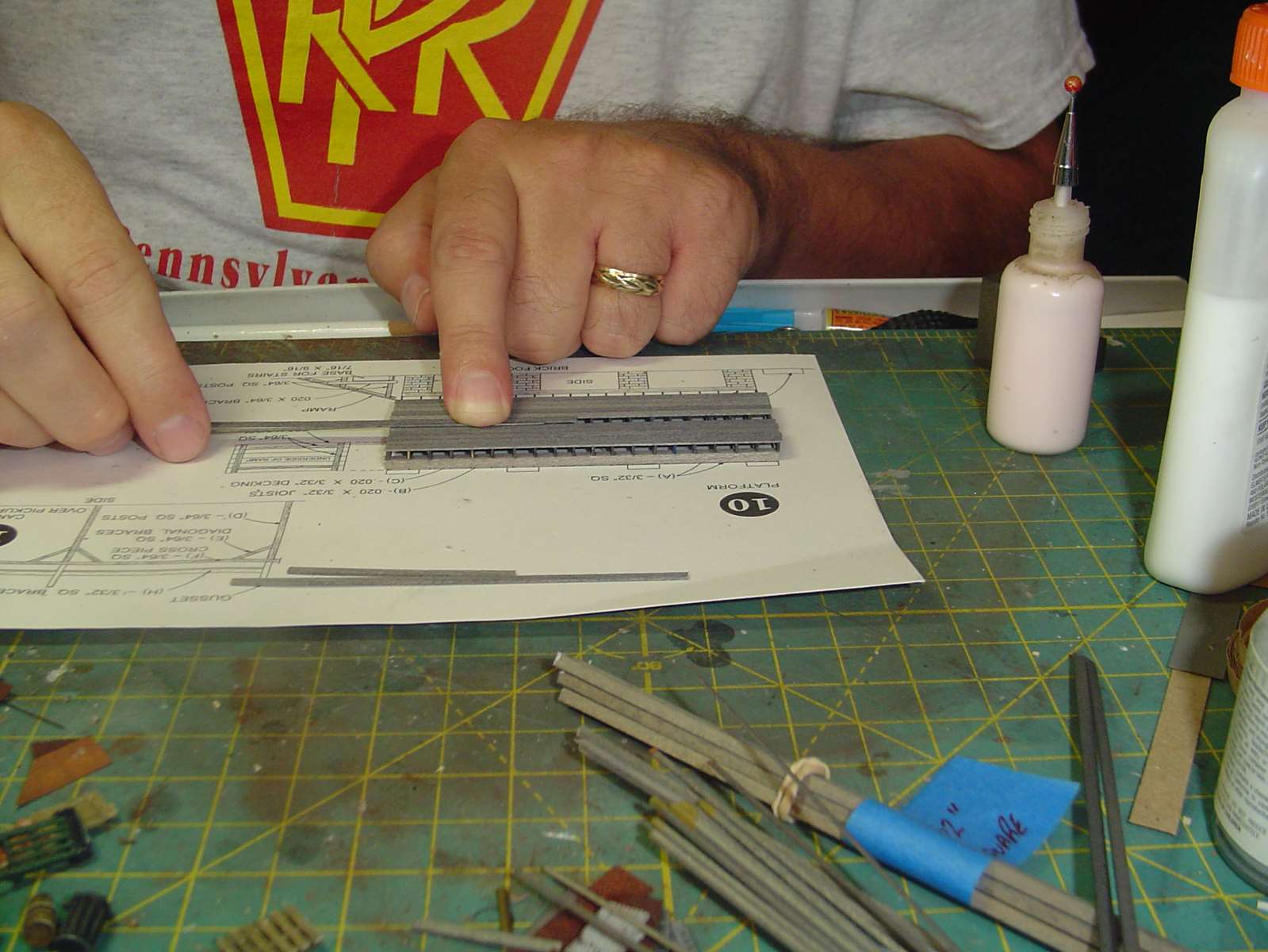

I use my NWSL Chopper whenever possible to get pieces of a consistent length.  It was time to start working on the small porch that will be attached to the rear of the structure.
This was another case of building things directly on the template.  Again, only the tiniest spec of white glue was used to glue pieces to the template.  Like half the size of a pin head only smaller.   ;D
After building the platform I glued it in place and held it there with until the glue set.  Then I ripped it off and did it again since I didn't get it straight the first time.   :-[  After the glue set the corner posts, railings, stairs, etc. were all attached.  That was a bit tedious and not very photogenic.   ;)
