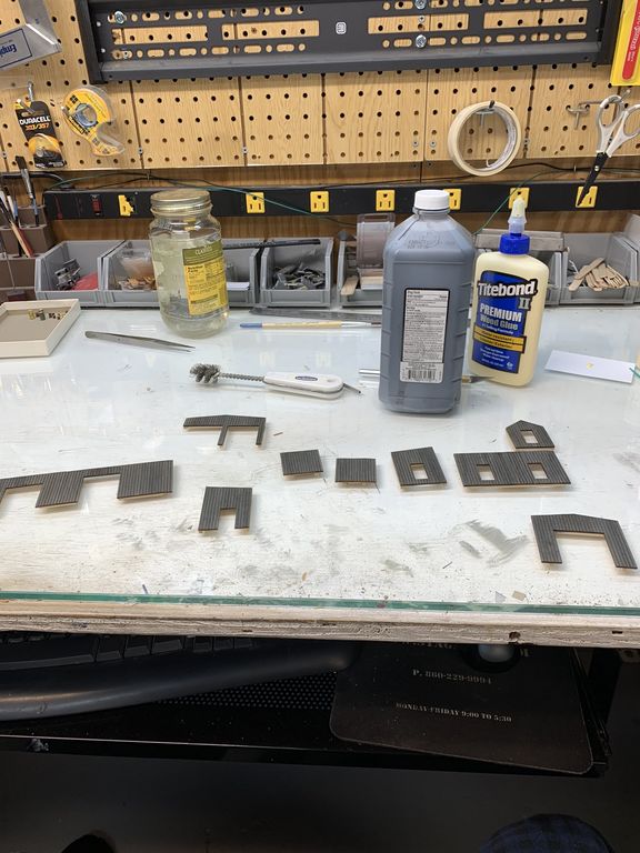

I finished up a few of the castings. I still have a whole bunch to go. I'm trying to work through them as the different stages of the structures are drying. I still have a ton to get through.

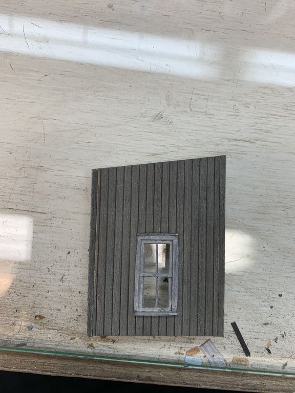

I painted the walls with Apple Barrel Slate Gray. I added some heavy graining to the boards and a few board ends. I tried not to overdo it with the board ends. The walls were first primed with A&I followed by a wash of Mineral Spirits then a coat of the paint before the Mineral Spirits fully dry. After the paint dried for a few minutes I went over all the walls following the direction of the wood panels with a heavy wire brush.
All the walls are colored.

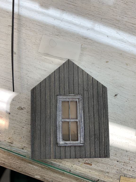

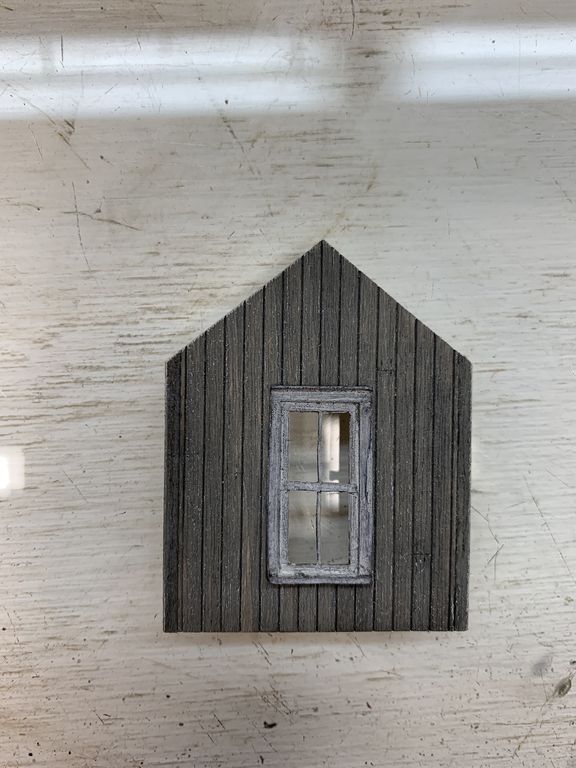

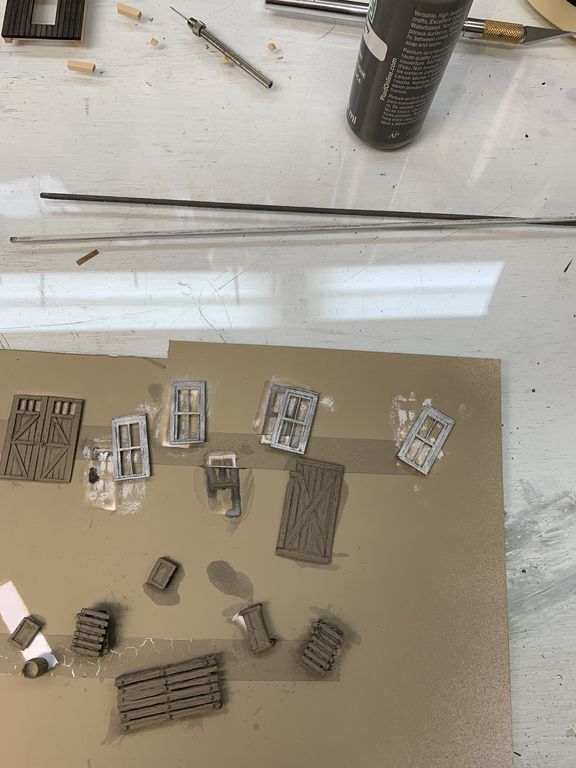

I painted the windows with Vintage White craft paint. I waited to color the doors because I wanted to see how the windows looked against the wall color.
I tried to do a spotty job painting the windows to give a little peeling paint effect. After the white paint dried I washed over the windows with A&I.

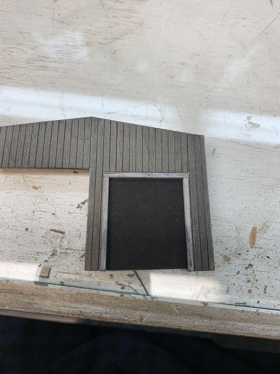

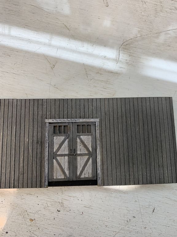

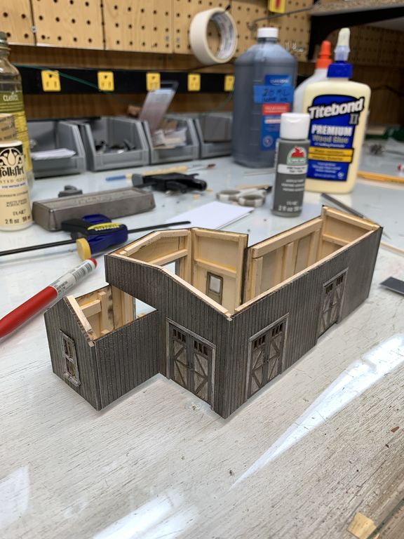

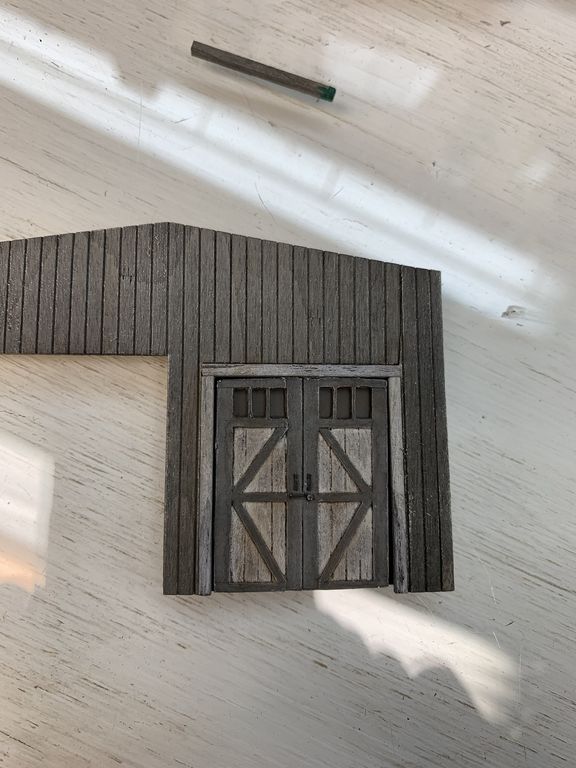

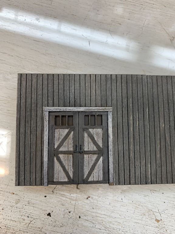

The fitment of the doors really left something to be desired. Big gaps on all sides. This was the worst one. My work around to mask this was to glue the doors to pieces of blacked painted chipboard. Should be less noticeable this way.
This is the chipboard in place. I glued the doors directly to it.
The other 2 freight doors are not as bad. I still glued chipboard behind them.
This door has a large gap under it. This is by design because a wood/tire bumper will sit here. I think it looks kinda weird having 2 doors next to each other with one sitting a few scale feet higher than the other.

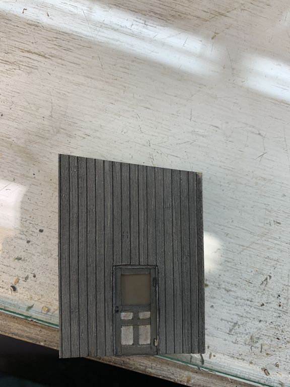

This door was designed very strangely. The instructions call for framed out the opening with scale 6x6s and setting the door against the back. Following that direction the hinges and door knob would be covered by the framing. I instead chose to glue the door directly in the opening and I'll frame it out with 2x4s on the outside.
I felt like this looked better.

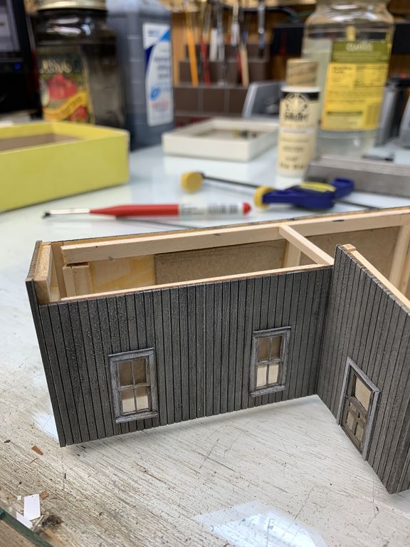

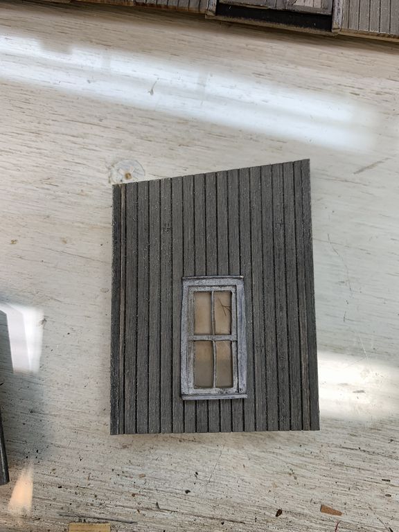

I added the acetate for the windows, dirtied it with some chalks and added some blinds.

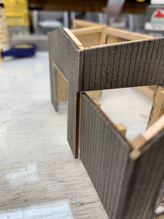

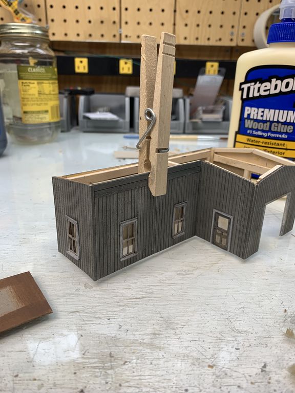

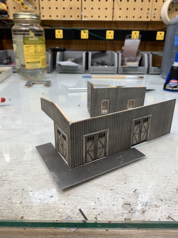

I started gluing the walls together. I normally would detail them a bit more before doing this but I really wanted to get a feel for how the building sits when all together.
The front wall is about 1 scale foot lower on the right than on the left. I had a large gap in the top of the siding where the wall meets the corner on the right side. My fix for this was to bring the bottom up a bit to make it less obvious. It'll be easier to mask a gap once I add the foundation and the scenery on the bottom.
The little 3 wall section on the left is suppost to fit in the hole in the siding. It's way off. I have about 6" too much space. It's not glued in place but I'll need to figure out how to hide that.

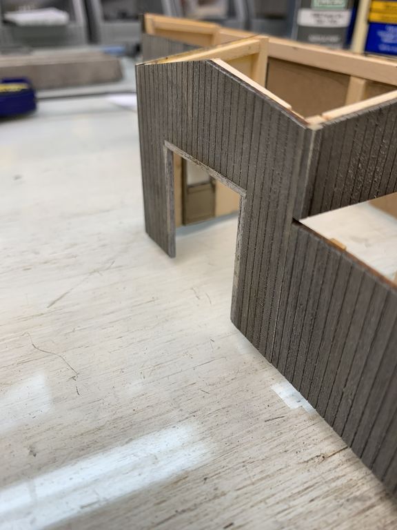

This is the issue I had with the smaller building not fitting properly into the opening. I have about a scale 6' gap between the wall and the corner.
If I move it over to fill the gap it opens up on the other side.
This is what the other side looks like now. I'm not sure why they didn't just make the siding run the full length of the wall so you could just butt the little addition to it.

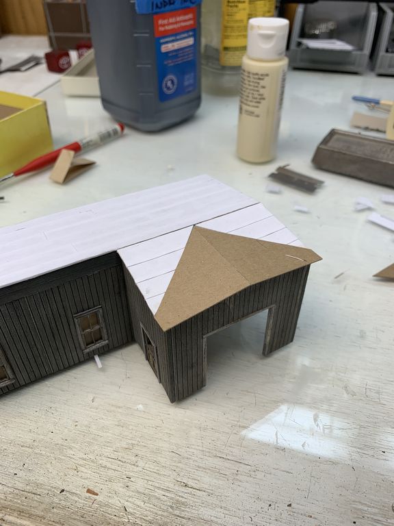

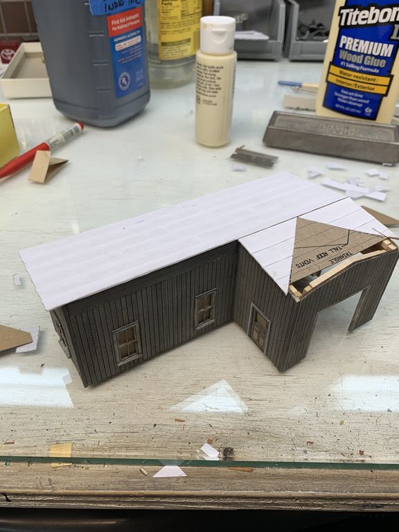

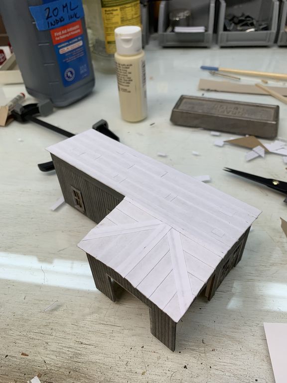

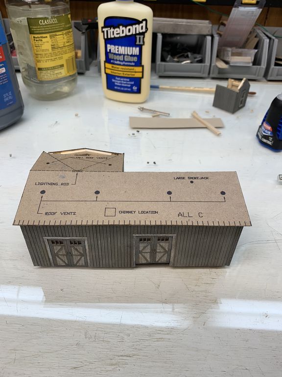

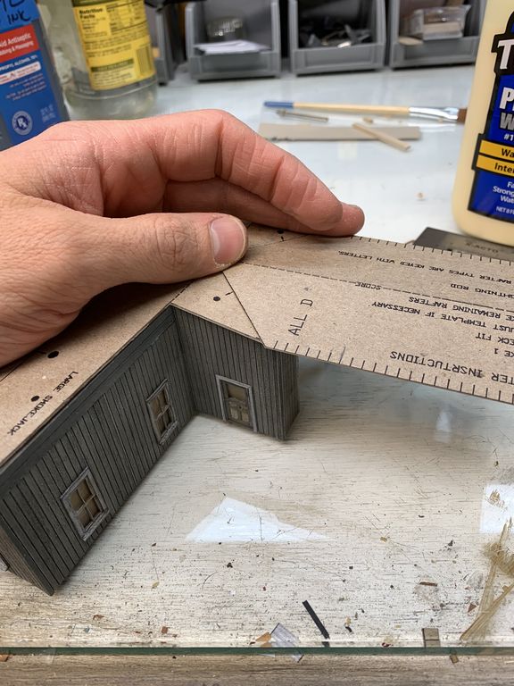

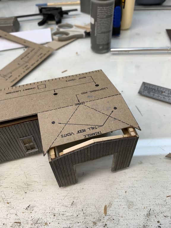

I got the roof cards cut out so I can map out how everything will fit. The rear wall has a small peaked section that is blocking the card from sitting properly. This is due to the extra bracing I added to the wall. If I had not braced it the card would fit behind the peaked wall.
I cut a little notch out of the card so it fits properly. The dotted lines going towards the front of the vehicle are not for cutting. They are to let you know where not to add roofing so the other roof card fits properly.
They really want you to add a lot of vents and chimneys to this small building. 7 total. They are very specific about placement of these pieces but the roof card has no horizontal lines to help make sure you apply the roofing straight.

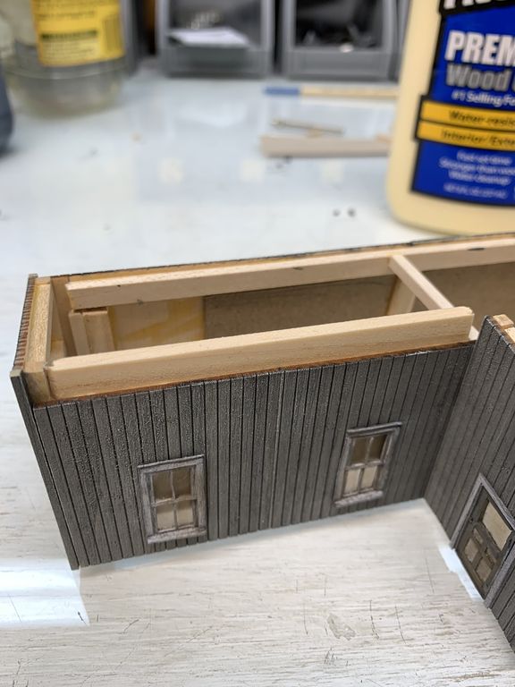

I spent some time trying to figure out what to do with this area at the top of the rear wall. This spot will not be visible when the building is installed on the layout so I decided to go with a quick fix. If it was visible I think I would take the wall down and redo it so it runs the full length. I added this cross support bracing so I had something tangible to glue the siding to.
I used a piece of scrap siding to plug the void. This is the bottom wall of the little office that sits on the barge on the old original FSM pile driver. I cut it lengthwise and it fit perfectly in the spot.
It will be hardly noticeable once the roofing is on and not visible at all once the building is installed on the layout.
I spent some time trying to get a feel for the rear overhang area. The roof card doesnt line up correctly with the marking on the main roof. If I match everything up I have about 1/8" on either side of the card overhang. I need to modify this area heavily so that the depth of the building fits my spot. I won't be building the loading dock here, it will not fit.

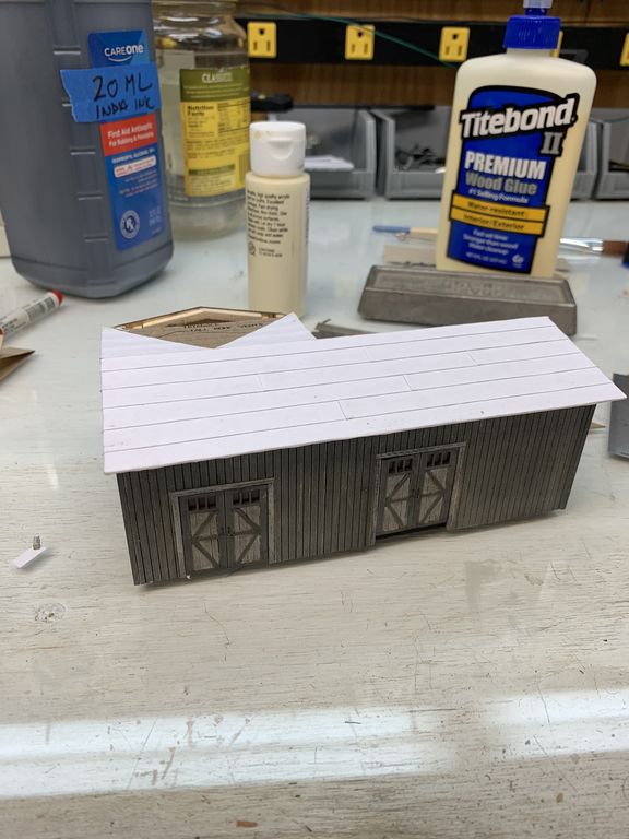

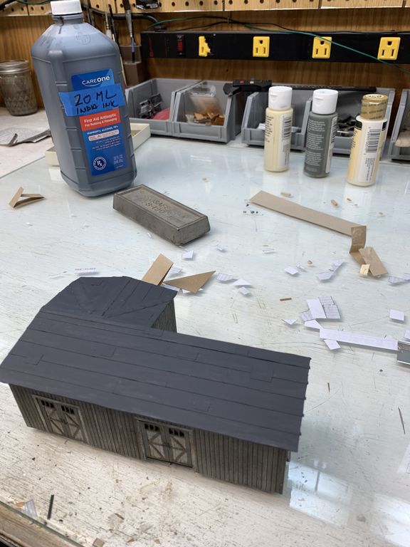

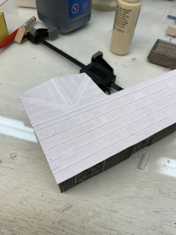

I got the rolled roofing laid out across the main roof.
I cut out my own roof card for the rear section. I took most of the overhang off the rear and I make it less wide so it matches the width of the main roof.
It took some trial and error but I got all the roofing covered.

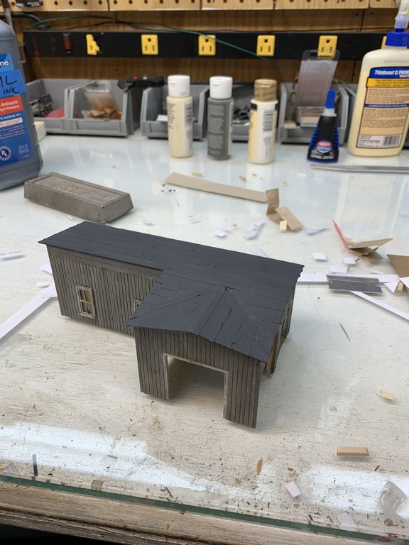

First coat of paint on the roof is on. I used Apple Barrel Pavement to color the roof. It's similar to Floquil Weathered Black. I still need another coat and of course quite a bit of weathering.
Next step will be weathering the roof and adding all the rafters. Then on the the loading docks and stone foundation.
