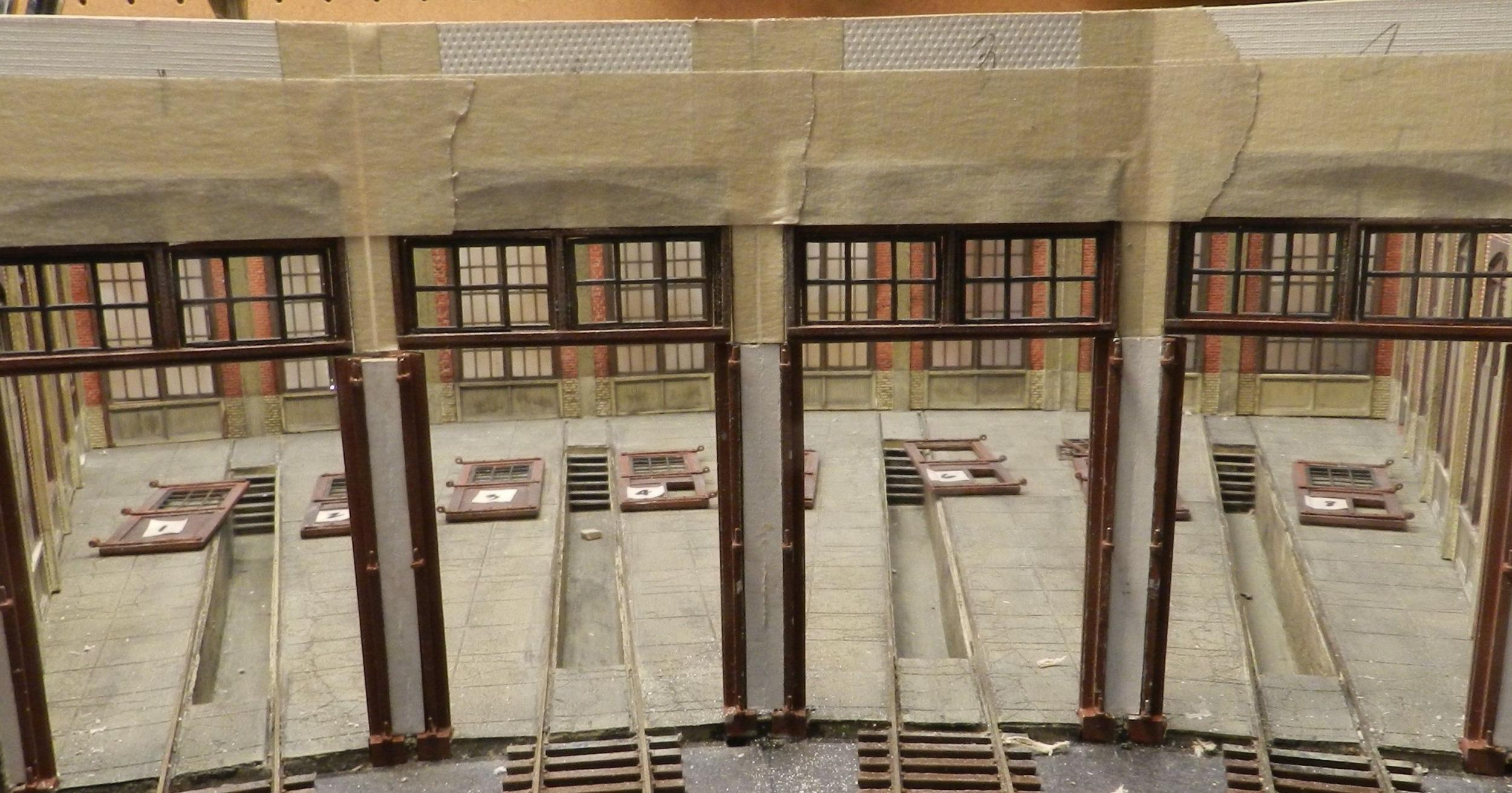

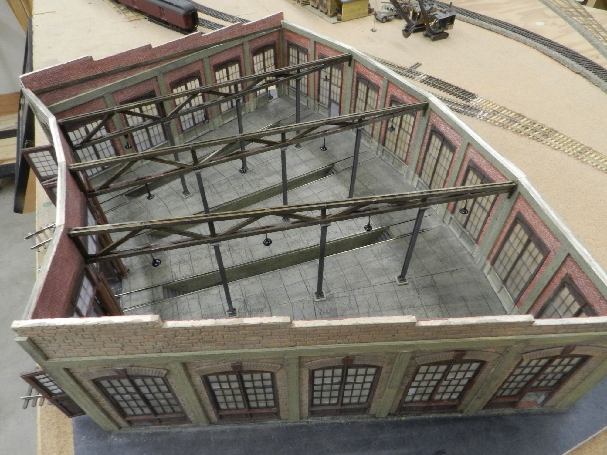

Since my last post, I have been assembling the front of the roundhouse.  Because of all the angles and dangles, I decided to build this wall in place because of all the cutting and fitting required.  The directions did suggest the all the walls should be built in place.  But I decided to prefab the side and back walls and put them in place.  Otherwise, this would have been a mess.  But this was the only way to do the front wall.
So, I first set the metal castings for the door post and hinges.

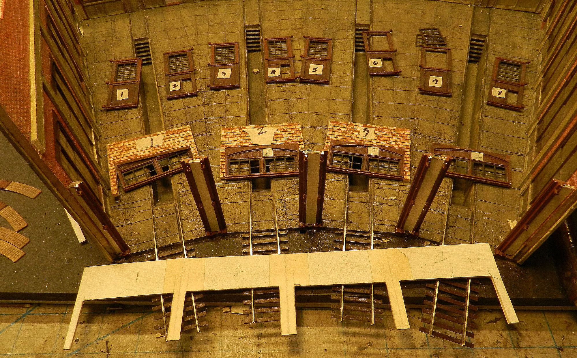

Then I built a mock-up of the wall above the doors to develop patterns for the wall sections.
Below is a picture of all the different pieces.

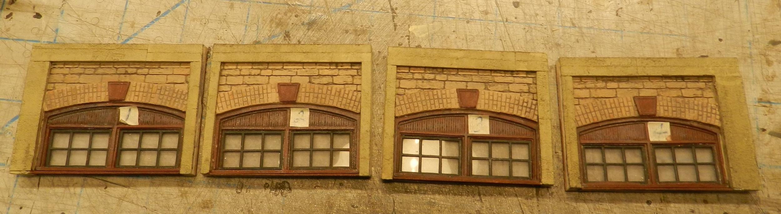

And then the fabricated wall sections that go above the doors.

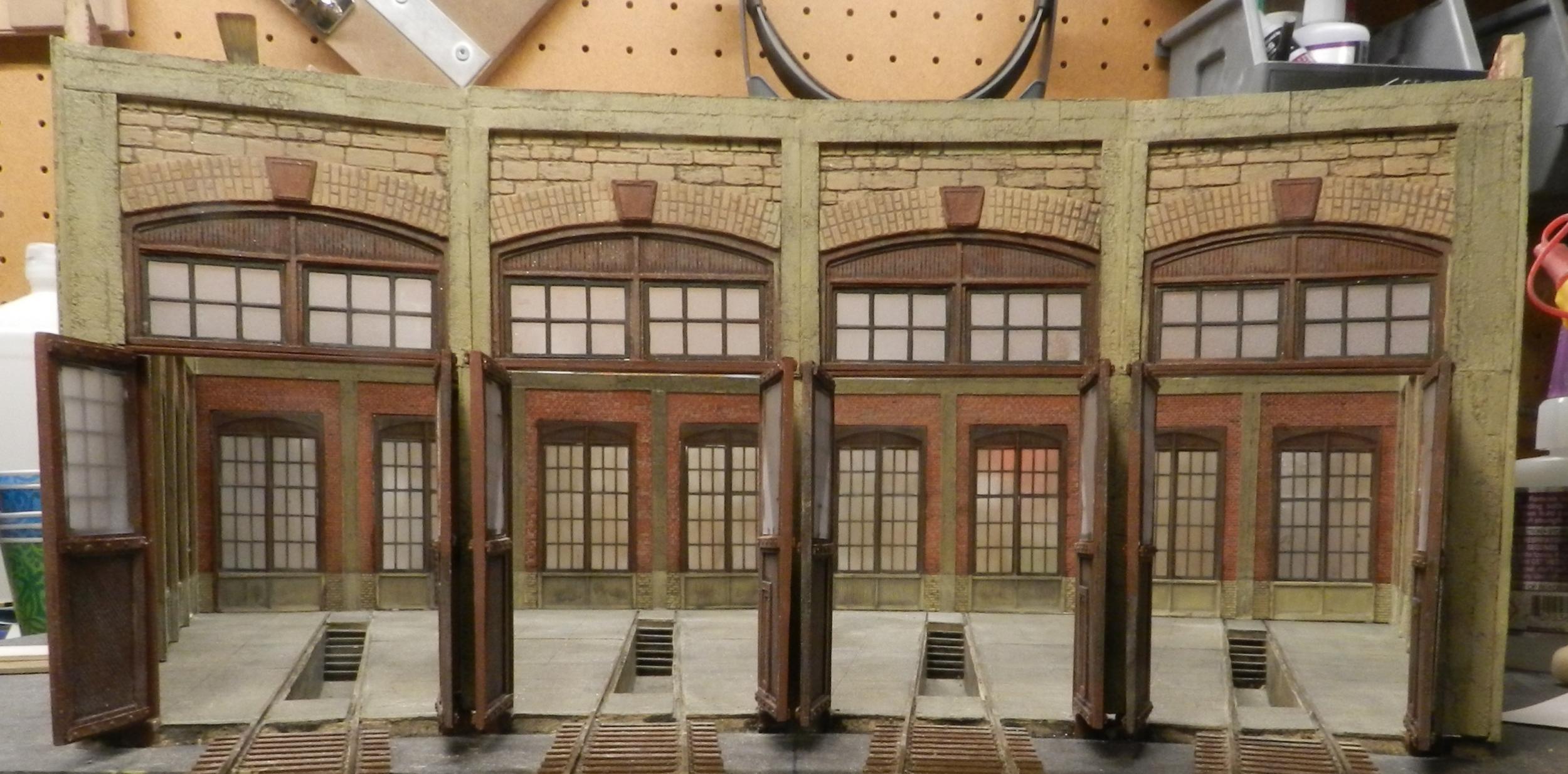

And here is the results.

Absolutely fantastic. It sure doesn't look like an SS LTD. kit with you at the bench. Fantastic job, extremely well done.
sdrees
Thanks Tom, remember that I used Monster Works stone and brick materials instead of that supplied with the kit.  It sure makes a difference.

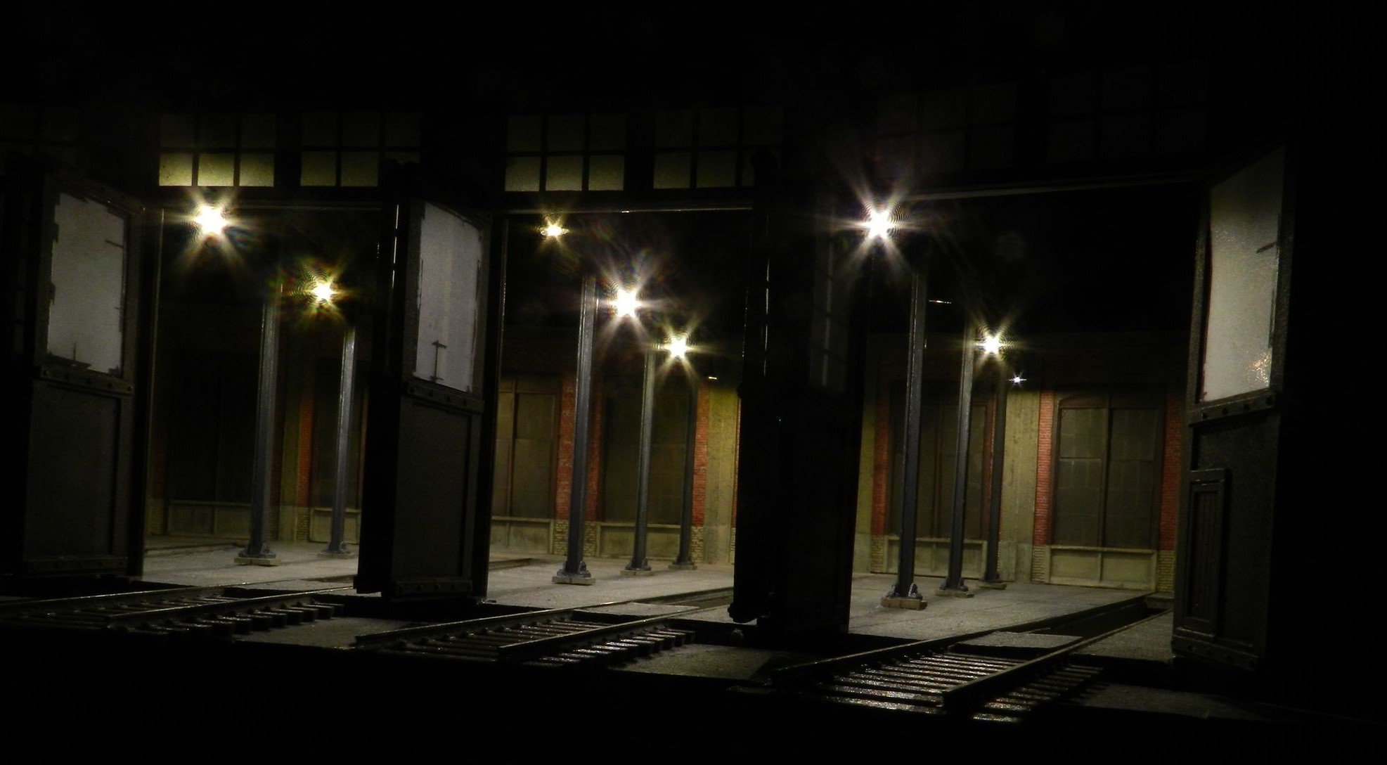

I finally fabricated and installed the roof trusses and lights.  The wiring for the lights runs on top of the bottom chord of the roof trusses.

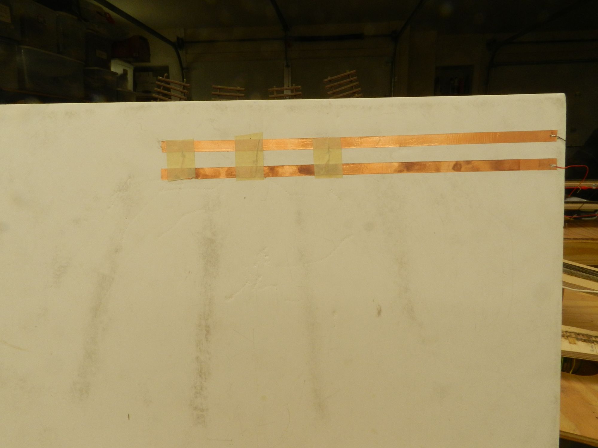

I then ran the wires thru a conduit to the underside of the roundhouse base.
Then, I ran some copper tape across the bottom of the roundhouse where the wires from the different stalls are soldered and then for my permanent installation on the layout, I will use a buck converter that gets power from the layout bus wires and its output will be 3 volts.  So I will not need to use bridge rectifiers or resistors in my circuits.  For temporary power, I have a 3 volt power source.  The lights are wired in parallel.
Now let there be light.
