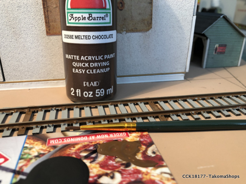

I didn't want to use Floquil Rail Brown for the the track so instead I went with "Melted Chocolate" from Apple Barrel. I was at Walmart and they had the Apple Barrel paints 2 for $1.00. I mean, how can you go wrong with that!?
I painted a few random ties with the Melted Chocolate to add some variety. I need to weather the ties and put down some ballast after my hobby shop run.

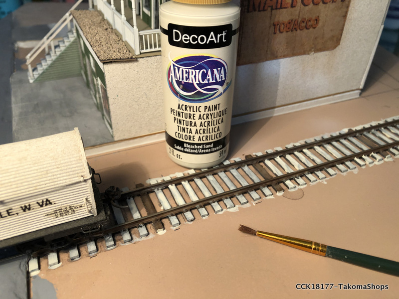

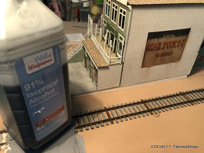

Moving on with the track... for now.

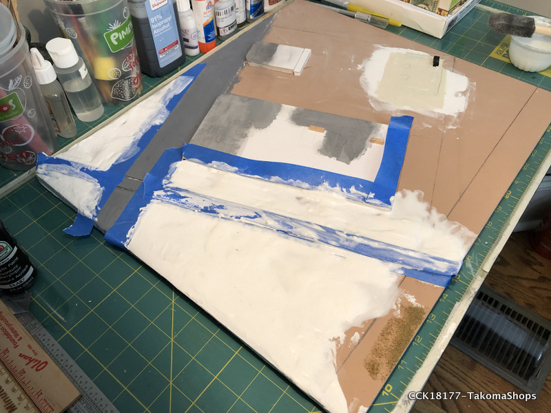

I applied an alcohol and India ink wash on the ties to tone down the color.
I then painted each individual tie with Americana Bleached Sand acrylic paint.
I then applied some of the DAP CrackShot (I found some at my local Ace Hardware) to build up the scenery base.
This stuff takes at least one whole day to dry. So I moved on to the roof over the main building's balcony while all that dried.
More coming up.

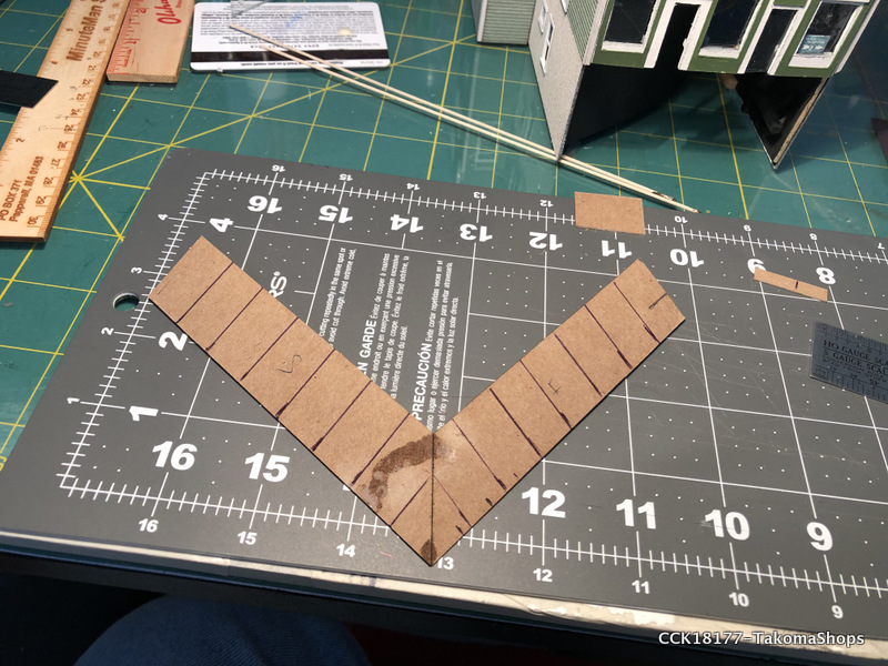

Ok, here is the process I took to arrive at where I ended up.

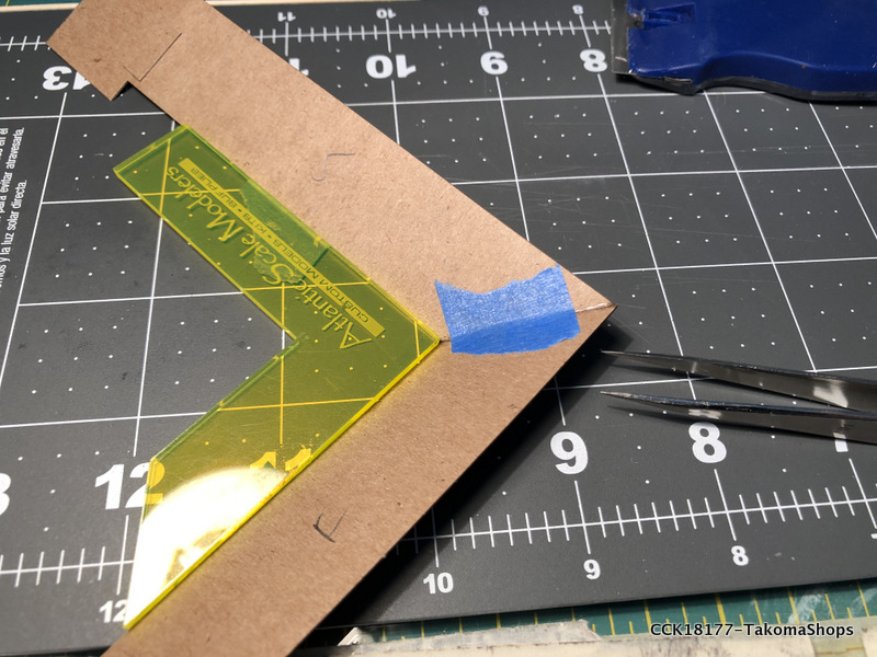

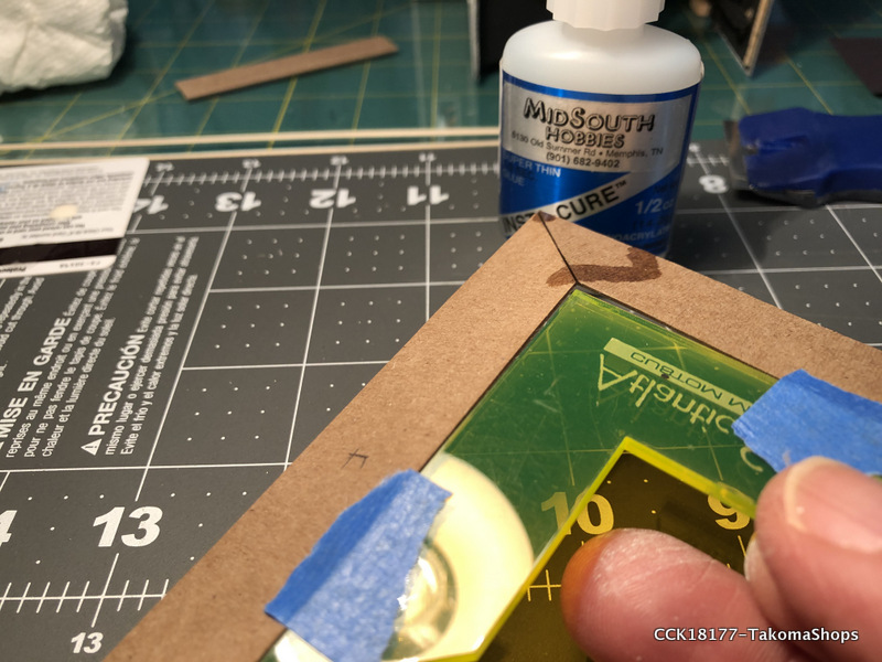

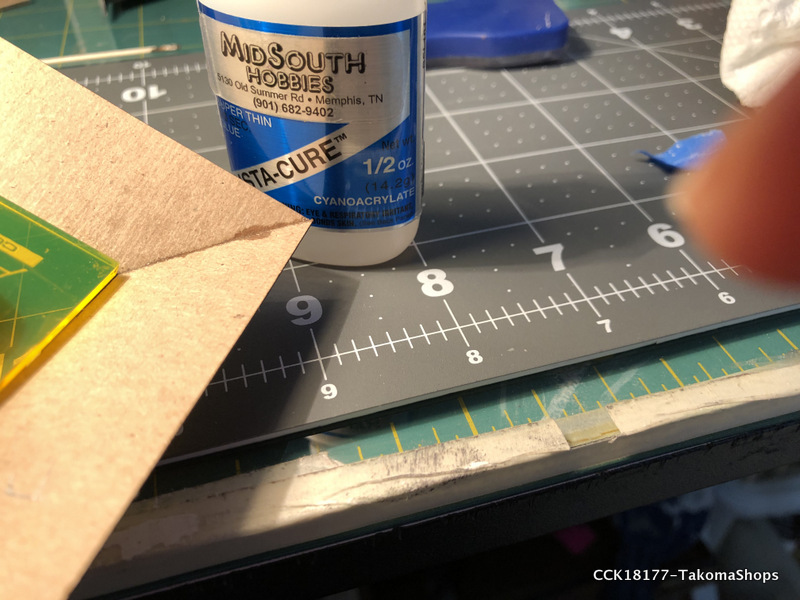

I glued the two halves of the roof using a square as an aid. I basically taped the roof halves to the square and used really thin CA glue to glue the halves where they meet at a right angle.
In my exhuberance to glue the thing I spilled really thin CA glue all over the place. Let's just say I was not happy from that point forward.

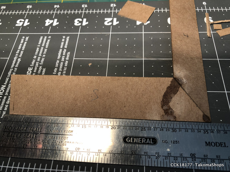

Anyway, this is what it looked like from the underside.
Not too shabby, for now....
And when I went to apply glue on the opposite side it's when it started to go downhill.
I hate CA glue. Who knows why I use it?!

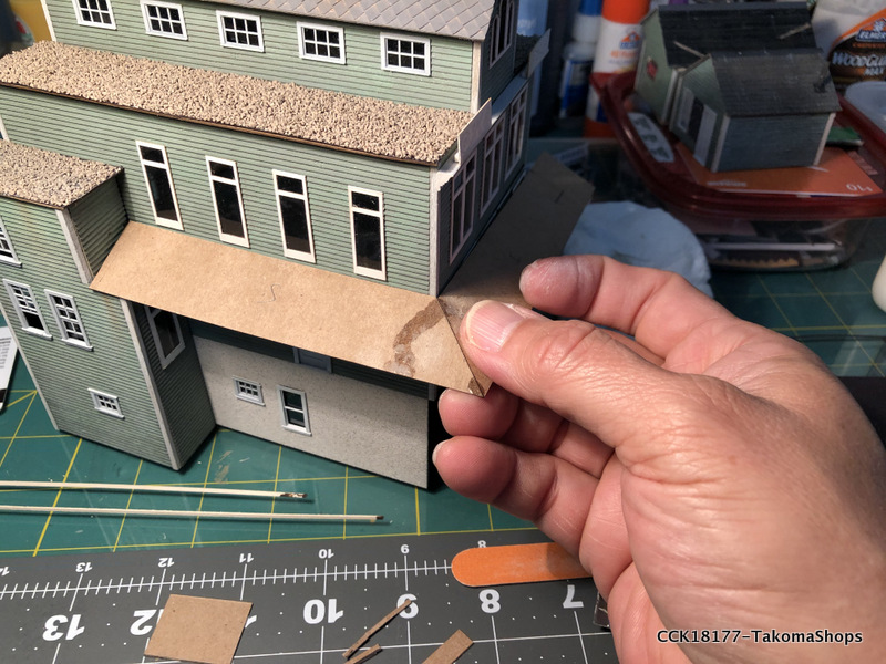

I tested to see how it would fit on the building.
Looking suitable at this point.

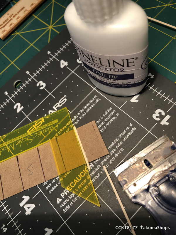

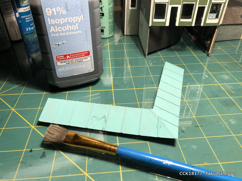

At this point I needed to measure out how to add the "battens" on the roof that simulate the metal roofing raised ribs.
So I made me a cheater spacer (top right of next photo) and marked the spots with an ink pen.
I glued the "battens" with white glue.
And when I was all done with that I discovered that the instructions say to space the "battens" 6 scale feet apart. I did mine 4.25 scale feet apart. Oh well. Too late for that. I'm not redoing it  :P .

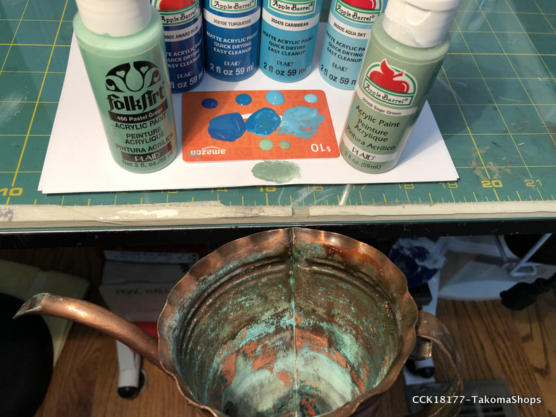

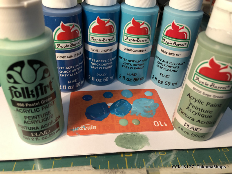

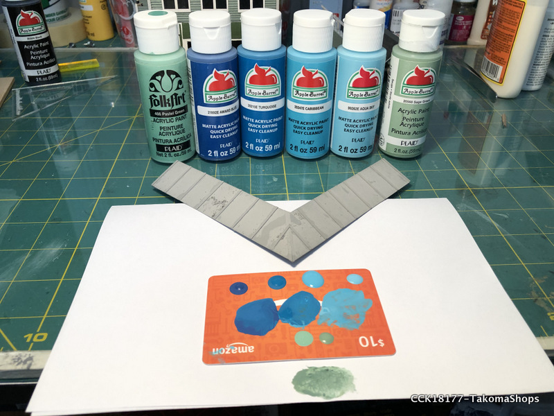

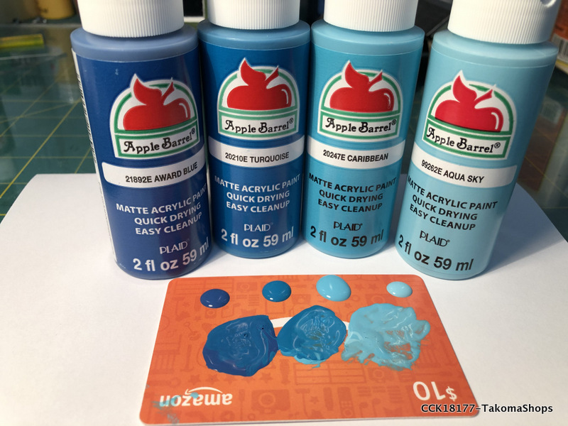

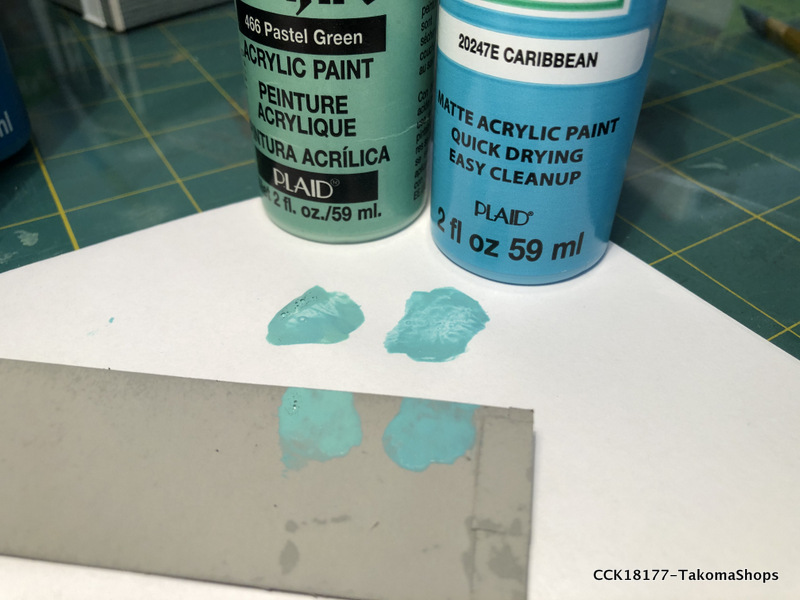

The roof over the balcony is meant to be copper that has aged with a verdigris patina. The instructions say to use American Sea Breeze. I didn't have that. I was at Walmart and they had their Apple Barrel craft paints 2 for $1.00. So I decided to experiment. I mean at 50 cents each for the paints why not...
There you have it. My experiment to approach verdigris patina. Not entirely convincing.
So I tried something else.
It needs some green.
I decided to go with Folk Art Pastel Green and to that add Apple Barrel Caribbean. I mean that sounds like fun.
I asked my wife for her opinion and she handed me a rusty copper pitcher she uses to water her plants.
As you can see I am getting pretty close to a match.
I painted the roof with cheap Walmart grey spray primer once the "battens" were dried.
Keep in mind I am trying to reproduce that green in the rusty pitcher.

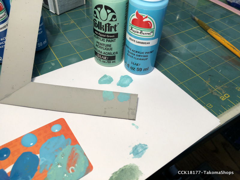

I made a couple of tests on the underside of the roof which was also sprayed with the cheap grey primer.
What do you think? Too bright perhaps.
Well, I had to keep moving on. So I tried on three parts Pastel Green and one part Caribbean.
Wow! That is really bright. I must tone it down and it is too blue. Oh well. Have to keep moving for now so I will live with it.
I applied some alcohol and India ink wash and let it dry overnight.
