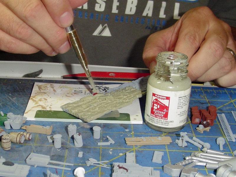

Okay, I have actually been working on this one recently but I've been focusing on painting the detail castings so there's been no "glue on wood" at this point.   :)   I'm going to walk you through the steps I took to paint the stone retaining wall that runs along side the road.  I consider this a happy accident.  I've never been pleased with the results I get when I paint stone walls but I think I lucked out on this one.
This wall is a metal casting and I had previously primed it with Floquil Primer.  The first thing I did was, per the instructions, paint it with Floquil Concrete.

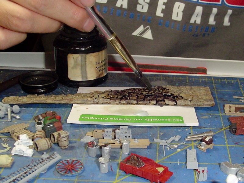

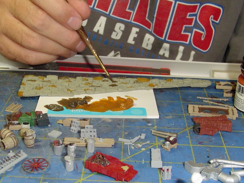

Painting it with Concrete was as far as I went with regards to sticking to the instructions.  The instructions then call for painting some individual stones with Floquil Oak Stain and some with a darker gray after which A&I is applied and then drybrushing.  I opted, however, to paint the individual stones with cheap craft store acrylics: Raw Umber, Burnt Umber and Burnt Sienna.  (If you follow my lead on this don't worry about being too precise painting the stones.  Also, blend the various colors together to create even more shades of reddish browns as you paint the stones).

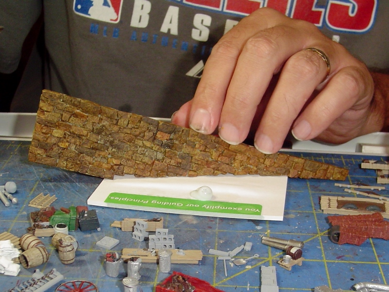

When I finished the wall it was just a little too dark, overall, for my tastes.

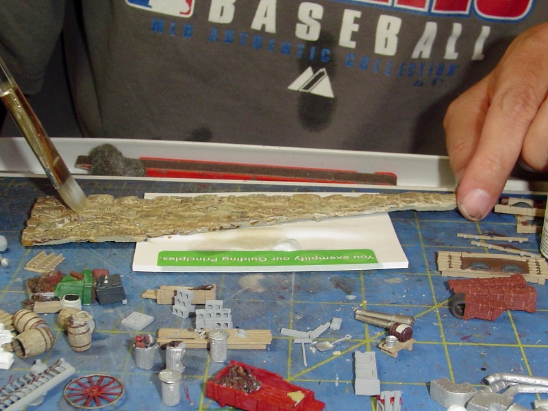

To lighten it up I took another cheap craft store acrylic, a light gray, along with a lot of water to give the wall a "wash".  Partly because I was impatient and did this right after I paint the stones so the paint hadn't fully cured and partly because I used cheap craft store acrylics I discovered that scrubbing the stones a little bit with the wash blended the browns together to a grayish/muddy sort of color and exposed some of the underlying Floquil Concrete.
After the wash dried I gave the wall a treatment of A&I being very careful not to brush the walls.  The A&I will definitely loosen up the acrylic paints.  One nice thing about using cheap arcylics for something like this is if you don't like the result you can wash them off and get back to the underlying Floquil paints with little difficulty.
Here's my final wall after drybrushing with an off white and adding a few bits of coarse turf.  The wash blended the rather harsh browns together but left just a little bit of distinction between the stones.  Some are just a shade darker than others or more reddish than others but all in all I ended up with colors I'm happy with.   :D   I'll probably hit it with Dullcoat to seal the acrylic paints so the water that will inevitably get on it when I'm adding scenery doesn't mess it up.
