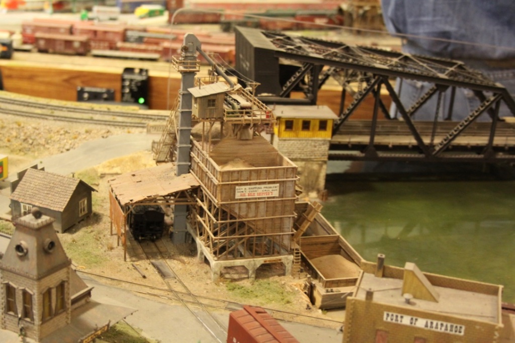

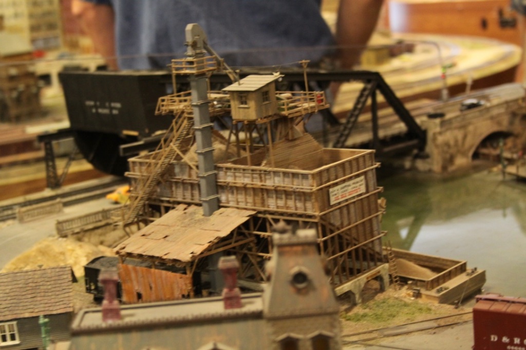

The original rock bunker model was built by Gil Frietag and I photographed it at the Houston Narrow Gauge convention.  George used Gil's model as an inspiration for his kit.
I have a thread in the layouts section of the forum if you want to take a look.
Houston Narrow Gauge Layout Tour
[size=78%]P. 6     Gil Frietag's - Stoney Creek & Western Railroad[/size]
Here is a couple of the pictures of Gil's Rock Bunker.  See page 16 of the thread for more.
http://modelersforum.com/index.php?topic=3391.225
