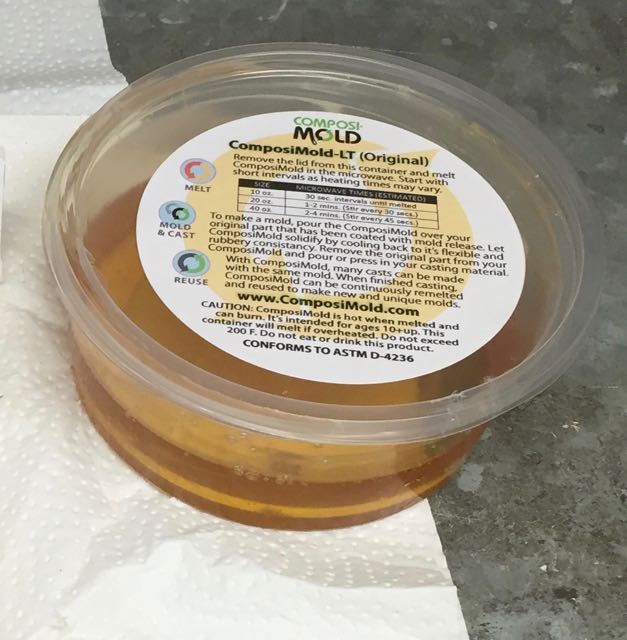

Today's post is a process/product review.  A few months ago I purchased some mold material from MicroMart that you put in the microwave to liquify and pour a mold.  Then  you can remelt the mold and use the material again. Sounds great and a lot cheaper than the traditional mold materials.  I needed a second pier casting for my trestle project that was half the depth as my original so I thought it would be a good time to try this stuff.
Here is a Picture of the top of the container it comes in.

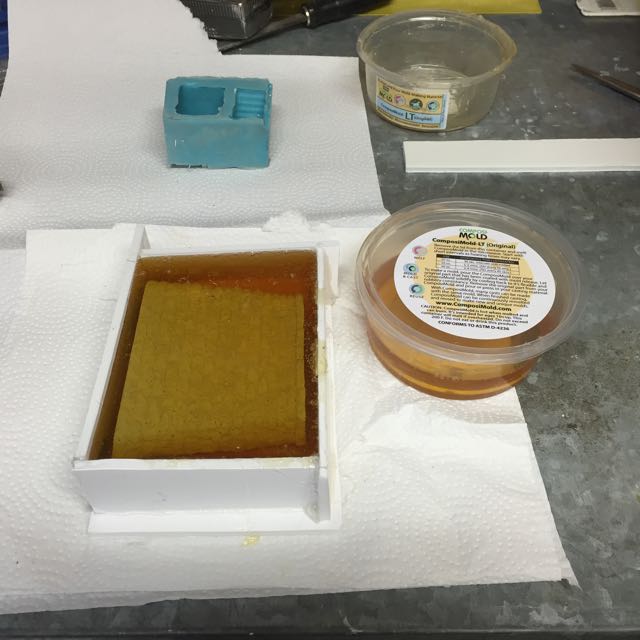

Here is a picture of the mold box with the original pier casting still in the mold.
The traditional latex mold in the background is for a roof detail casting that I need for the warehouse project so while I have the plaster out I'm doing both.  I also always have a couple molds on the bench for future projects just in-case I have to much plaster in a batch and want to use it up for useful castings.  I hate wasting this stuff.

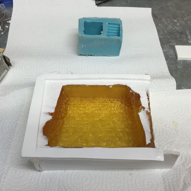

This is a picture of the mold after the original is removed.  I left the mold box around it just in-case it need more support.  I removed the original casting by cutting the bottom out of the mold box.
I should point out that the artist board that I used really sticks to this material.  I have never had that problem with the traditional mold materials.

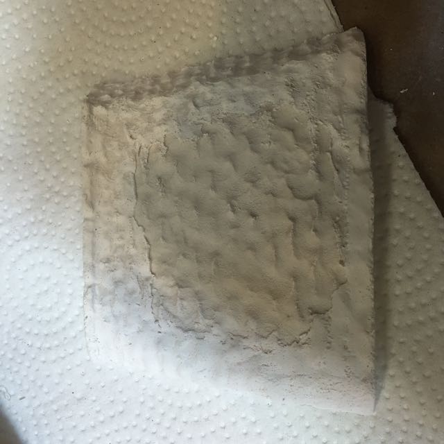

So here is a picture of the first casting out of the mold. Not bad for a quick mold job and it will work fine for my project.   I noticed that the plaster tended to stick to the mold material but quickly washed out the mold and poured a second casting.  I always make two - just in case one decides to find the floor.
So it's when I removed the second casting from the mold that I discovered the problem.  All the detail was gone.  It turns out that the heat that is generated by the plaster curing process is enough to melt the mold material. I also lost detail by washing the mold out but it had to be done to make a second casting.

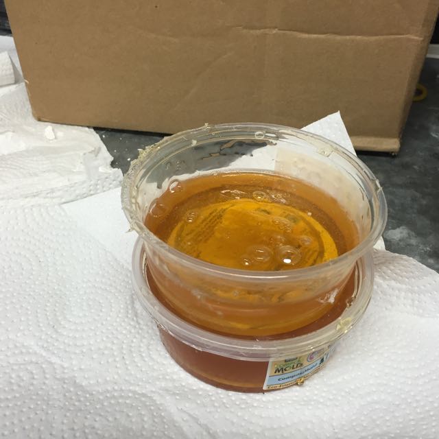

One final picture - I broke up the mold and put it back in the microwave to get ready for the next time I try to use it. Here is the after pictures of the material back in the original containers.
I lost about half of one container washing the stuff getting the paper off from the artist board. It was melting with warm water.

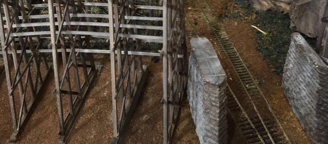

Finally for tonight, here are the piers painted and installed on the layout.  They will support a wood deck that will support the trestle bents over the lower tracks.  I decided to have the piers parallel the lower tracks and the trestle bents will be at an angle to complete the curve of the upper track.

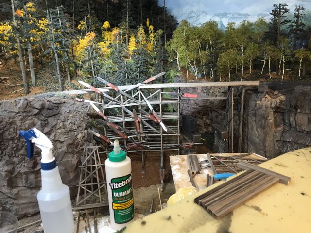

Today, I got back on the trestle build - added more cross-bracing and started building the wood deck for the span across the lower tracks.
