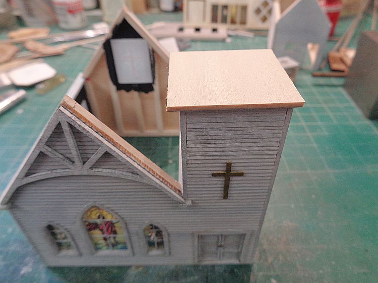

I assembled the four walls of the upper steeple walls together. I used small weights, actually the inside of them, to hold it square until the glue dried.
Continued  -
These walls are small and delicate so I decided to add more bracing. I glued four short pieces of 6X6 scale lumber to the inside of each corner.
It's always a good thing to have it all on the level. I certainly don't want the top spire to look or be crocked.

I cut out the large piece of the large platform section. This piece fits on top of the four steeple walls.
Since I changed the steeple walls, I knew this wouldn't fit properly as shown below.
I measured the width of the heavy cardstock and found it to be 1/16 thick.
I searched through my extra lumber stash and found some plain 1/16 wood.
I used a metal ruler to ensure the white piece was flush with the bottom and left side of the plain lumber. I then marked the top and right side as shown.
I used a square to mark the top and right side lines.
Continued -
Now that I have a piece with the corners squared, the piece is way to big for the steeple walls.
I started cutting off 1/16" on each side. Fortunately the portion (1/16) on each side gave me a better fit and one that looks appropriate.
I wasn't sure how the paint or stain would take to the sides. I used scale 1x6s and glued them to the sides of the large and smaller steeple platforms.
