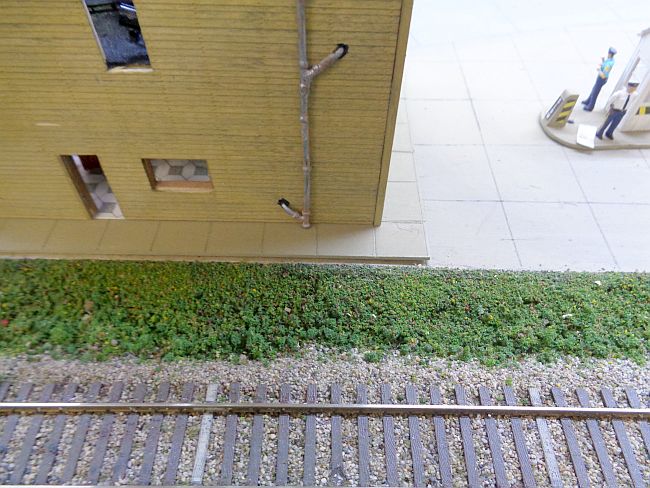

Nice update Tom.  Those pipes look great.
Gutters & pipes are often forgotten on our models.  These are a really nice feature on your building.
Regards  Rob
Melbourne,  Australia
This is going to look great once it's in its new home on the layout!  8)
Quote from: deemery on February 23, 2025, 05:54:29 PMLots of good tips and techniques in this last 2 pages, Tom.  Too bad those Chooch pipes aren't made any more.  The fact that you can bend them a bit helps with installation.  (They'd be an easy 3D printing project, I would think....)
Thank you. Yes, it is to bad that the pipes are no longer available. I guess one could scratch build some but the angles would be difficult.
Easy for a 3D printer if you know what your doing. I don't with the 3D that is.

Quote from: robert goslin on February 24, 2025, 04:45:09 AMNice update Tom.  Those pipes look great.
Rob,
Thank you sir. I have other details to add as well. I'm working on an idea for gutters.

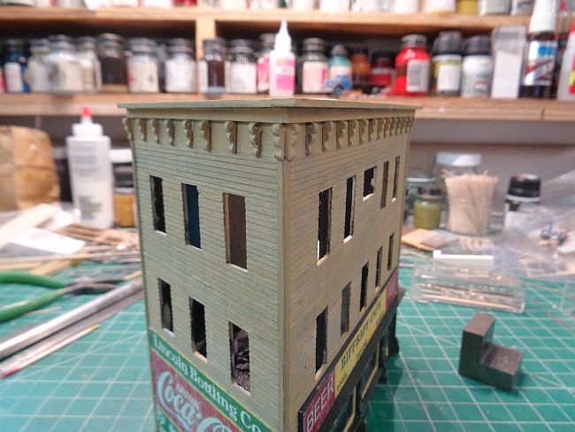

Before I add another update, I forgot to add this from yesterday.

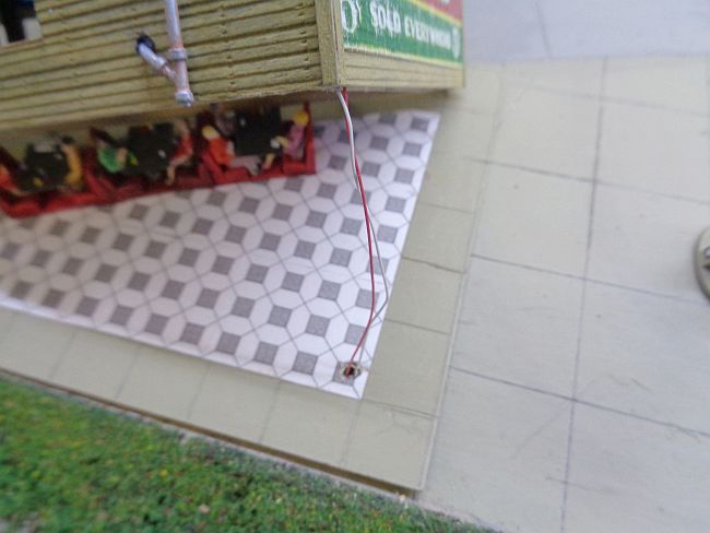

I wanted to show how easy it is to put the falt iron on the base with the light wires. No narrative is necessary here.

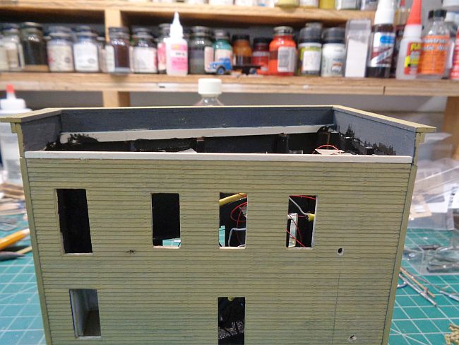

I added a board to the top of the rear wall to reduce the roof slope.
I wanted to add a 6X6 but my stash was low so I used an 8X6 and turned it so the 6" was on the board and not the the 8".
Once the glue was dry, I painted it the same wall color.

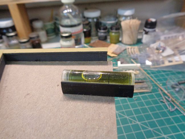

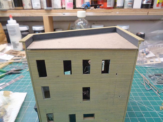

The next photo shows the slope of the roof without the 6" board added to the top of the rear wall.
A full bubble slope.
Now the roof slope is a little less than a quarter bubble.

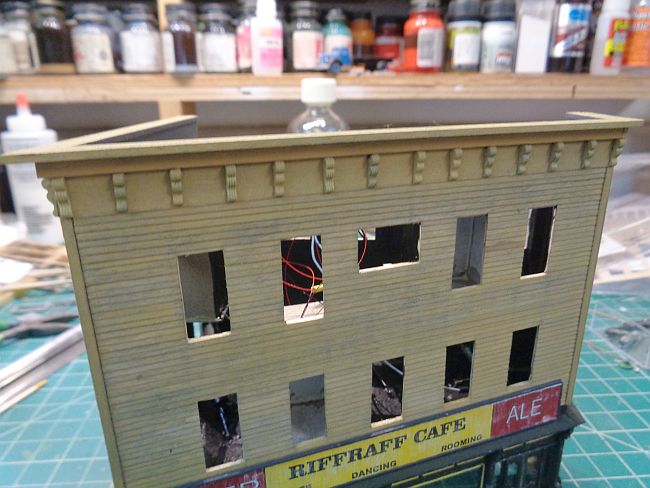

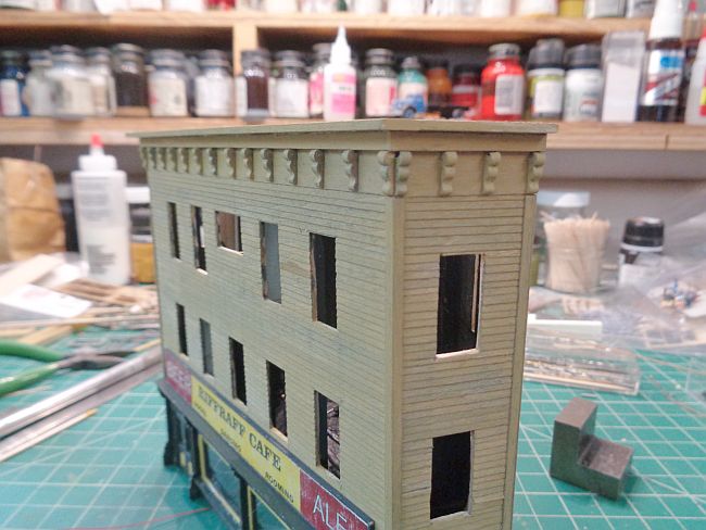

Early this afternoon I installed corbels to the top under the trim boards.
Corbels are usually placed every 24 to 36 inches. I chose to add them every 36 HO scale inches as it looks better. Imagine seeing them every 24 inches on the structure. Prior to gluing them in place, I had them on 24" centers and it didn't look right. No photo of that.
I used Tichy #1801 Double S Corbels for the Flat Iron.
