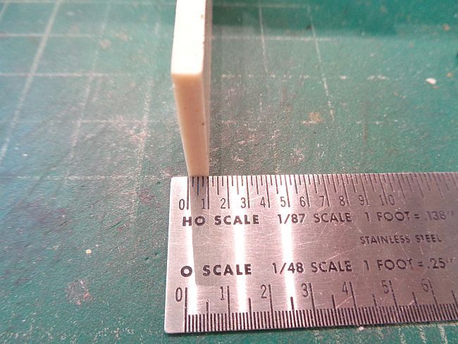

The one problem I have with the Magnuson sidewalks is that they measures just over 13 scale inches high. Now my grandmother going to town to shop won't want to step up 13 inches from the street to the side walk.
I show you later how I got around not using  the sidewalk sections and filled the fronts under the stores.

Tom, to be safe, try the sidewalks first in Super Clean.  If something goes wrong, you're not out a core part.
And it's clear you're expected to raise the street levels to reduce the height of the sidewalks...    ;D

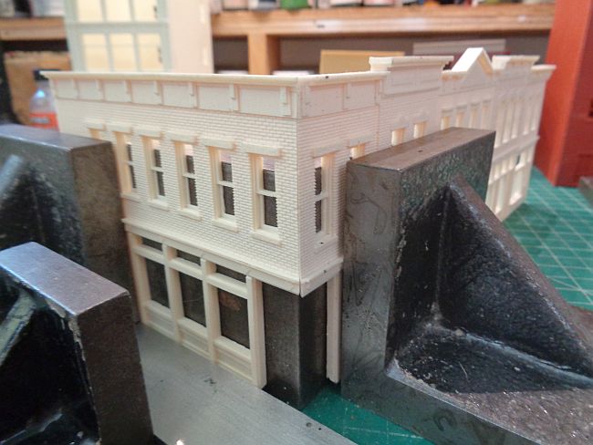

I started with the left corner of the structure when gluing the walls together. This, to me, was the critical corner to get correct at 90 degrees.
The two wall sections have 45 degrees angle cuts on the ends.
I used a large weight with the 90 degree corner of the weight on the inside. I then pushed the two walls together until I had a tight fit. I then carefully added more weights to the outside to hold the walls in place.

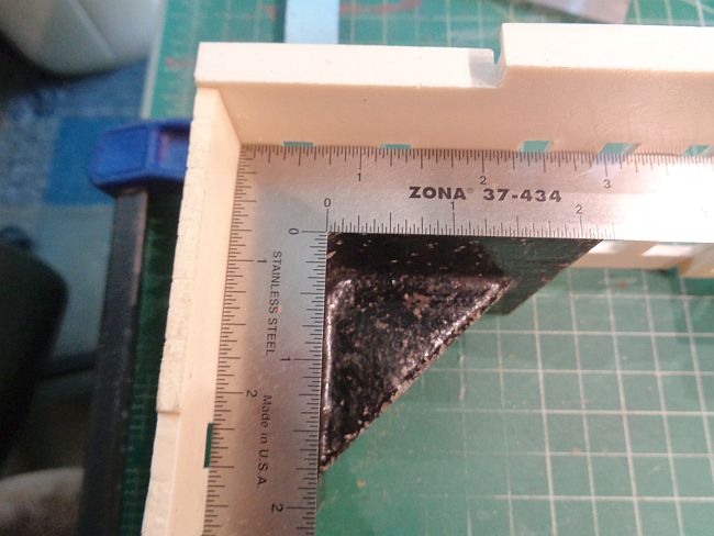

I also used a metal square to make sure it was correct prior to adding the 5 min. epoxy.

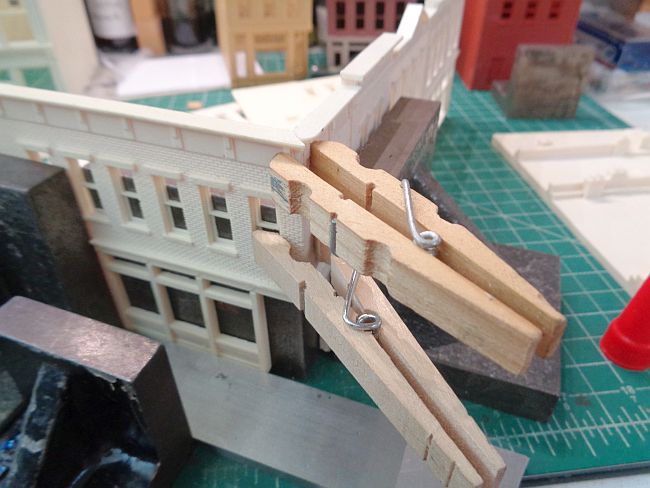

I used clothes pins to hold the upper corners together when the epoxy was applied.

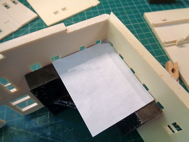

Another trick I've learned over the years when gluing resin walls together, is to use paper where the weight is. When the epoxy is dry, it is much easier to cut the paper off vs. prying the weight off the wall.  This is just in case the epoxy runs down to the weight.8)
Once the epoxy was cured. I removed the weight and paper and added more epoxy to the lower portion of the wall.
I used the same method on the other end wall.

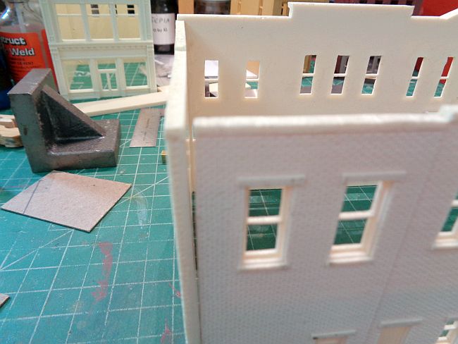

The two end walls were epoxied and then came the rear wall section.
It fit correctly but you can see a slight leaning out on the left and bulging on the right.
Just like bowling, I need to constantly tell myself "bowling is fun" and "model building is fun"!

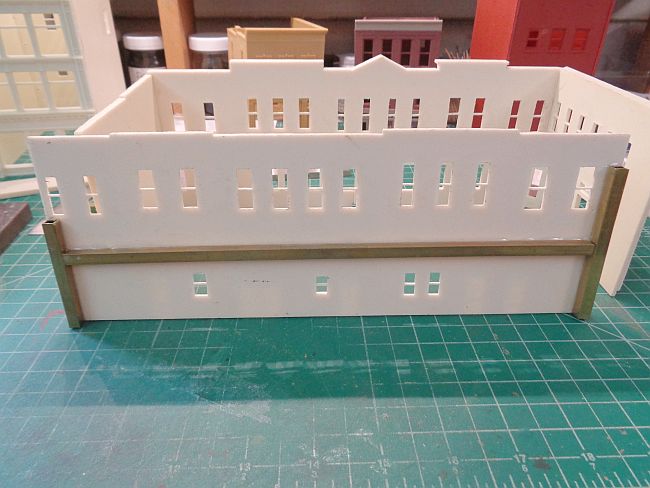

The side edges of both the side wall have very small brick patterns on them. Thinking ahead of the possibility of epoxy oozing out I decided to take a safe approach to gluing the walls.
I epoxied brass stock flush to both rear ends on the back wall. As I was at it I also added a horizontal brass to keep the rear wall straight, just in case.
Stayed low here to avoid blocking the window. However, I could have taken it up all the way and covered the window black from the inside.

I spread the epoxy to the inside edges of the brass stock and pressed the rear wall in place.
I had to use my long Quick Grips to hold the walls while the epoxy set.
Again, the paper protects my cutting pad.
