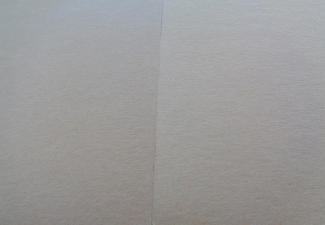

The photo below shows the seam where I joined the two sheets of 2 ply cardboard.

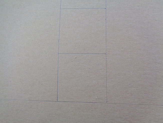

I will use this as a starting point to draw in the roadway for both north and south directions.

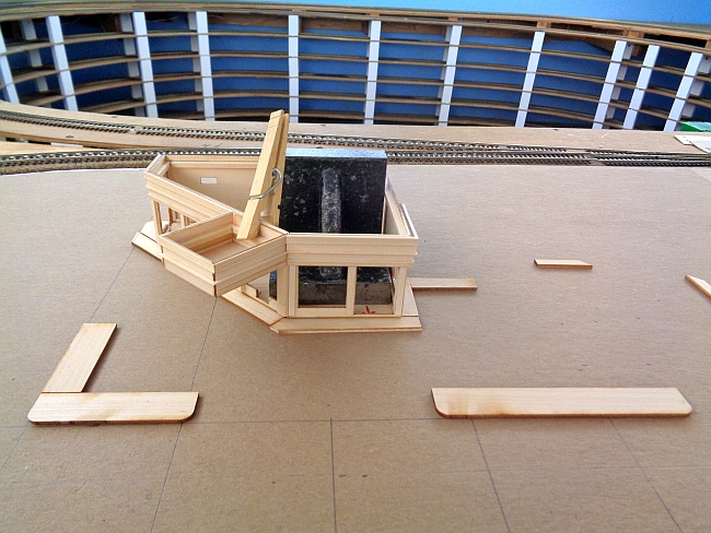

The next two photos show how the buildings are to be placed on the diorama. In my case, the layout.

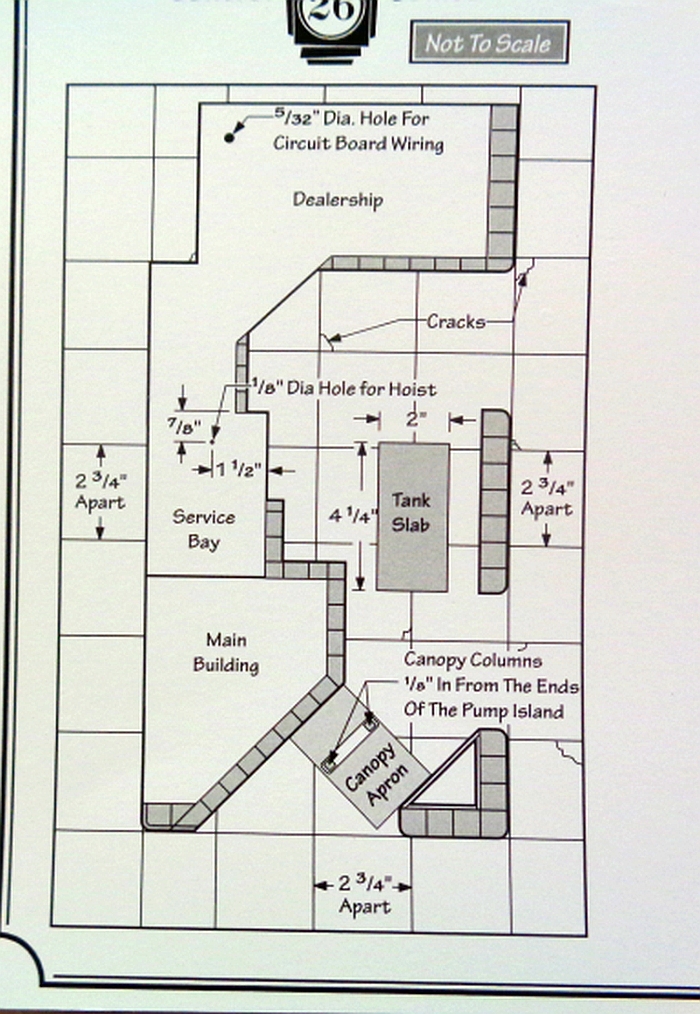

Dario drew his concrete slabs on 2 3/4" squares. This equates to 20ft. squares in HO scale.

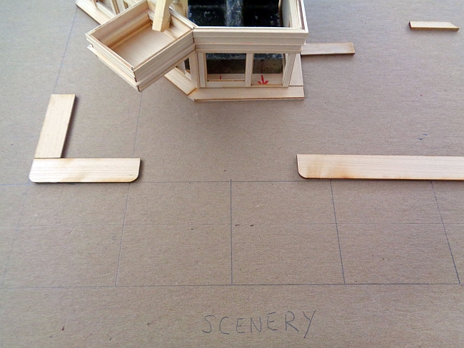

The next photo shows approximately where the service station will be set.
Over all view of the entire kit and approx. where the sidewalks will be placed.
