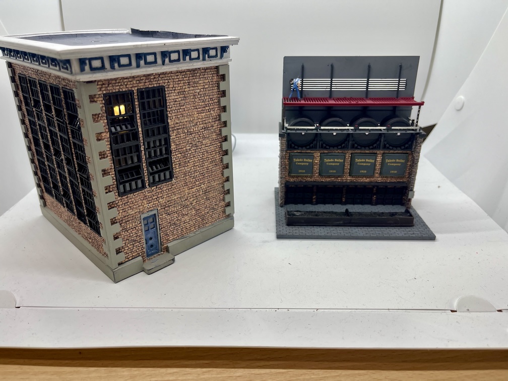

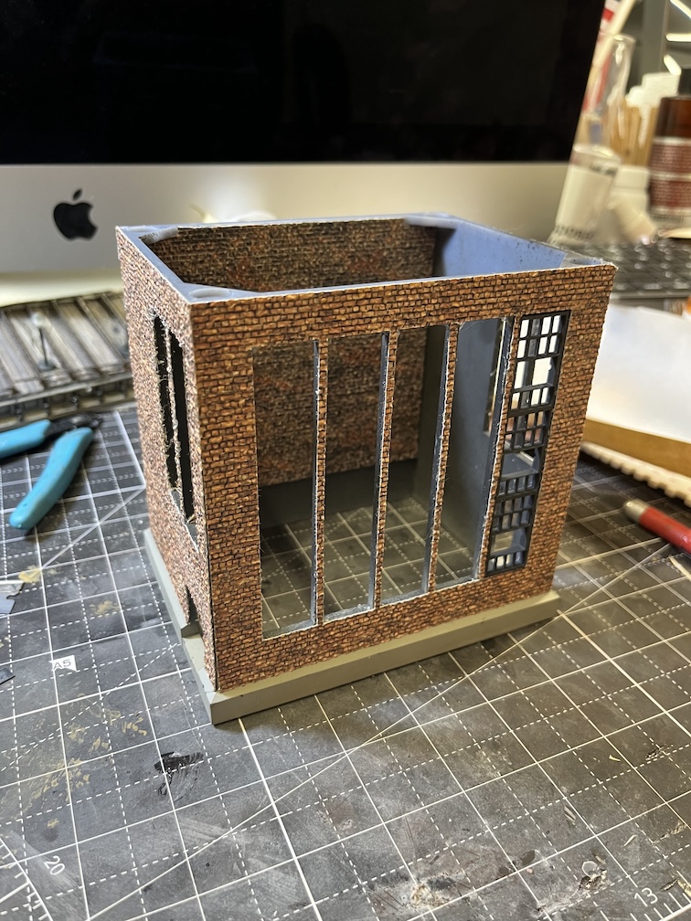

I actually used the 'shell concept when I made the power plant section of Pam's Flour Mill. Using the liquid resin printer to I created the four walls with window and door cut outs as a one piece unit. I then used my laser cutter to cut to shape embossed brick looking paper (got it years ago from a guy in Italy) and using 3M two sided tape attached it to the shell. I 3D printed the roof and made the gingerbread stuff along the roof separately so I could paint them a different color. Finally the interior was all 3D printed assembled boiler room parts. So here it is when it was made:
I was happy with how it came out.

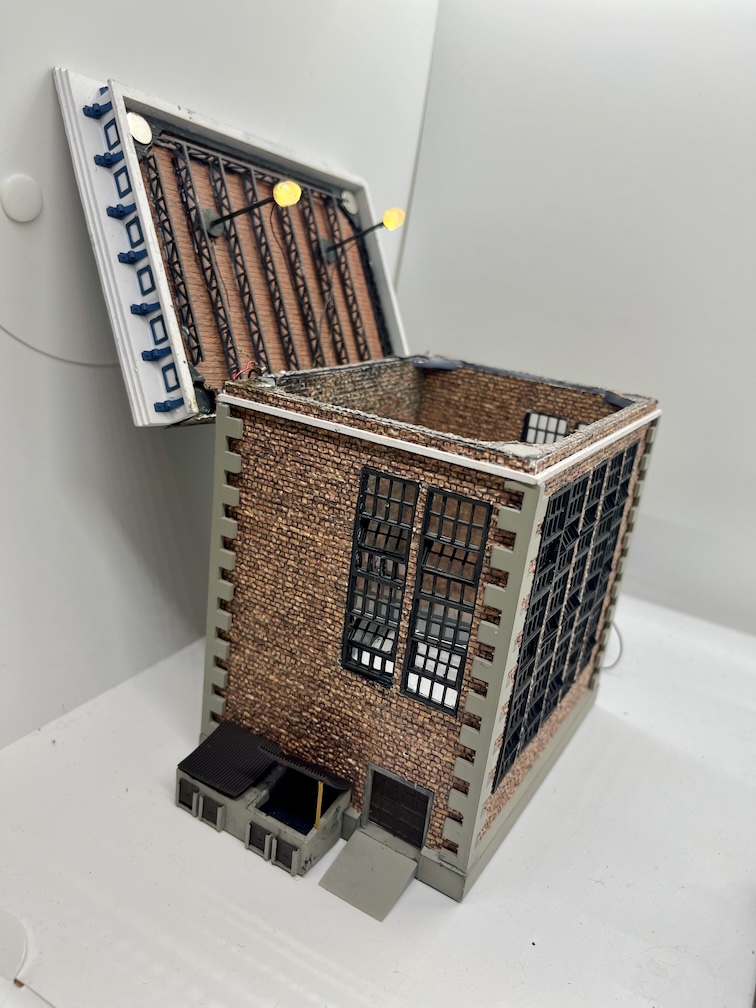

I also found a photo of the power plant 'shell' I made using the large liquid resin printer. I think the 'little' filament printer could of made it but we will see.
