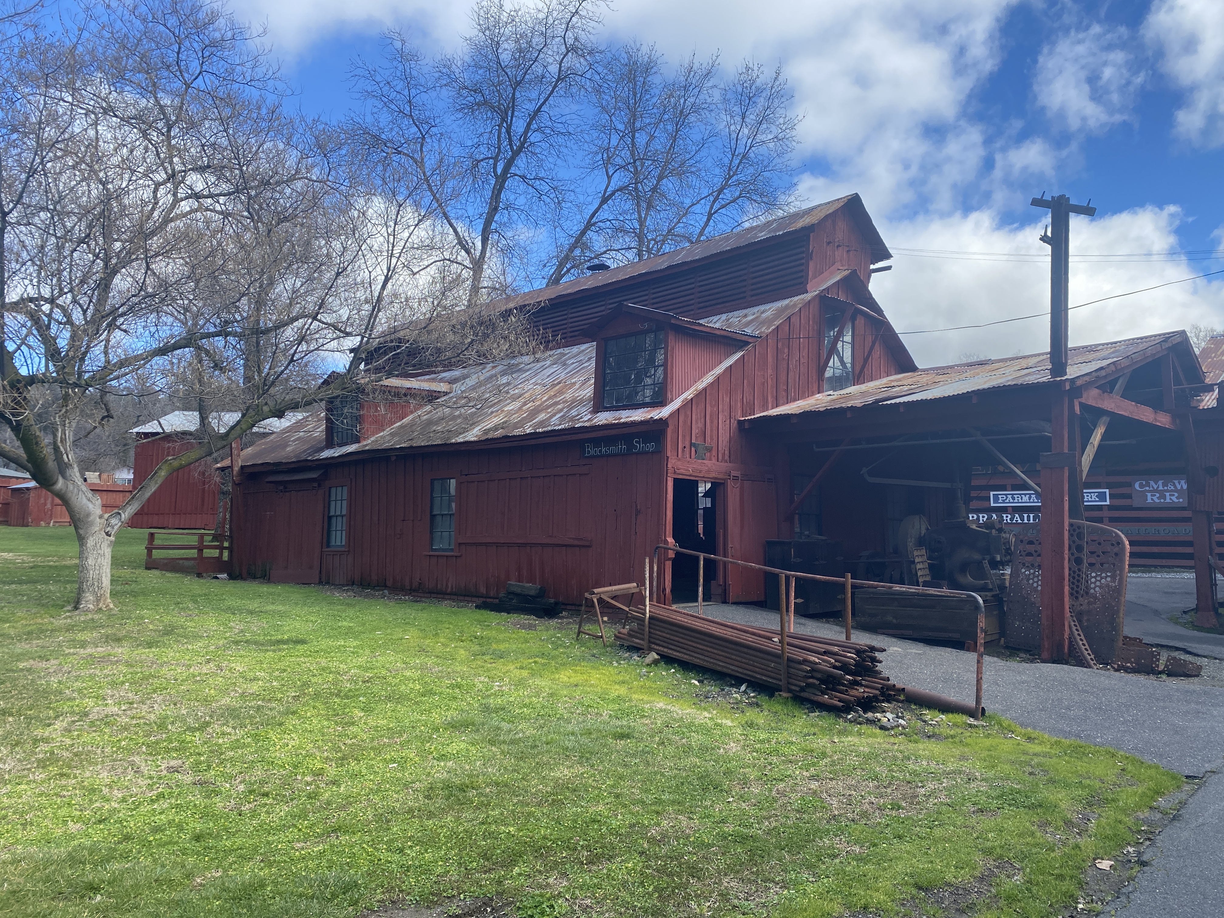

Modern "internet search for what AI feels like showing us" found only this photo, though I'm sure there are thousands on photo sites:
https://www.parks.ca.gov/pages/491/images/Railtown%203-1-23%20(Merritt)%20(23).JPG
The building is at ground level, though there might have been a slightly-sunken loading area on the RH side.  The prototype's big dormers and gable window are clearly there for interior lighting.

Thanks for the photo James. I agree the dormers were for natural light. Was this the prototype Tom Yorke based his kit on?

Of course, the facts supersede opinions.  And yeah, it looks like that Jamestown blacksmith shop was the inspiration.  The dormers there are pretty big, and they're probably 'strategically located' as far as the shop layout is located.  The far one is located directly over a wall window, letting in a lot of light in that part of the building.   Video of that area here, starting at the 8 minute mark.  https://www.youtube.com/watch?v=C3pa0LBQomc

Quote from: Philip on Today at 11:11:00 AMThanks for the photo James. I agree the dormers were for natural light. Was this the prototype Tom Yorke based his kit on?
I just fed what Mr. Yorke put on the cover of the box to Goog. My only visit to the general area was driving from San Jose to Yosemite via Merced.
