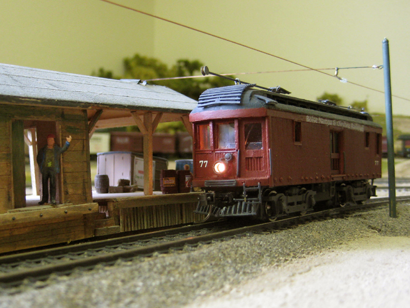

To go in another direction however.......... the effects of nails..... not the holes..... can be rust streaks.  Usually black when staining wood, typically they get a bit wider as they progress down the wall.  More contributing nails and less shelter from eaves.
Below is a photo that I have put up before which shows the idea.
Thanx again for a great thread.
