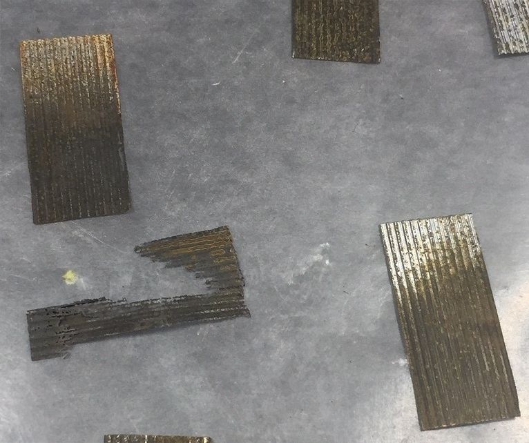

Thanks for the link.  I looked at the photos and followed the process and I understand what needs to be done.  I still need to know what you used as the etchant.  Do you purchase as is or is it something you mix up yourself and if so, what is the recipe?
Thanks for all your help.
martin.ojaste
I got mine locally here (http://www.sayal.com/STORE/View_SPEC.asp?SKU=70106).
It's a Printed Circuit board copper etchant. It is Ferric Chloride solution. Used to be available at RadioShack, but I don't know if they still exist.
Marty

Quote from: nextceo on March 29, 2015, 11:36:26 PM
After having a chance to talk with Ken Karns and Joel Freedman at this weekends Expo, I decided to take a run at using Etchant to weather my roofing panels.
Here are the steps I followed:
Put on Rubber Gloves and Shop glasses. I did this process in my basement.
<snip>
Nice work Alan! Good seeing you and everyone else at the Expo.
Etched corrugated panels make for some neat fences too.
Just wanted to add that someone new to this might want to start with one or two panels to get the hang of it before doing more panels at a time. I used a small shallow tray when doing mine and it didn't hold a large amount of etchant. The panels would sit for a while and then suddenly start sizzling away. The reaction really goes to town once the shiny coating gets eaten through. As more panels get treated, the etchant starts to get "tired" and it takes a little longer for the sizzling to occur - and the sizzling slows down a bit too. I notice this after about the third batch I think. Again, it was a small shallow tray. If you're working with a bigger amount of solution it would probably stay potent longer.
-slim

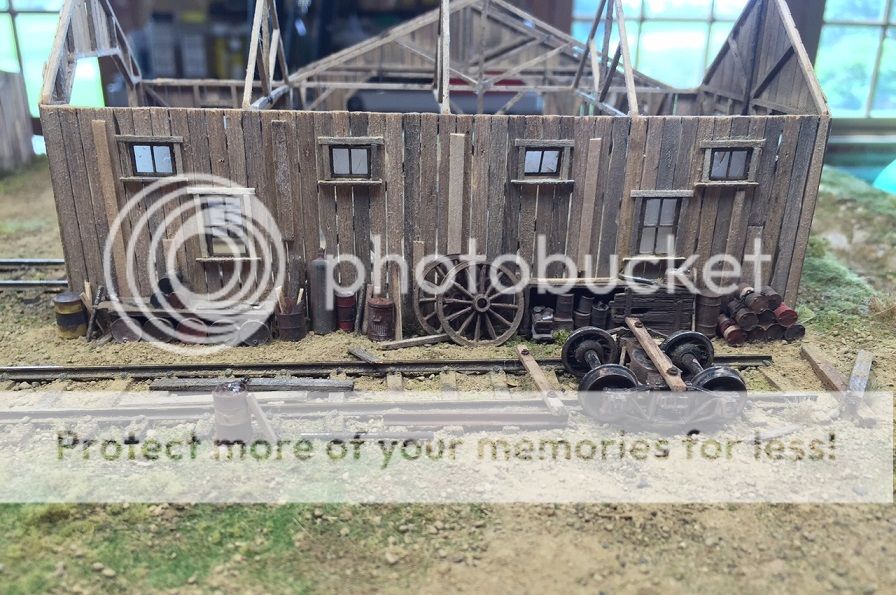

Figured since its been a while, I'd post an update of my build. Since my last post, I added lights to the Main Building, hand laid the track with spikes from Fast Tracks and added some scenery. Next step is to start detailing the outside of the Main Building...
Alan

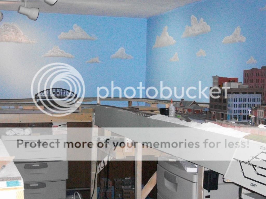

Alan,  I been working on this corner of my layout. going to add large city buildings. with track going under the city.
  Sam
