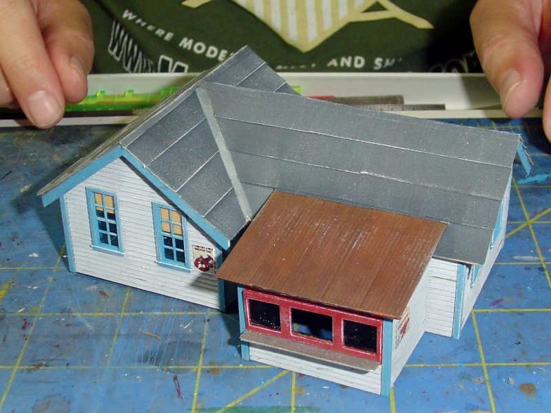

The roof cards include one that's notched to fit the configuration I chose.  But, when the notch is centered over the building extension the overhang on each end of the roof differs.  No problem.  Too long is easy to correct.   :D  Too short not so much.  But these were too long so I trimmed it so that the overhang on each end was a scale 18".  I cut the card that goes on the other side to the same length.
I decided it would be easier to position the roof cards that go on the extension if there was a truss (?) to support it on the blind wall so I cobbled one together that matched the peak of the end wall.
I found that the angled end (black) of the roof cards didn't mate well with the roof that was already in place.  I cut two new cards with an angle (green) that allowed them to butt up against the roof for a relatively tight fit.
Here's the extension roof in place.  The seam will be covered later when the roofing material is applied.

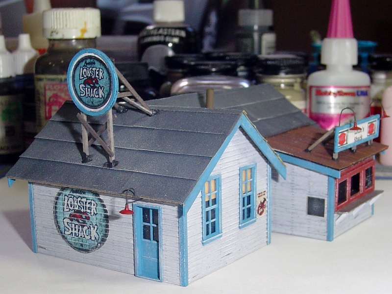

Thanks Karl!  Time to finish this one up.  Actually it's been finished but I've been delinquent about keeping up with the thread.  I have to skip over the part where I added the rolled roofing material because I took all the pictures without the memory stick being in the camera.   :-[  I have the camera on the back of my work bench facing my work and I reach around it to set the time delay function and press the shutter button so I never see the screen that tells me the memory stick wasn't in the camera.  D'uh!
One thing I will point out about the roofing is I used some very fine grit wet/dry sandpaper cut into scale 3' strips as the roofing material and applied it with 3M Transfer Tape.  I also wanted to experiment with a adding some leading flashing like Martin Ojaste demonstrated in his Campbell Grandma's House thread (Thanks for the tip Martin!).  I decided to use the roofing material that was included in the kit to make the lead flashing and rather than spray it with Oily Black I brush painted it.  Then I hit with some white chalk followed by Dullcoat.  I thought it came out looking like a pretty good representation of lead flashing.   :D
The only problem I had with the lead flashing that I made was that the roofing material included in the kit through me for a loop.  I had painted the non-lined side of the sheet.  You can see in the picture where one side has lines on it to use as a guide when cutting it into strips and is scored to make it easy to peel away from the backing.  Well, most kits I've built in the past have you paint the side with out the lines, flip it over and cut along the lines.  Also the scored side to assist in easily peeling the sticky side from the non sticky side is usually the non sticky side.  Not in this case.  The lined/scored side is the side that has the sticky backing.  Double check what you get in the kit prior to painting it to make sure you paint the correct side.  No big deal for me, I was still able to add the lead flashing to the roof.
I'm guessing a roof covered with roofing paper like this wouldn't have exposed lead flashing like I added but I wanted to see what it looked like.
The roofs have been covered and dry brushed with an off white.

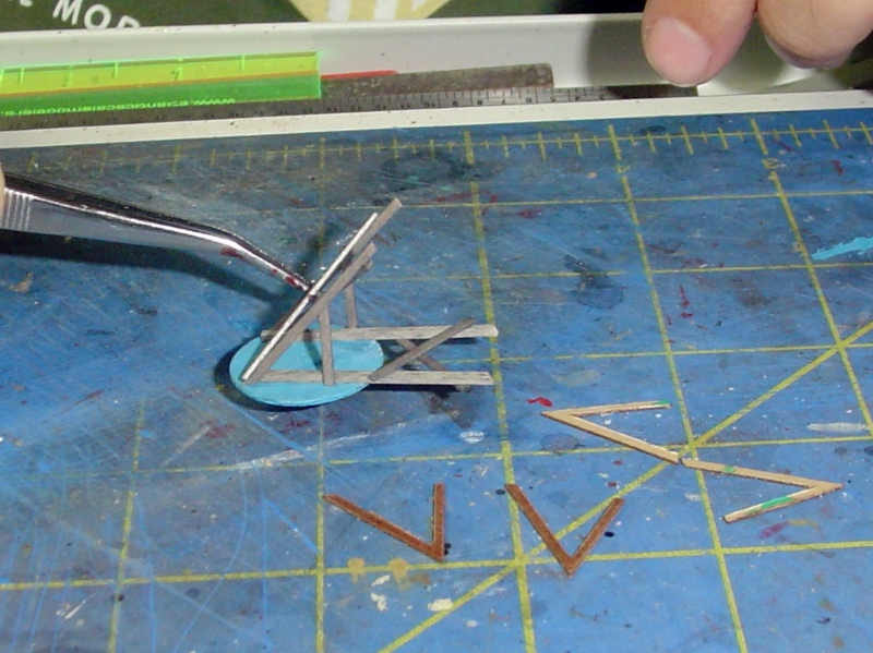

Okay, on to the roof top signs.  I didn't want to use the laser cut supports for the big sign that goes on the roof so I cobbled something together out of strip wood.  There's nothing wrong with the laser cut parts other than they do have a 'sticky' side to them that isn't necessary.  It could be painted over or scraped off and painted over.

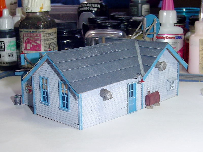

Okay, time for some pictures of the finished structure...
And a couple more in a moment...
That's it.  A fun little kit that can be build in a variety of configurations and for a multitude of uses.  This one has found it's way to the Atlantic and Southern and may find a home there someday.   :D

martin.ojaste
Bob, the structure llooks really good. The lead flashing is spot on. The signs and colouring all blend nicely. I would suggest a very light application of black chalk with a 000 brush along the edges of the roofing, this will give the steams that extra definition.
Marty
Quote from: martin.ojaste on May 20, 2015, 08:16:36 AM
Marty
Thanks Marty!  Another great tip.  I'll have to give that a try.   :D
