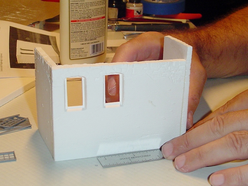

Time to glue the walls together.  This structure has an odd shape to it so I started with the walls that need to be at a 90 degree angle to one another.  I glued them together using Titebond Wood Glue and held them in place until the glue set enough to hold them on it's own.  If you opt to clamp them don't over do it or you may be testing the replacement policy.   ;)
More gluing and holding...
After the walls are together you can fill in any gaps in the joints using spackle.  A strip of painters tape on both sides of the gap will prevent the spackling from filling in the nearby details carved into the walls.
