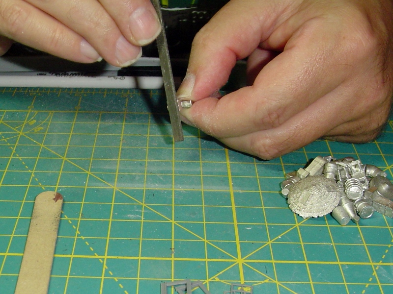

I used a small file to clean up the metal castings included in the kit.  The quality of the castings was pretty good so the cleanup was minimal.

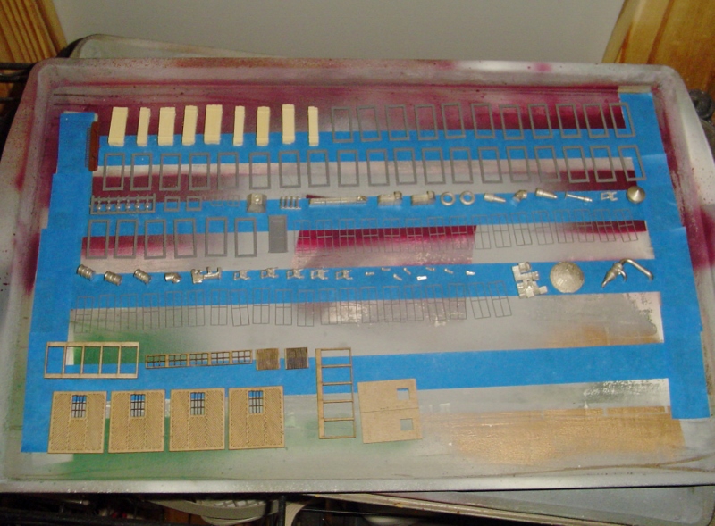

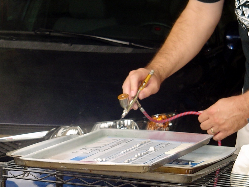

After I cleaned up the plastic, resin and metal castings I went through the laser cut components and cut out and cleaned up anything I wanted to paint the door and trim colors.  I took all of this and attached it to trays I use for painting using strips of blue painters tape that are taped sticky side up to the tray.  When I airbrush these I don't want the spray from the airbrush to blow them around.

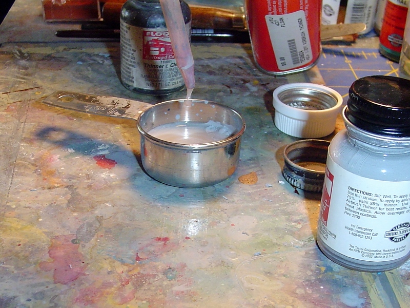

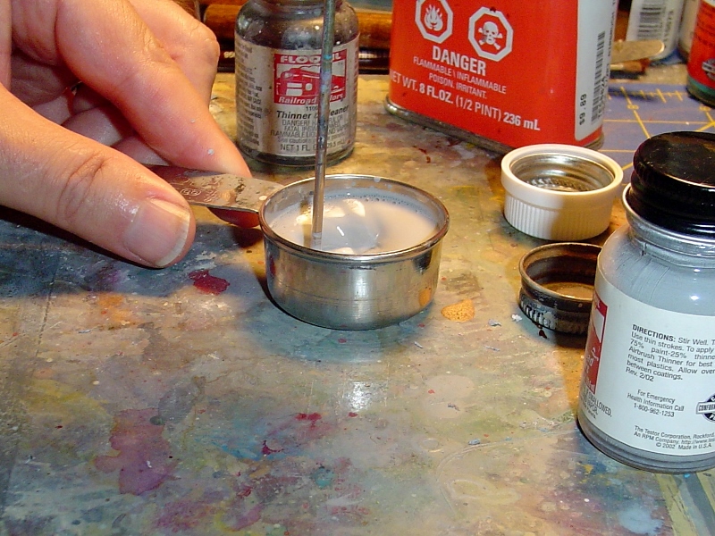

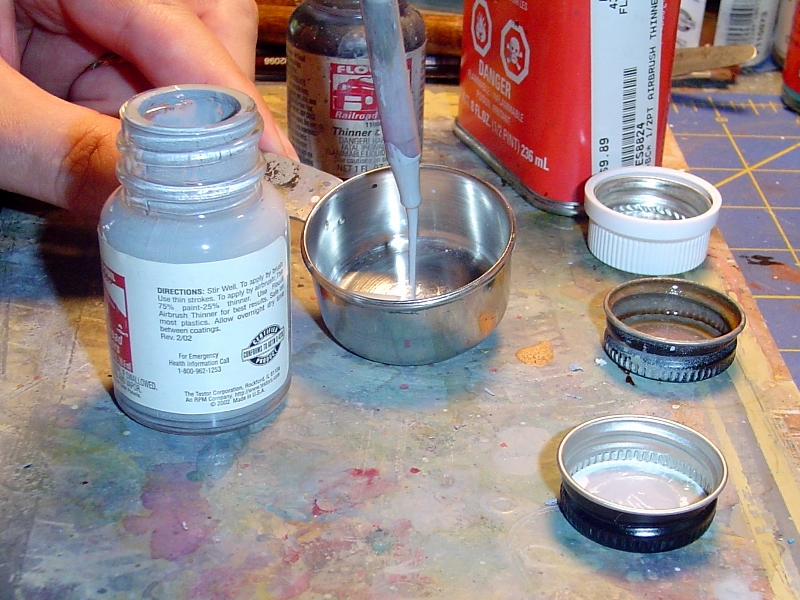

I took one of my few remaining bottles of Floquil Primer  :'( and, after thoroughly mixing the paint, unloaded nine eyedroppers full of paint into a metal mixing cup (okay, it's a measuring cup from the grocery store).
To that I added three eyedroppers full of thinner.  That gave the a 75% paint to 25% thinner mixture which works well in my airbrush.
I mixed it up paint/thinner with my little electric paint mixer making sure to let the mixer come to  STOP before removing it from the paint.  You can easily envision what would happen if you didn't.   ;D

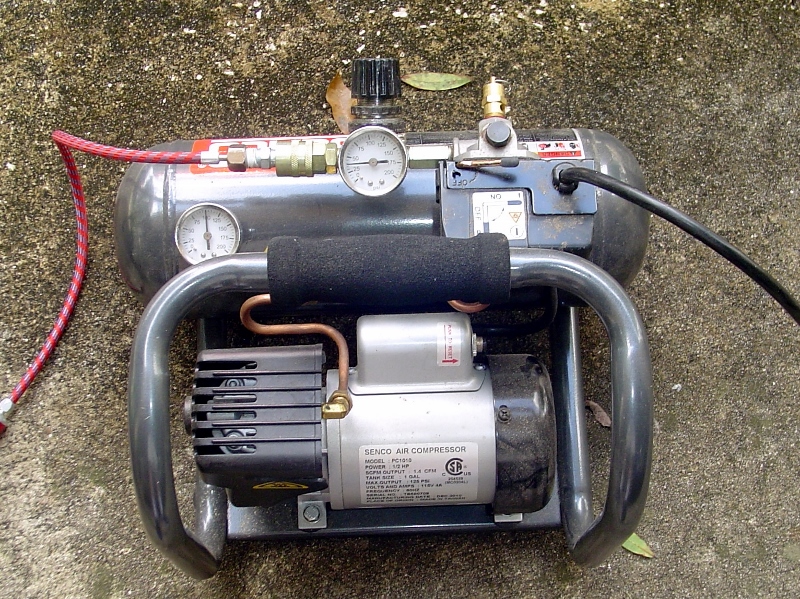

I use a cheap home air compressor I bought on Amazon.  It's also handy for pumping up the tires in the vehicles and assorted other odds and ends.  It's cheaper than some of the more expensive hobby compressors and, since I do my painting outside, I don't really need the whisper quiet kind that shut off when you're not painting.  This one does the trick for me.
More in a few moments.   :D

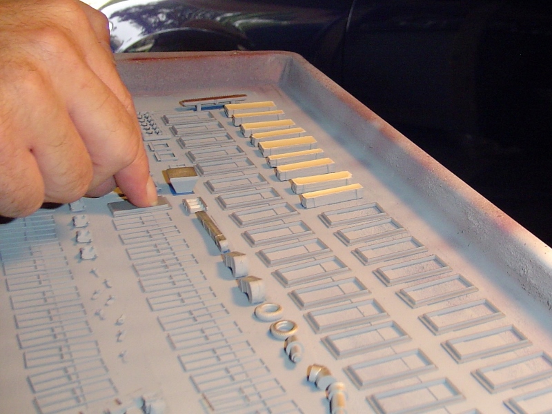

I'm painting out in the driveway, just outside my garage.  I start by giving everything a coat, painting right to left and making sure I get all the 'bottom' edges.  I don't worry about getting complete coverage of everything at this point although I try to get a nice thin coat on everything.
I rotate the tray 90 degrees and again paint everything from right to left making sure I get the bottom edge (which was previously the left hand edge of the pieces prior to rotating the tray.
I rotate the tray and paint two more times to make sure all the edges get painted.  Afterwards I wait until the paint is dry enough to allow me to flip over the parts that and paint the bottom side.  The only parts I didn't flip over are those that are from the peel and stick sheets since the bottom of those is the part that gets peeled away and tossed.

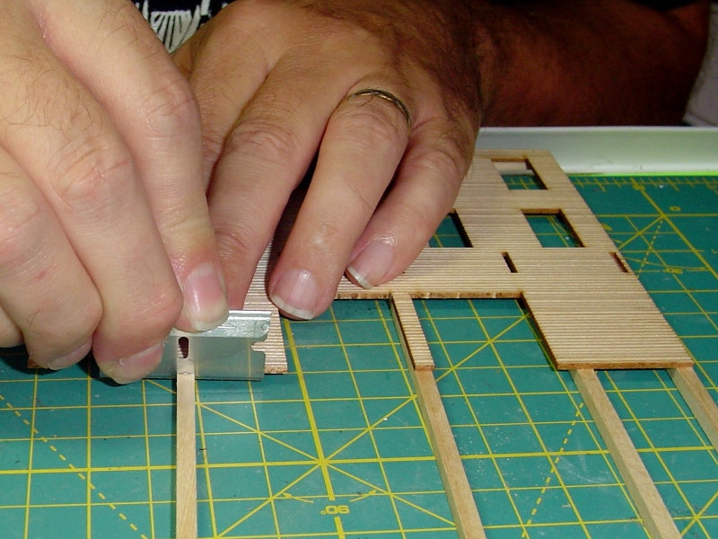

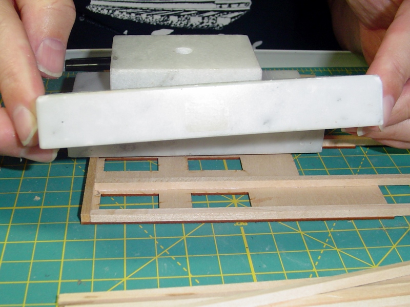

I applied the bracing material per the instructions and weighed them down under some marble blocks (salvaged from old bowling trophies).  The bracing material wasn't cut to length at this point. It overhangs the walls.
One thing I should have done differently on the bracing - On the top of each wall the instructions show to run a piece horizontally and the vertical pieces run up and butt into that.  In the future I plan on running the vertical pieces from the bottom all the way to the top and then fitting the horizontal piece between them.  Doing it the way the instructions show was faster but it allowed the walls to warp ever so slightly where the vertical braces but up against the horizontal piece.  No biggie but it wouldn't have happened at all if I had done it the other way.
After the glue had set I removed the weights and trimmed the bracing to length using a single edge razor blade.
