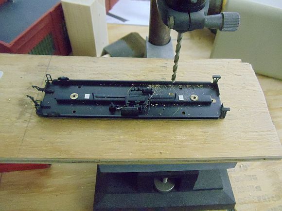

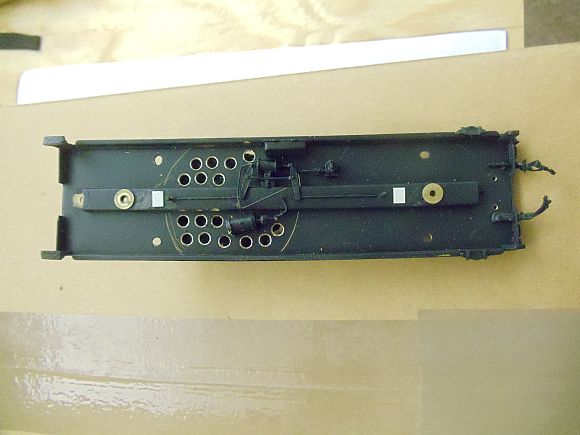

After marking the tender for the speaker I started drilling holes in the bottom of the tender deck. I used a small drill bit for this purpose; however you can drill larger or smaller holes if desired.
NOTE: Be sure you use a new or sharp drill for this as a dull one will cause the brass to heat up and you may run the risk of softening the already soldered parts. This has happened to me once so this is experience talking.
In the photo above you can see the tender deck is just laying there. During the drilling process I hold the tender deck secure with my left hand as I operated the Dremel Drill Press. Also for the drilling, I use the powered Dremel tool and not the cordless. Obviously the powered Dremel is more powerful.
When the holes are drilled, you can go over the holes with a slightly larger drill to "ream" the opening and de-burr the original holes.

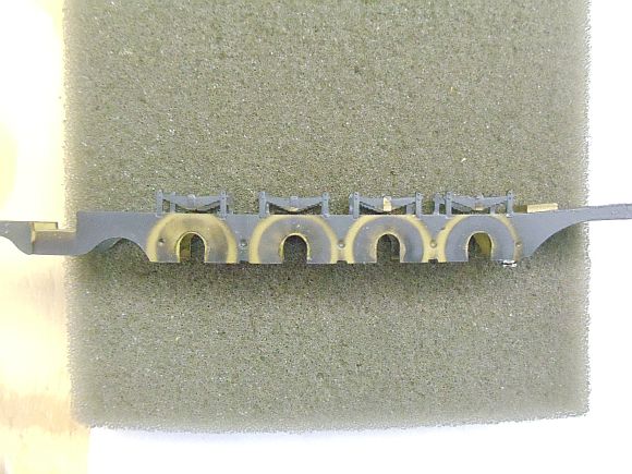

Frank isn't the original owner of this brass loco but I want to point out to ya'll the difference between a custom painter and a professional custom painter. Look at the following photo.
Notice the pattern of the wheels/drivers on the side of the loco main frame? The previous painter of the loco didn't remove the drivers, side rods, cranks, etc and etc prior to stripping and painting. The loco was painted with all the parts still on the frame.
This is non-professional in my opinion and possibility the result of a couple of things.
1. The painter didn't have the knowledge or confidence to remove the running gear prior to painting.
And last but not the least -
2. Just pure laziness, plain and simple.
I've only painted one brass loco in this manner and that was at the request of the owner/customer and certainly after my objections. I've painted 358 brass locos over the past 40 years and Frank's loco will make 359.

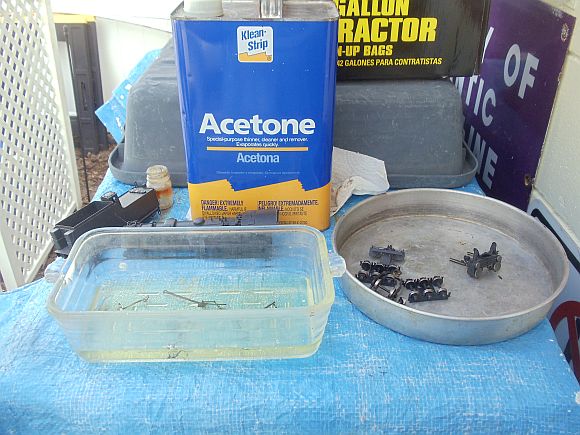

Now comes the time to strip the old paint off the loco. I use a product called Acetone. It is one of the same chemical compounds in your wife's nail polish remover.
NOTE: Acetone is nasty stuff, very nasty stuff. Be sure you use eye protection and industrial rubber gloves to protect your skin.
I've found that I can use the yellow gloves from the grocery store. These are the gloves worn while washing dishes.
However, I have to work fast as the gloves start to degrade after about 15 minutes.
Your hands won't fall off if exposed to the Acetone but the chemical can be absorbed and it's not as good as your God given blood.
There, I've done my part in warning ya'll to be careful.

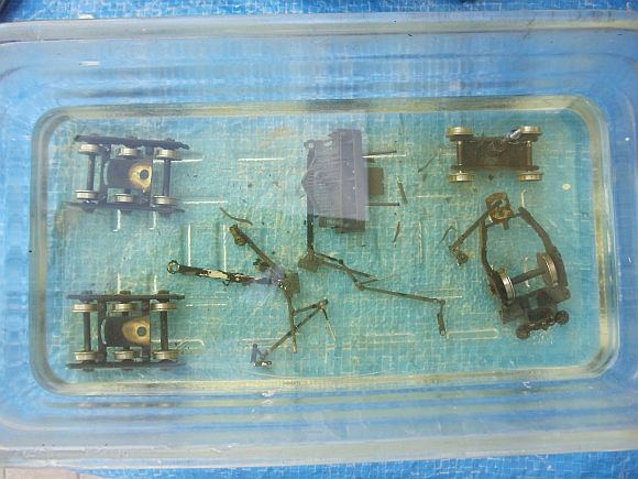

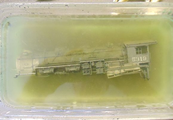

I have an old glass Pyrex bread bowl to soak the brass in the Acetone. I start with the small parts and work my way up to the tender and boiler.

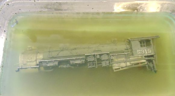

In the next couple of photos you can see the loco boiler soaking in the Acetone.
The first photo is after the loco soaked for just three minutes.
Three minutes later I hope you can see or tell the Acetone is doing it part. It doesn't take long for the Acetone to "eat" the old paint.

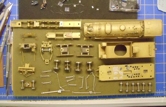

After the brass has been stripped of the old paint, I take it to the laundry sink and wash all the parts with warm soapy water and set aside to dry. You can also bake them dry in the oven. I'll cover the baking process in the other thread.
Fast forward and the brass has been stripped, washed in warm soapy water and dried. The loco and parts are now ready to be pained.
