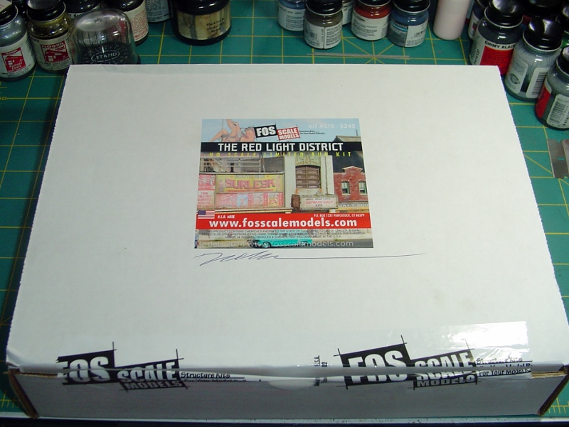

The kit includes 9 business in 7 connected structures.  Here's the obligatory shot of the box the kit came in (it's a pretty big box).

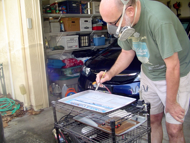

I attached everything I wanted to prime at this point to an old jelly roll pan I use for airbrushing.  I tape down strips of blue painters tape, sticky side up, to hold the parts.  The raised edges help prevent anything that comes loose from the tape from rolling off the pan.
I found a fresh bottle of Floquil Primer (my last one I think  :'( ) and mixed it up very well with my paint stirrer (stirred, not shaken).
Being that it was previously unopened and in good condition I didn't bother to strain it before using it.  I put full eye droppers of paint in a stainless steel measuring cup.  For every three full eye droppers of paint I added on full eye dropper of thinner.  I then mixed that up and loaded the cup in my airbrush.
I paint out in my driveway (you can't get much more well ventilated then that) and still use a mask (sometimes  ::) ).  I paint going across the tray and I try to get a decent coat of paint on everything but not a complete coat on the first pass.
I then rotate the tray 90 degrees and repeat the process.
I rotate the tray another 90 degrees and repeat the process twice more.  This helps ensure that all the edges got painted.
