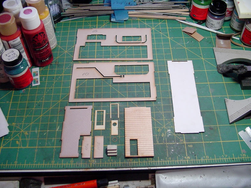

This is small structure and a relatively quick build.  It'll get sandwiched in between the much larger Triple Theater and the Hotel structures.  Here are the parts necessary to build the Peep O' Rama.
I started by bracing the rear wall and then finishing it with stains, paint (Reefer White) and dry sponging some gray onto it.

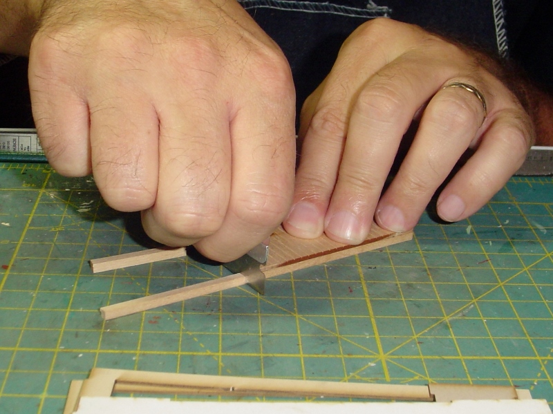

Like usual I glued the bracing on first and then trimmed it to fit using a single edge razor blade.

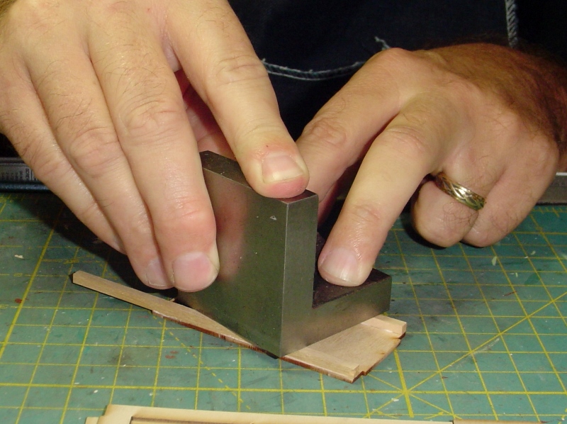

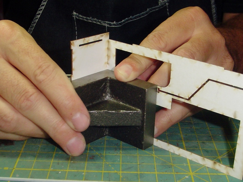

There's no bracing on the front and side walls.  I glued the front wall to the side wall and kept it square while the glue set up.
I did the same for the other side wall and, while the glue set up I added corner trim to the rear wall.

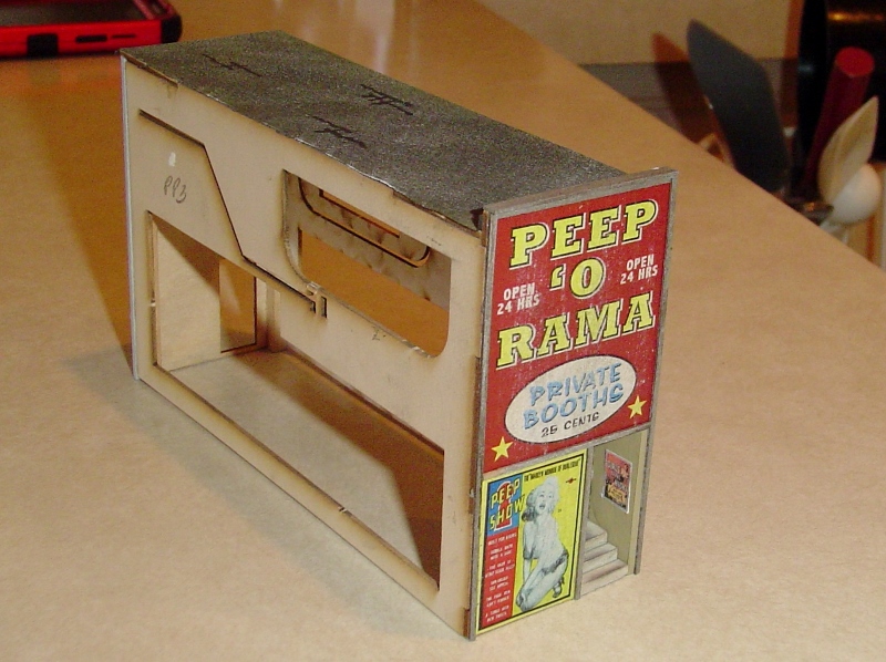

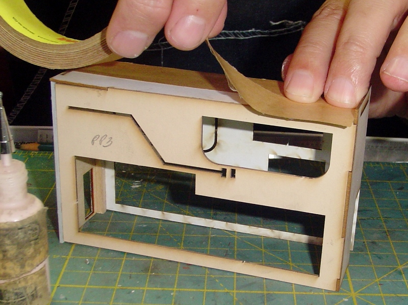

After attaching the rear wall and the roof I covered the roof with 3M Transfer Tape.
More in a moment... :)

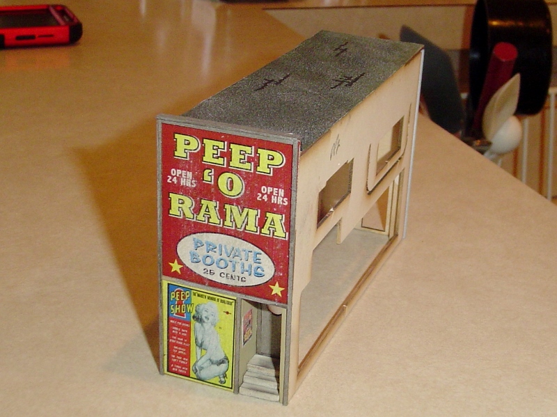

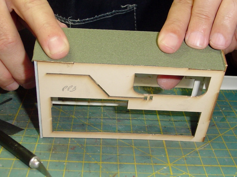

I used a green roofing paper (Stoney Creek) that I purchased at the EXPO in Scranton for this structure.  I applied it and trimmed it to fit.  Later on I applied some weather powders, sprayed it with dullcoat, drybrushed it (very lightly) with a white and then added a few 'patches' using Gallery Glass Liquid Leading.

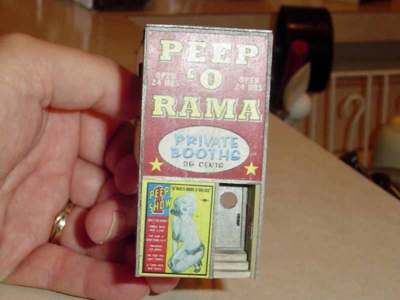

The front of the structure is really simple, some paper signs applied with 3M transfer Tape and then bordered by 2x4 strip wood painted Silver and dulled with Model Masters Black Detail Wash.  The stairs I had build early on when I painted all the sidewalks.  The entry way door was also painted silver like the trim for the signs.
There's a large sign that goes on the roof but, because it also partially sits on the roof of the Hotel, I'm not going to build it until later on.
I'm not going to worry about light leaks with the side walls.  The only window is in the door and I don't think I'll bother lighting this structure up.  Seems like it might be pretty dimly lit inside anyway.   ;)
