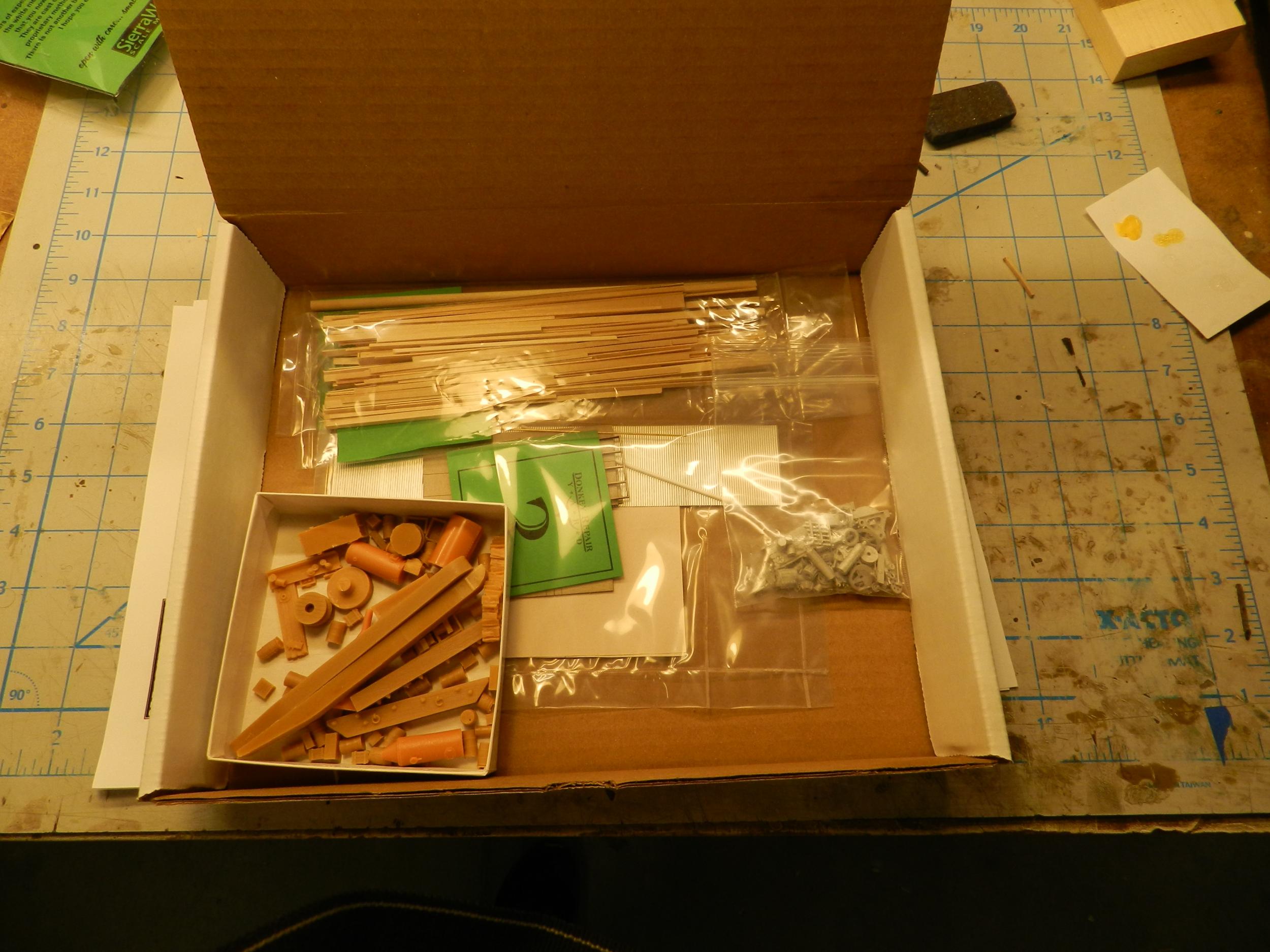

Started building another Sierra West kit, the Donkey Repair Yard, for the sawmill area on my layout
Makeup of the kit

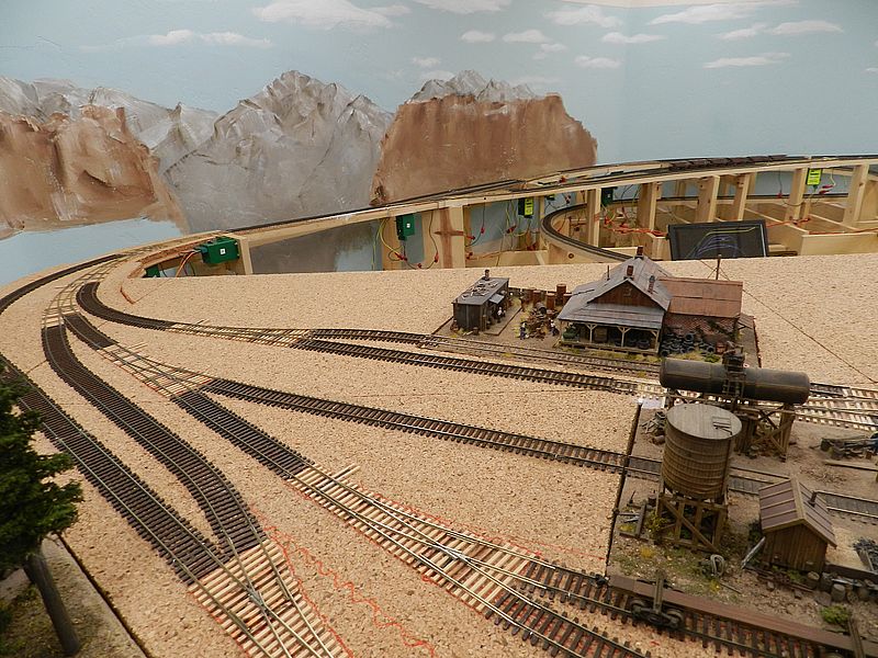

The Donkey Repair Yard will go here

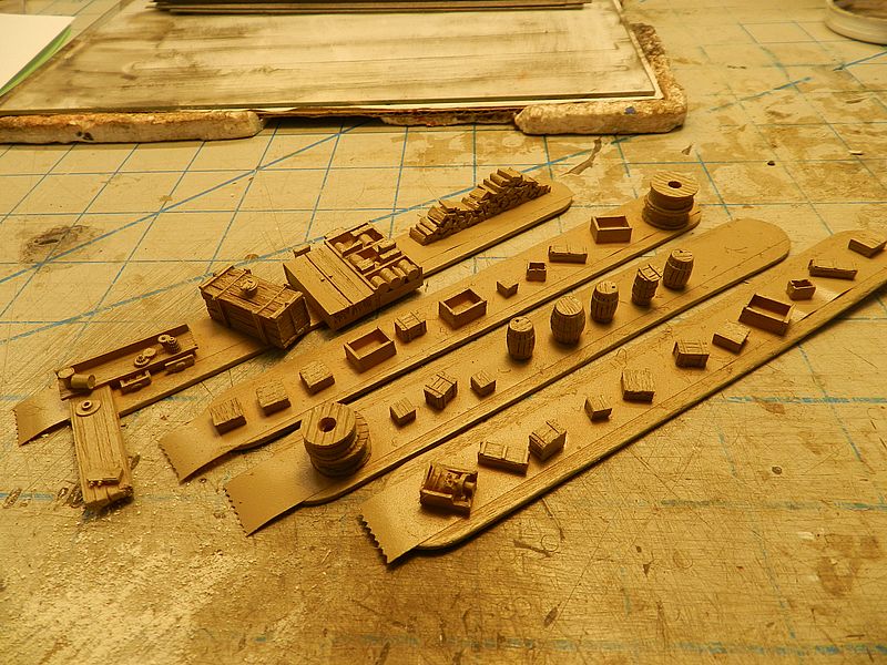

Resin Castings prepared for painting by using double sided tape and tongue depressors. They are primed with a tan Krylon paint before various acrylic paints are applied.

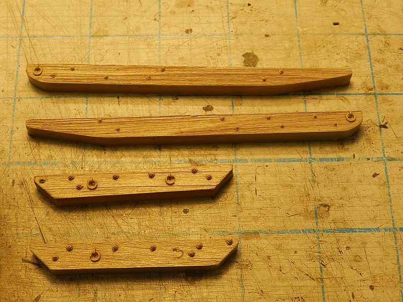

Timbers for Donkey Sleds

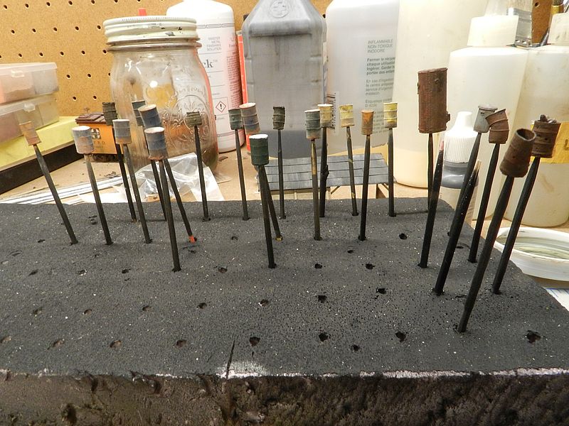

Barrels etc are prepared by drilling a hole in its base, sticking a tooth pick in it and into a foam base, primed and then painted with acrylic paints.

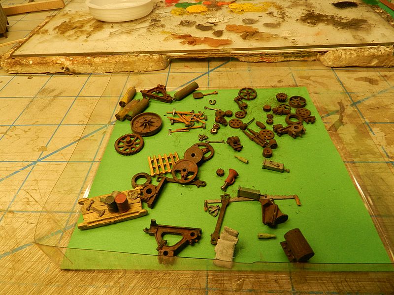

Various metal castings were dipped in Jax and then painted with acrylic paints.

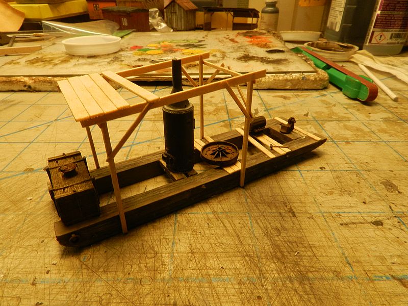

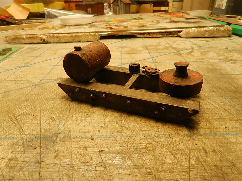

Donkey under repair.
Another Donkey under repair.

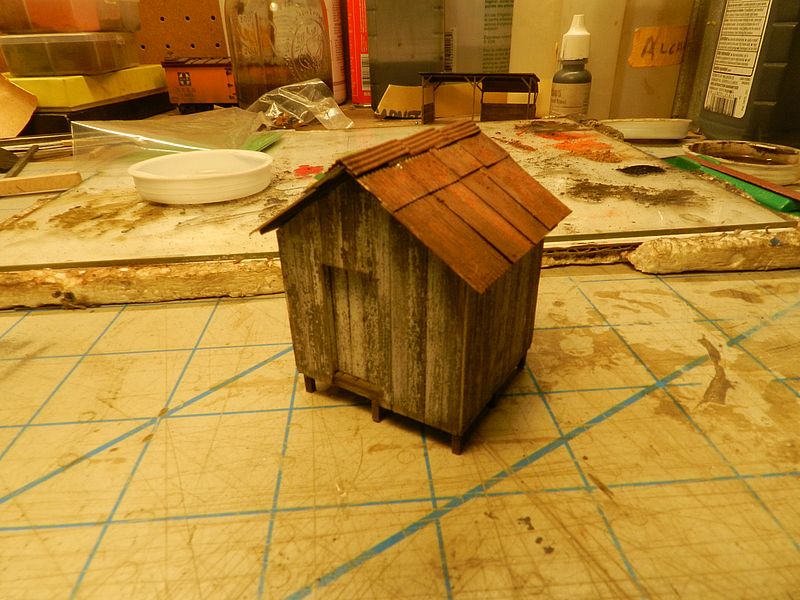

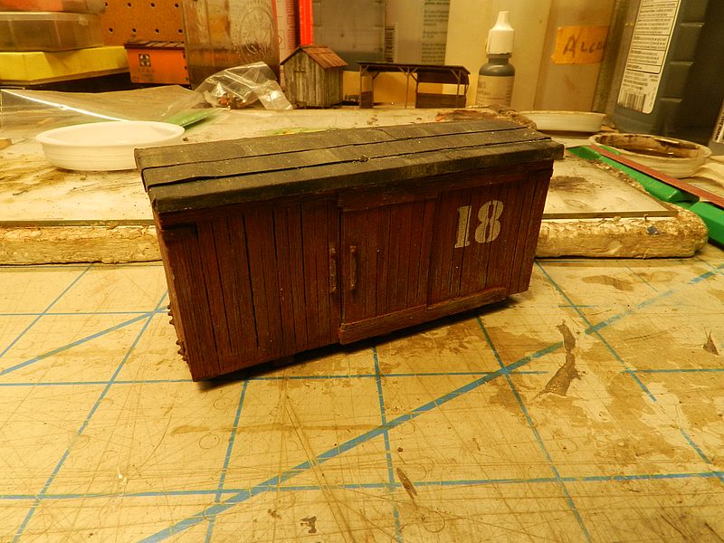

A Box Car used for a storage shed.  The car is a resin casting, it was primed with a grey paint, thena grey powder pastel was brushed onto the surface, then an acrylic red paint was applied.  Once dry, a wire brush was used to scratch the surface to expose the grey.

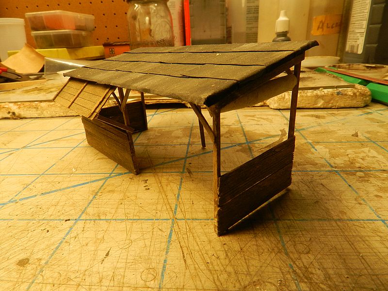

A storage shed with board on board construction
An open storage shed
These will be assembeld on a piece of gatorboard to form the diorama and place in the cork cutout on the layout
