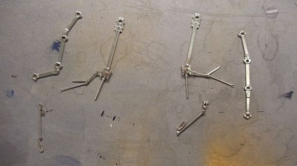

Prior to putting the side rods and eccentric crank back on the loco, I decided to change the look of these pieces. I wanted them to look more like polish steel rather than the chrome finish. Below is a photo of the parts I'm referring to.
I sprayed them with full strength Scalecoat Flat Finish and let dry.
In the photo below you can see the difference on the main side rod on the top. This one has been sprayed with the flat finish. The one on the bottom shows the chrome finish on the back.
Here is how they look on the locomotive.

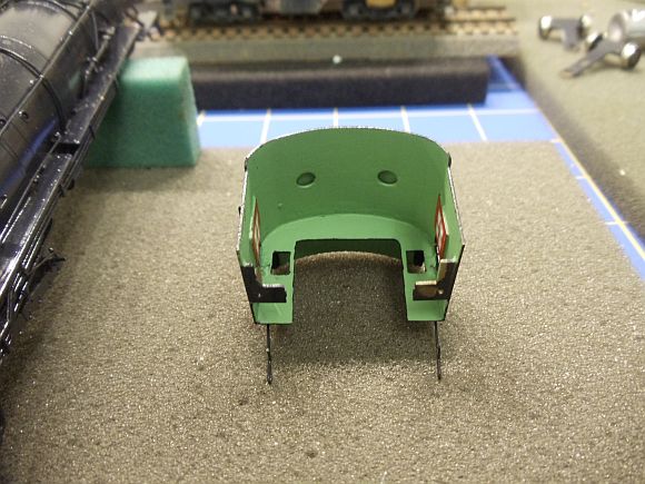

I mentioned earlier in the post that this version of the PFM USRA 2-8-2 came with a separate back head and detail. I painted the details and reattached it to the rear of the firebox.
I'm assuming everyone noticed the green front cab wall. Since the cab also comes off this model, painted the insiode of the cab a light green. I mixed a little Floquil Reading Green and Floquil Reefer White.
I painted the inside window trim of the cab red to match the red on the outside of the windows. I used Floquil Signal Red for the windows.
Preiser Engineer and Fireman were added next. The cab roof was then installed.

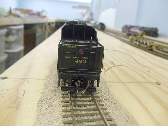

Fast forward and this one is finished. Well, almost! It still needs the DCC decoder installed, coal load, front marker jewels and very light weathering. It is decaled for the Seaboard Air Line RR and is a freight locomotive. The decals are Champ decals. Champ has been closed for several years now.
This loco will also be used on the Ovalix as a pusher so I installed a red MV Lens Products #L117 in the rear light socket.
The reason I painted the interior cab green, is because I also installed a cab light.
Here's a view of the cab interior and light without the tender in tow. Notice my cab tarp rolled up at the top.
